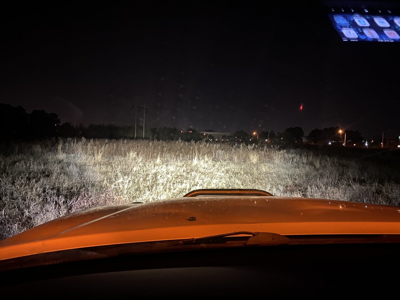

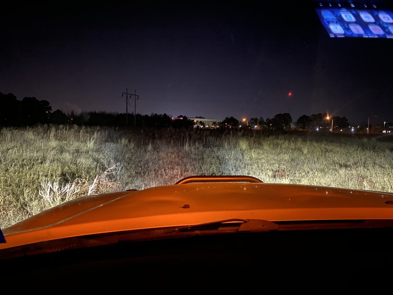

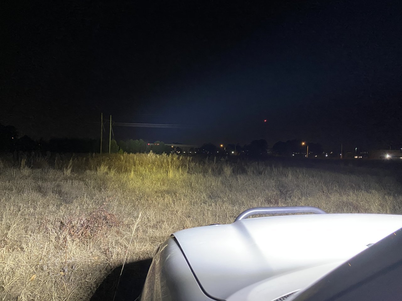

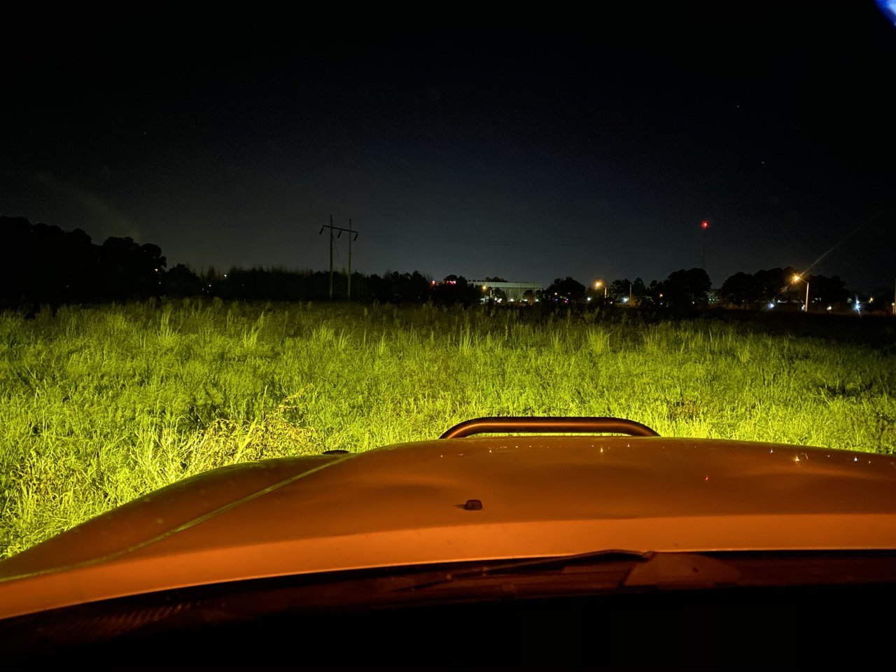

    So I went out last night to test all my lights and see their output. First up, only the S1's with amber wide cornering.
    Squadron sports clear wide cornering
    20" onx6 clear wide cornering

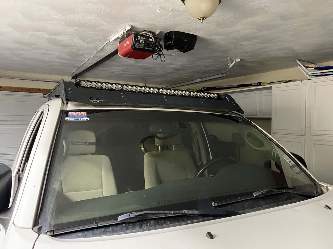

    40" S8 clear spot. Look at that hood glare! Gotta do something about that, because otherwise this lightbar is fucking useless.

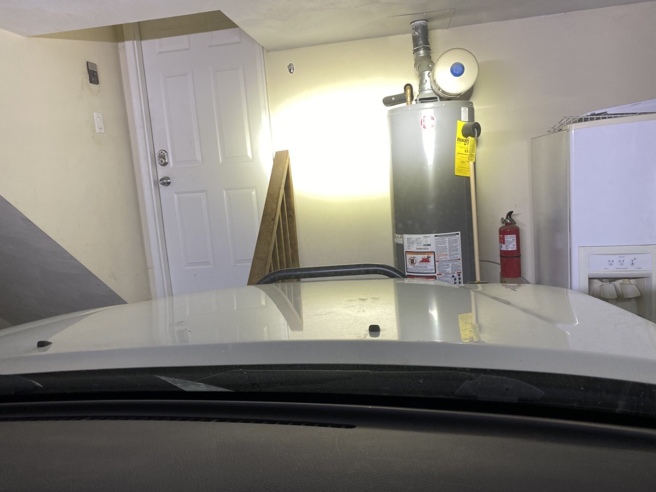

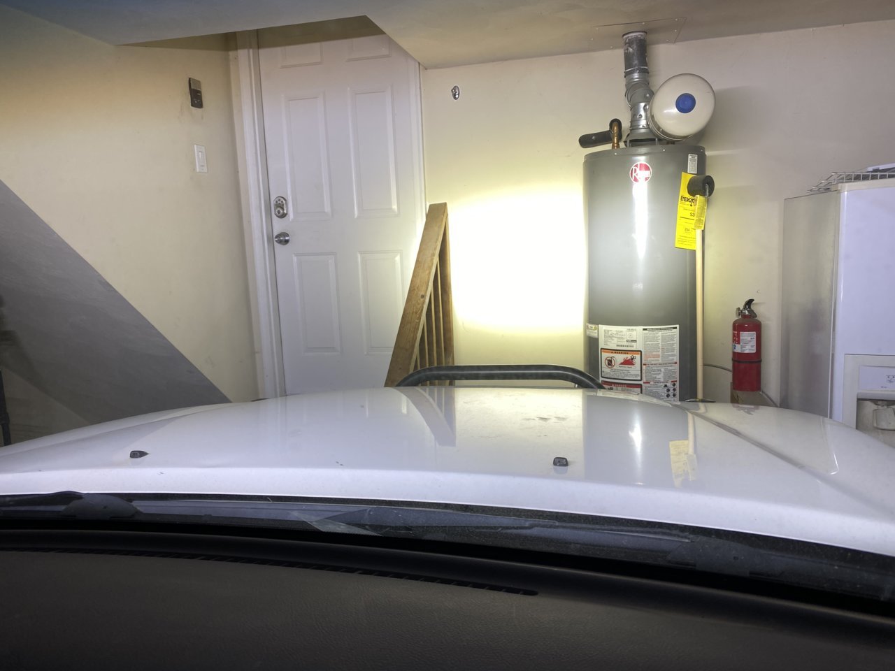

    A little before and after my solution
    C5F7E35B-75EF-4CE0-93DD-BEA38D12812E.jpg 23A2C3E1-F0D1-4928-9D37-D1FA6A3A67E2.jpg

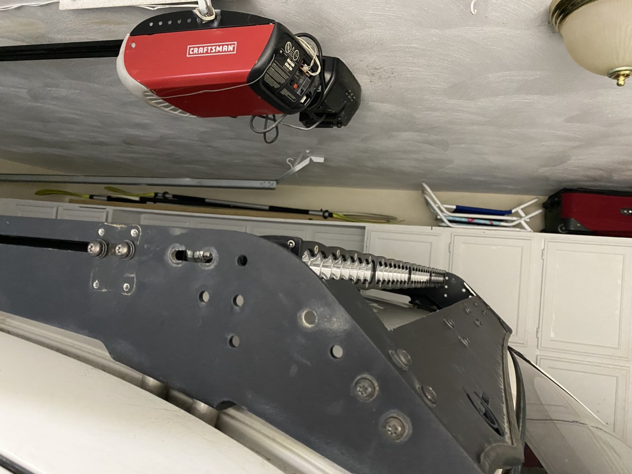

    My solution, which was just to move the crossbar back.
    5EED6972-E51D-45BF-8281-FF23A1BCCCB2.jpg EE65B789-8B14-46F5-BF07-7E7943070B45.jpg

    It's funny. I have a deflector with no cutout so I have had my 40" s8 in your new spot since I got it. I could never figure out why people were so frustrated by hood glare. Now I know why.

    I flipped the switch on last night and it's like I kicked on my light up hood, it was insane. Why not cut your existing cutout to get more useable light? That's all I did with mine, add my own cutout.

    Never had the need to, I guess. I suppose it would add a little more downward light, but it works just fine as is and little hood glare.

    Went and checked, and the fix worked like a freaking charm. POWEERRRRR
