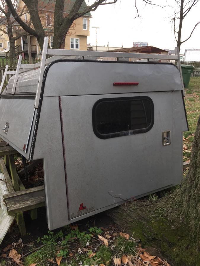

    Anyone in the Lair running a DCC wedge shell (or similar)?
    I have a chance to get this one, but I'm not a huge fan of the barn door or that it's about 5" taller than the cab.

    Then you'll really be an old man, riding around with that thing. If you can get it super cheap, try it out and sell it if you don't like it.

    I was thinking I'd look like a bad ass MF'er with world cap carpentry skills.

    Hey whatever helps you sleep at night. I think a cab height black one would look sweet, but those are less common.

    Yea. I haven't seen one in the last year of searching. Short bed aluminum contractor caps are pretty rare. Cab height in black for under $500 is a damn unicorn.

    Personally, I think you'll appreciate the extra height, and that full rear door. Especially if you have things on the cab rack to even it out. I hate having to deal with a tailgate. My arms are short though, like me.
