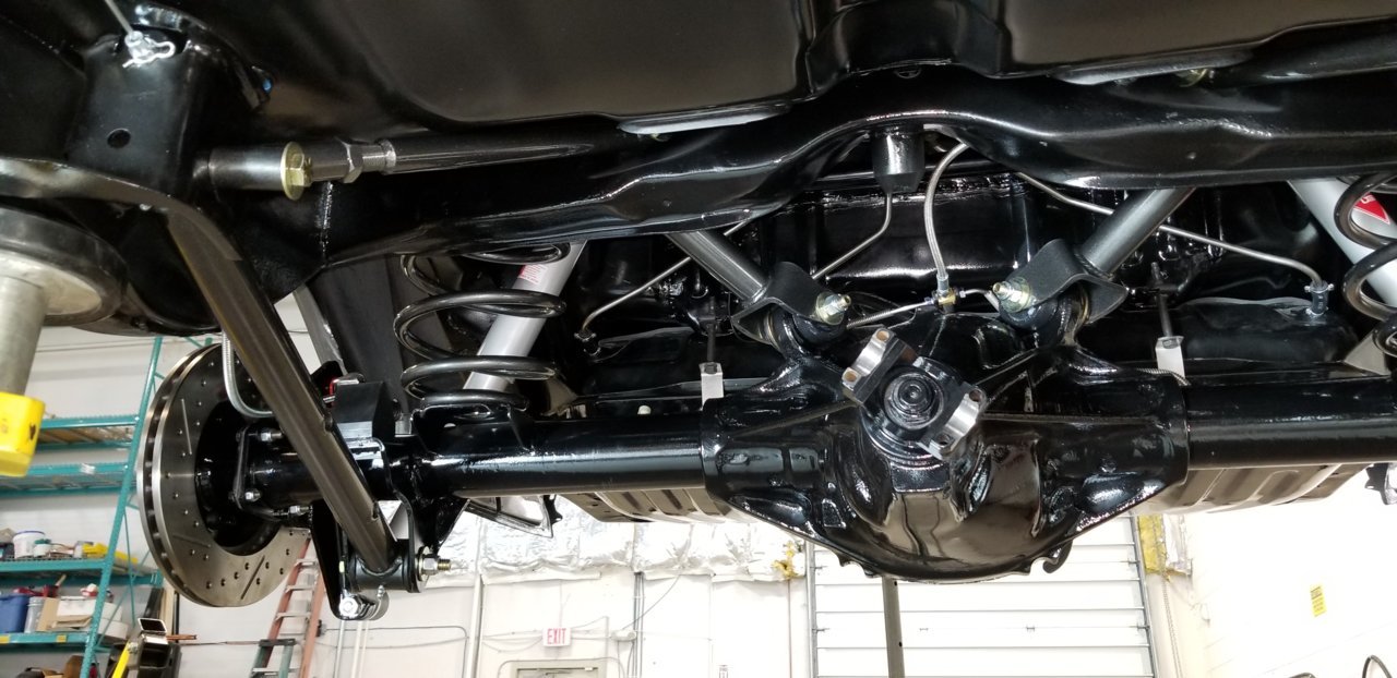

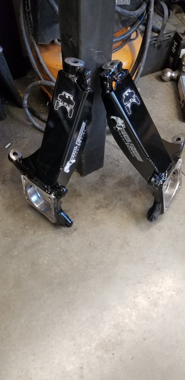

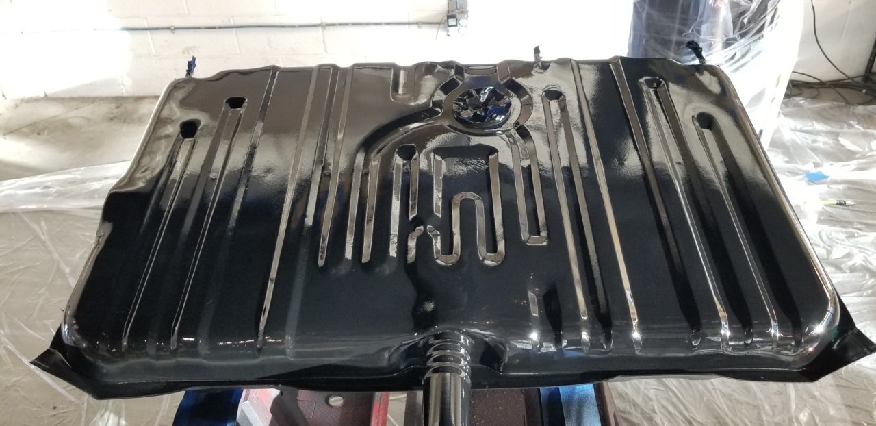

    Some not so good pictures of my paint projects. Using omni paint they sprayed great. Of course there was trash in the paint from spraying in a garage. Still much better then spray paint. I use the detail gun instead of spray pain cans. 1000x better.
