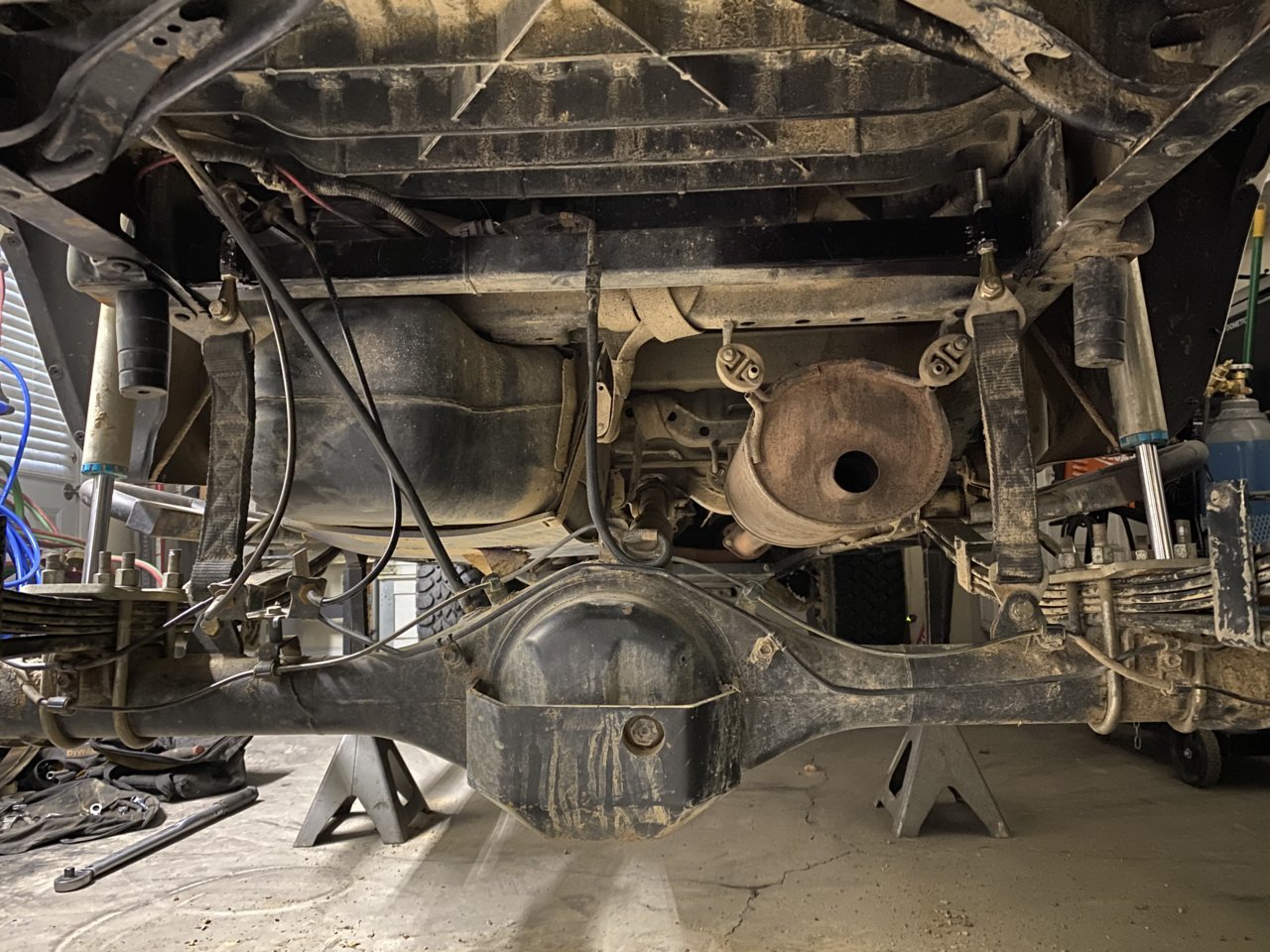

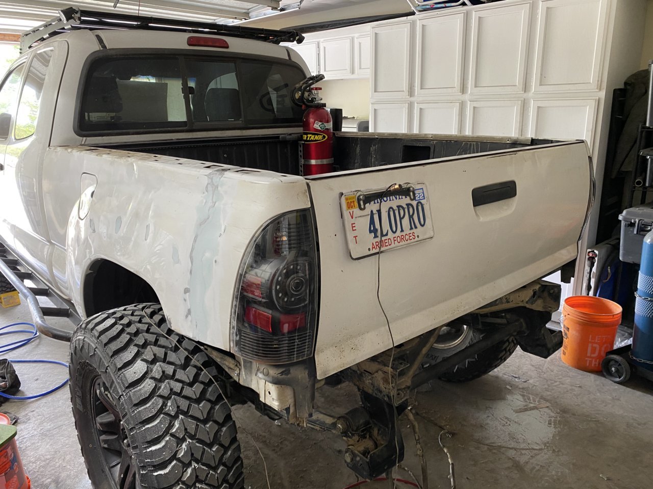

    I redid my upper limit strap mounts so they’re | | Instead of / \
    before I failed to realize geometry and shit and that when one side of the axle goes higher, it pivots and allows the other side do go lower. Not anymore.
    Knowing this I measured how I have my lower shock mounts done and will cut them off and weld new ones on. Once the limit straps hit, I only have 9.25” of exposed shock shaft. I’m going to redo them so I have 11” exposed shaft. I will gain 1.75” of uptravel this way.

    I went back to oem exhaust. The other one was just too obnoxious. I had to cut it like that due to how the limit straps were mounted

    that’s what I did. Not sure if how much the piece of DOM does but I figured it can’t hurt. I think an “x” would be better. Once I relocate the gas tank I’ll probably add more.

    Definitely going with an ‘X’
    nice 3 link btw
