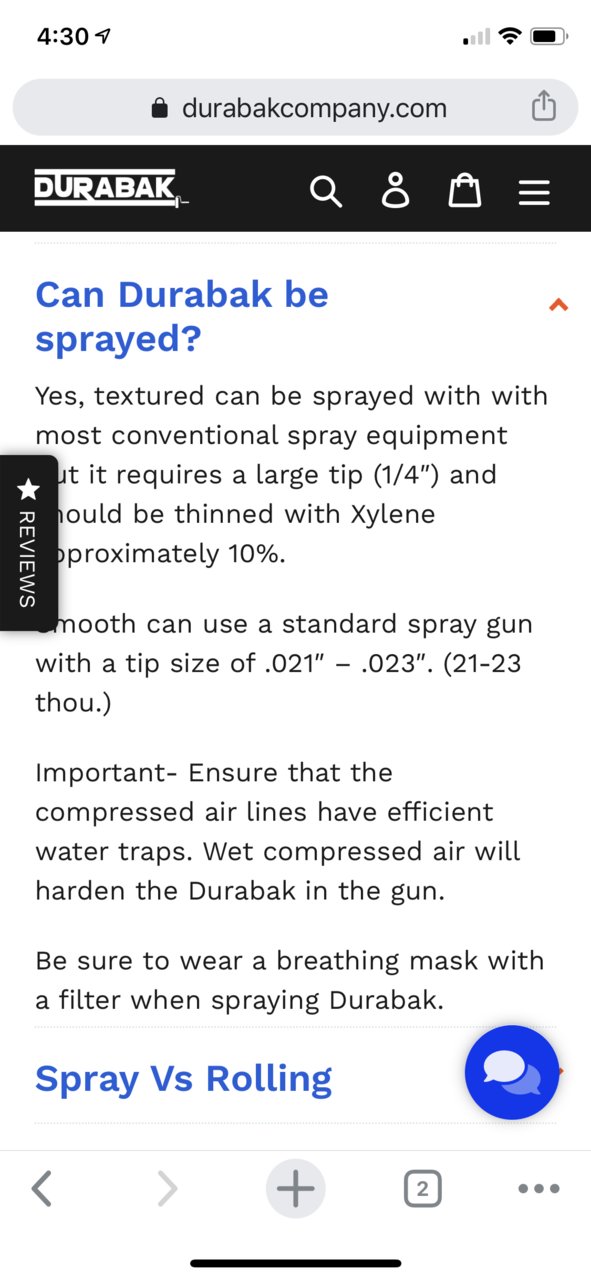

    No, that was my first thought to see if they offer a gun to use, but nope. I think they expect most people to roll it on. Which I’m unsure how that’d turn out on the truck. I may test it on the roof and see how it comes out

    A 1.3 is tiny for fine finishes. The bedliner will most likely jam up the gun. Or, just basically not spray. I have never sprayed a smooth bedliner only textured. There is a reason yu use larger tips with thicker materials. You can try t but remember if it is mixed with a herdener whatever you mix will be wasted if it doesn't work. Secondly make damn sure you clean the gun completely even between coats. Just my 2 cents

    Luckily it’s a pre mixed thing, no hardener to worry about and it can be thinned with xylene if it’s a little thick. I’ll just try the gun I have now and not bother trying to source one with a smaller tip. Thanks for confirming I’m not crazy

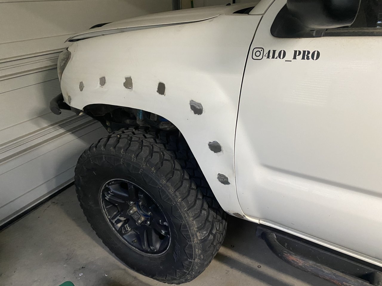

    I did do a little work on the truck today, welded the front flare holes shut.

    Bigger tip. Like we used 2.0's for builder primer, 1.6 for regular primer, and 1.4 for paint. The description you posted was for A .021 to .023 tip I believe I'm not sure how that translates

    For possible future reference how was this accomplished?

    He used lightning to drip molten metal into the holes.
