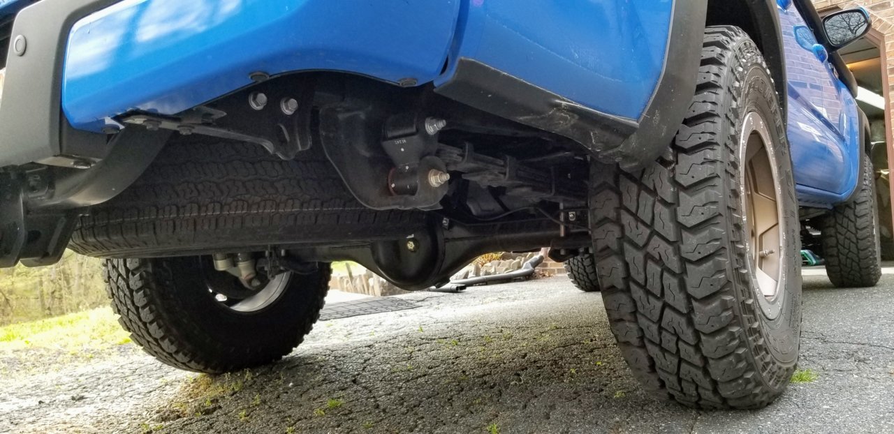

    So one of the things I'm not overly fond of is the protruding hitch. Sure it's tucked up nice and high, but dammit it sticks out far. I'm going to cut it off and weld a new one on the bottom of the tube. On a normal truck this is a hangup spot, but being bobbed it won't be a concern and it will look a lot better in my opinion. With appropriate gusseting and welding it will be plenty strong for the light duty use I'll rarely put it through.

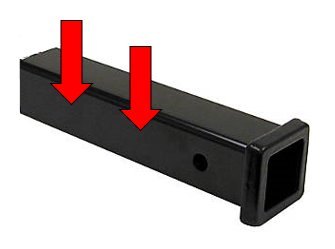

    Why can you just push it in flush with the back of the bumper? Yes, you would have to reach up behind there for the pin but for as infrequently as you tow, a simple bent pin and clevis would be all you'd need and not anything that locks. You can just burn slots into the bumper, then take the hooks off of your trailer chains. Chains in slots is a 2000 year old way of hooking them safely.
    Edit - Actually, you could then gusset the hell out of it on the inside and then you could use it to tow a decent weight.

    Looks awesome... I really like that it is offset enough to use the bumper as a step. Most are tugged in closer and hard to get a good footing on

    If I pushed it flush the hole for the clevis pin would end up in the middle of the bumper tube. If I wanted to do that I would have to cut into the back of the main tube and it’d be a lot more work and wouldn’t be sure if it’s effectiveness.
    Thank you, that was very unintentional but it ended up working out pretty well!

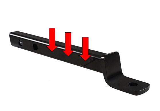

    When I worked out my flip up system for my cargo basket I had to do some hole drilling. You could easily do the same thing to make it so you could put a pin anywhere you want too.
    These draw bars come in different lengths too. But again, drilling holes is not shit for #RandyFab
