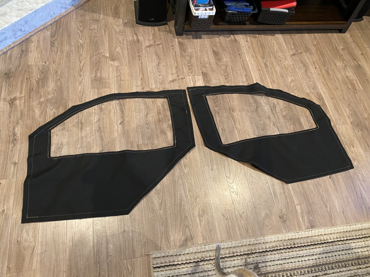

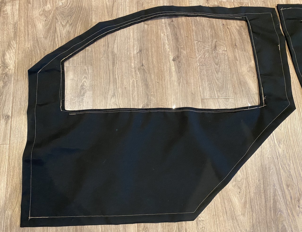

    If you make your hems doubled or tripled and no less than double sewn seams with the vinyl inside of all of that, then seal those, you won't have to worry about water intrusion and that will help reinforce those areas allowing you to pull the canvas taught. That will make it less flimsy at highway speeds. Nothing will make them absolutely not a little loose but you could add thin metal or heavy plastic Stays bent outward to add some resistance. Those Stays could be attached to the insides of the doors with the same snap system.
  9. Jun 23, 2020 at 11:08 AM
    EatSleepTacos
    EatSleepTacos [OP] Well-Known Member
    Mar 24, 2015
    #151688
    49,683
    Randy
    Hampton Roads, VA
    4x4 2005 SR5 AC 6MT
    That's the plan, all edges are doubled over, and will get double sewn. Prolonged highway speeds will take its toll on them otherwise.

    Right. I would add the seam sealer regardless. It's a silicone that will dry solid and keep it flexible but also add strength.
