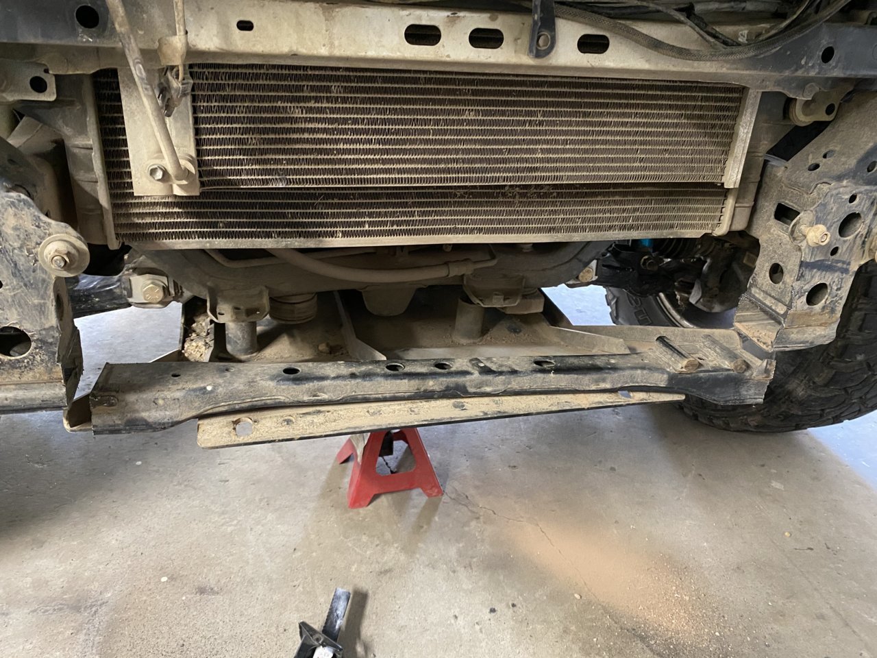

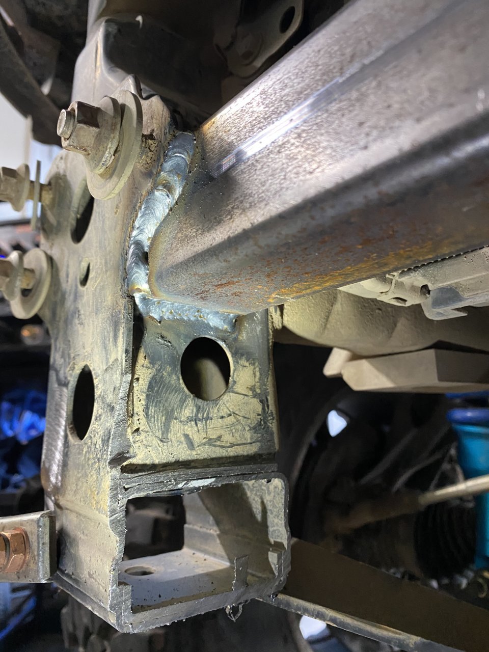

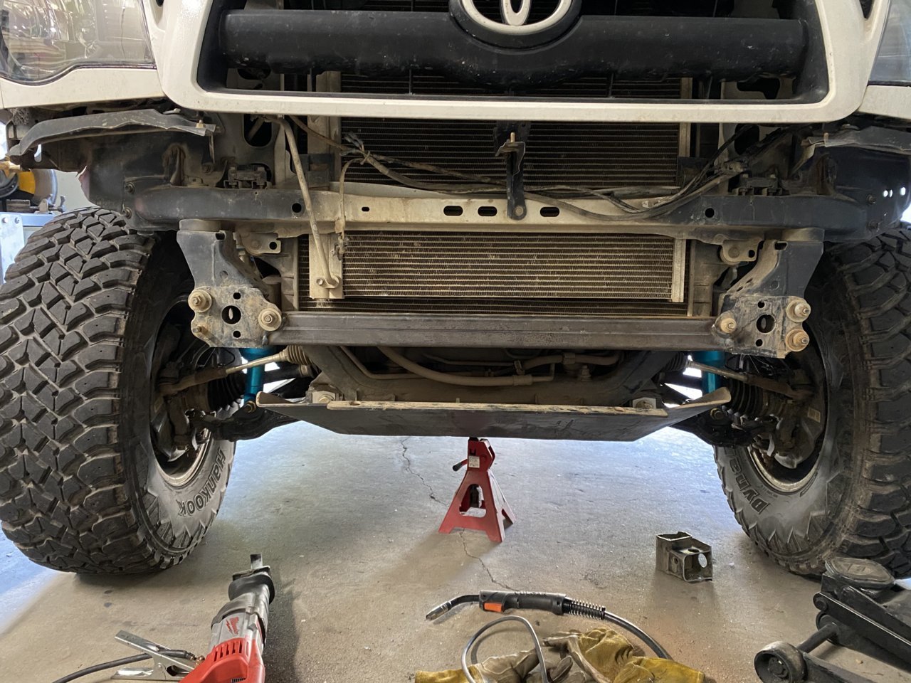

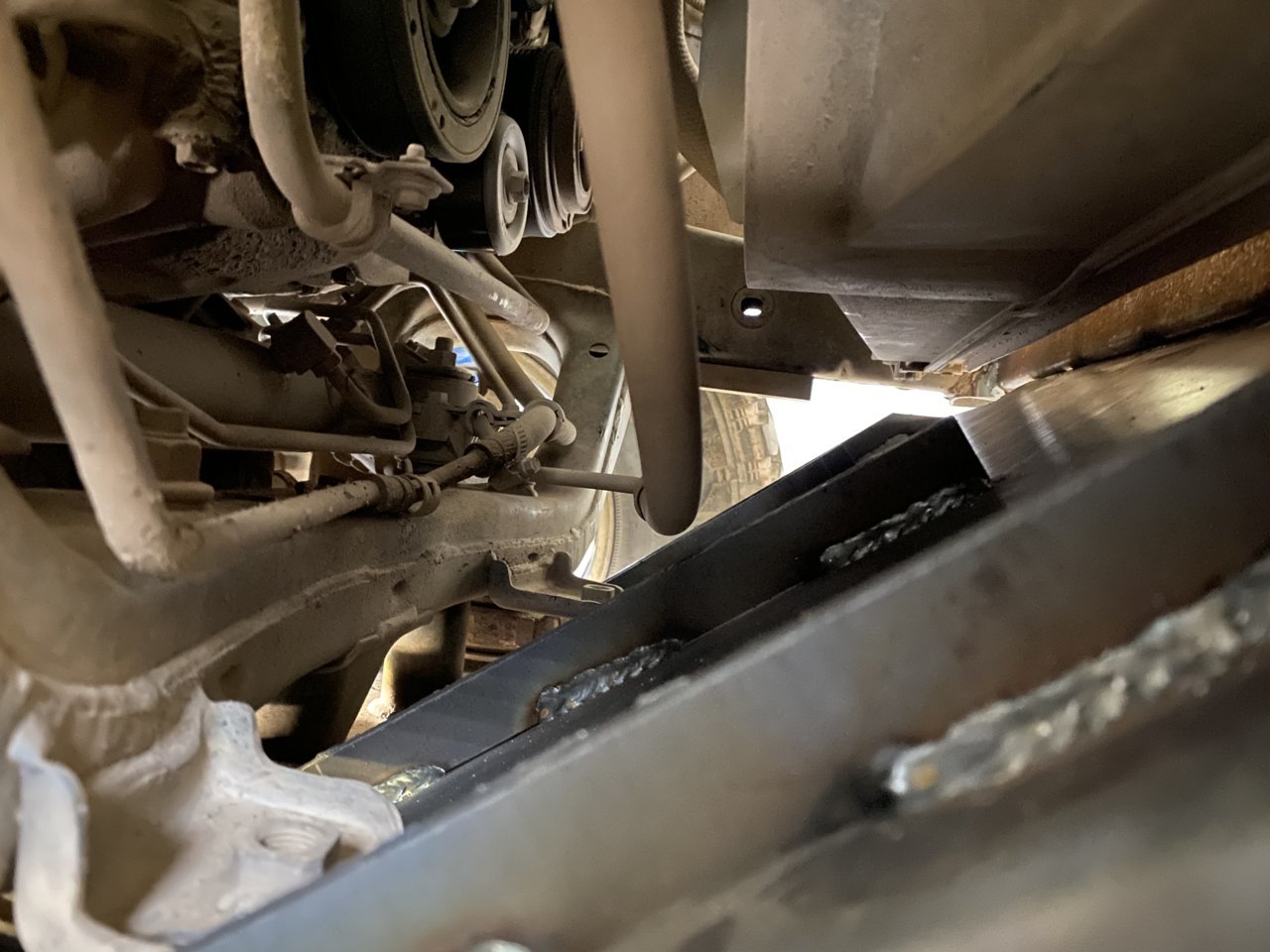

    Getting started on the next project. Pretty happy with how these welds came out. This square tube is what my ifs skid will now mount to, raising it up 4”. I’ll determine the new angle once it’s all done.

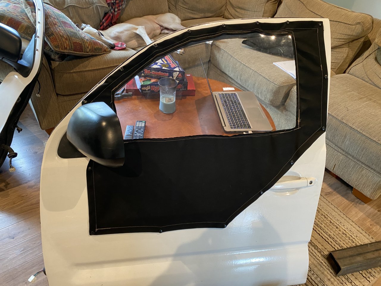

    You screw in the male pieces of the snaps into your door? I have a couple of those on the back of my bed for my softopper by the back window.

    Yeah exactly those. I bought all the snaps from softopper.

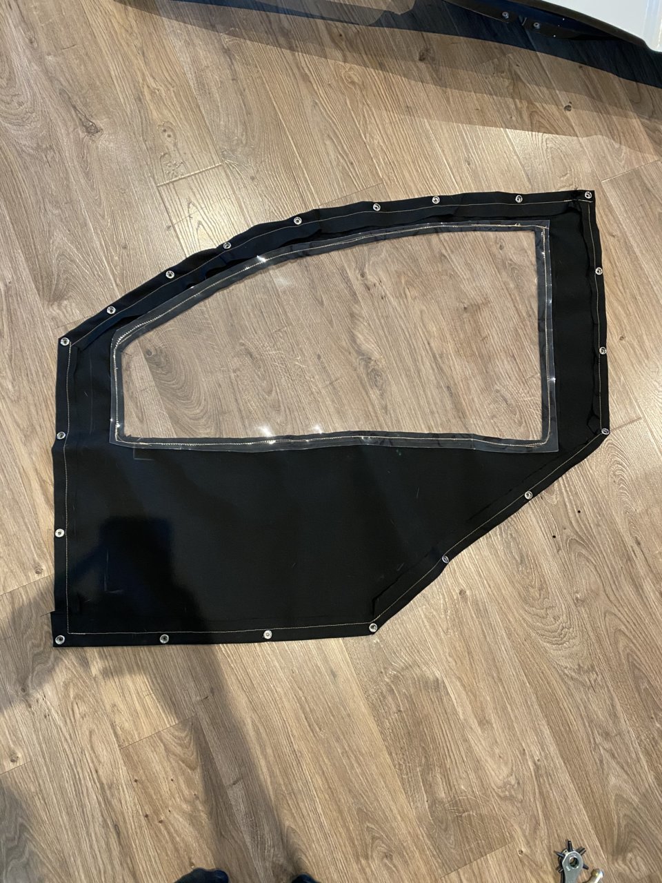

    Looking good so far. Couple things i've learned from mine...
    - Keep the vinyl cleaned and conditioned, first set i didnt and cracked after the first year. Also bought better Bestop supplier vinyl. [​IMG]
    - Silicone bead around the seams to make the sewing sealed and give more support.
    - I roll mine up together and put them in the toolbox, dont roll them super tight.
    -When it gets cold the clear vinyl tightens up, make sure you have some slack (opposite for those hot days)
    - Looks like you got the same snaps I did, keep a few spares, and everyonce in awhile slightly tighten the inner snap tension piece. Doing this I have no problem doing 80mpg + with no issues of flapping or flying off.

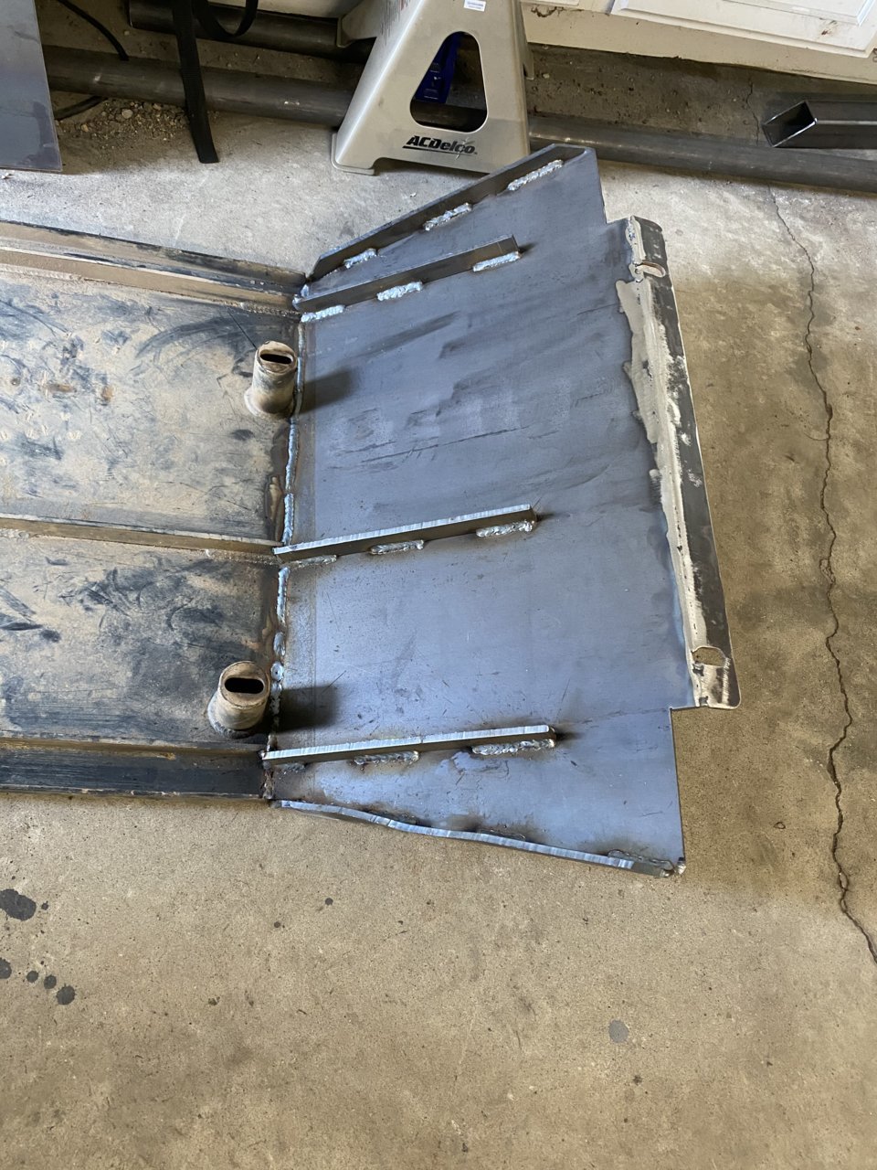

    EatSleepTacos
    EatSleepTacos [OP] Well-Known Member
    Mar 24, 2015
    #151688
    59,834
    Randy
    West Valley, AZ
    2017 4Runner

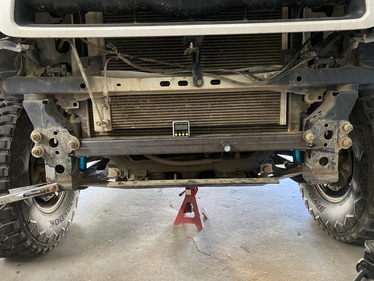

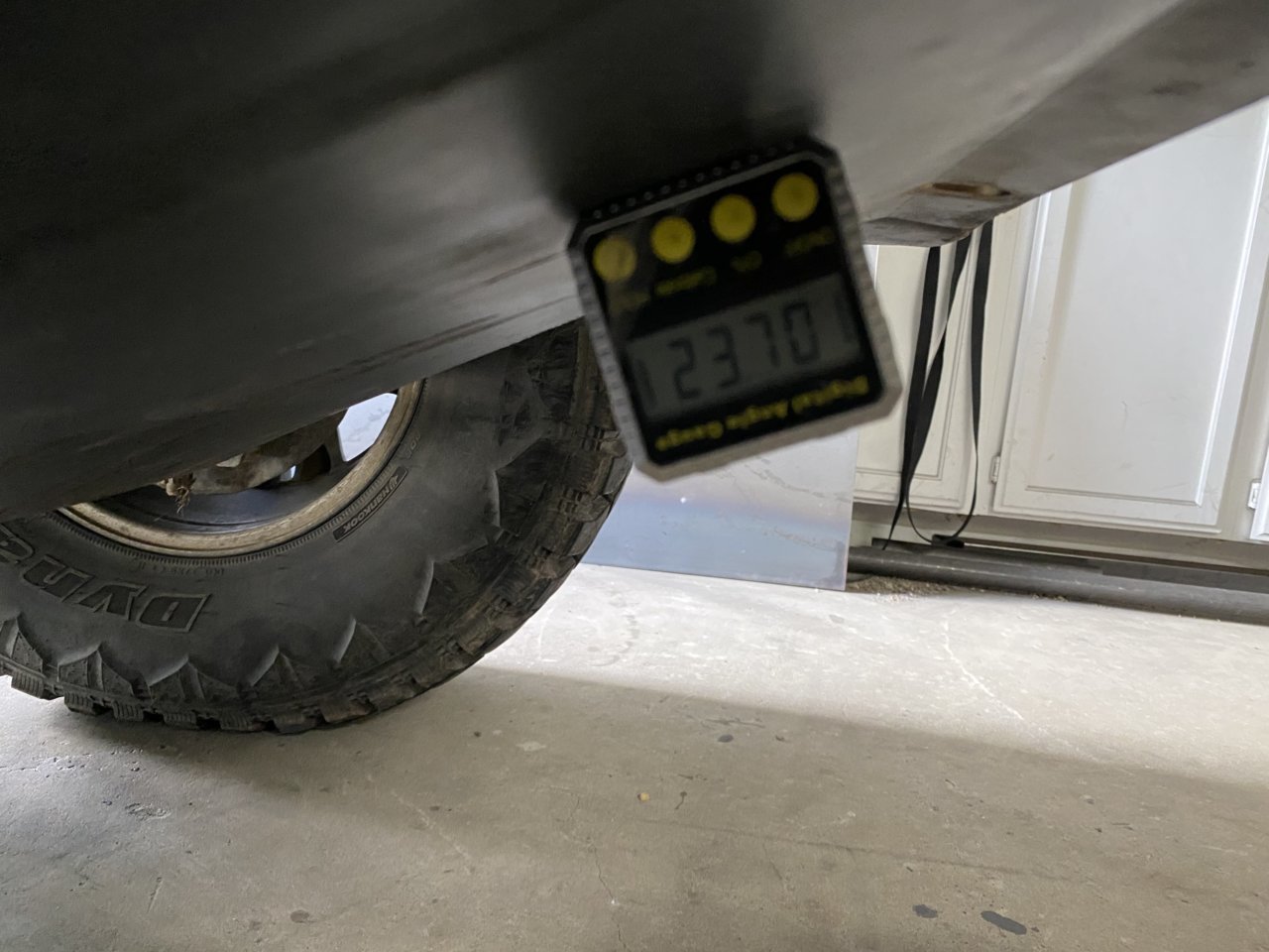

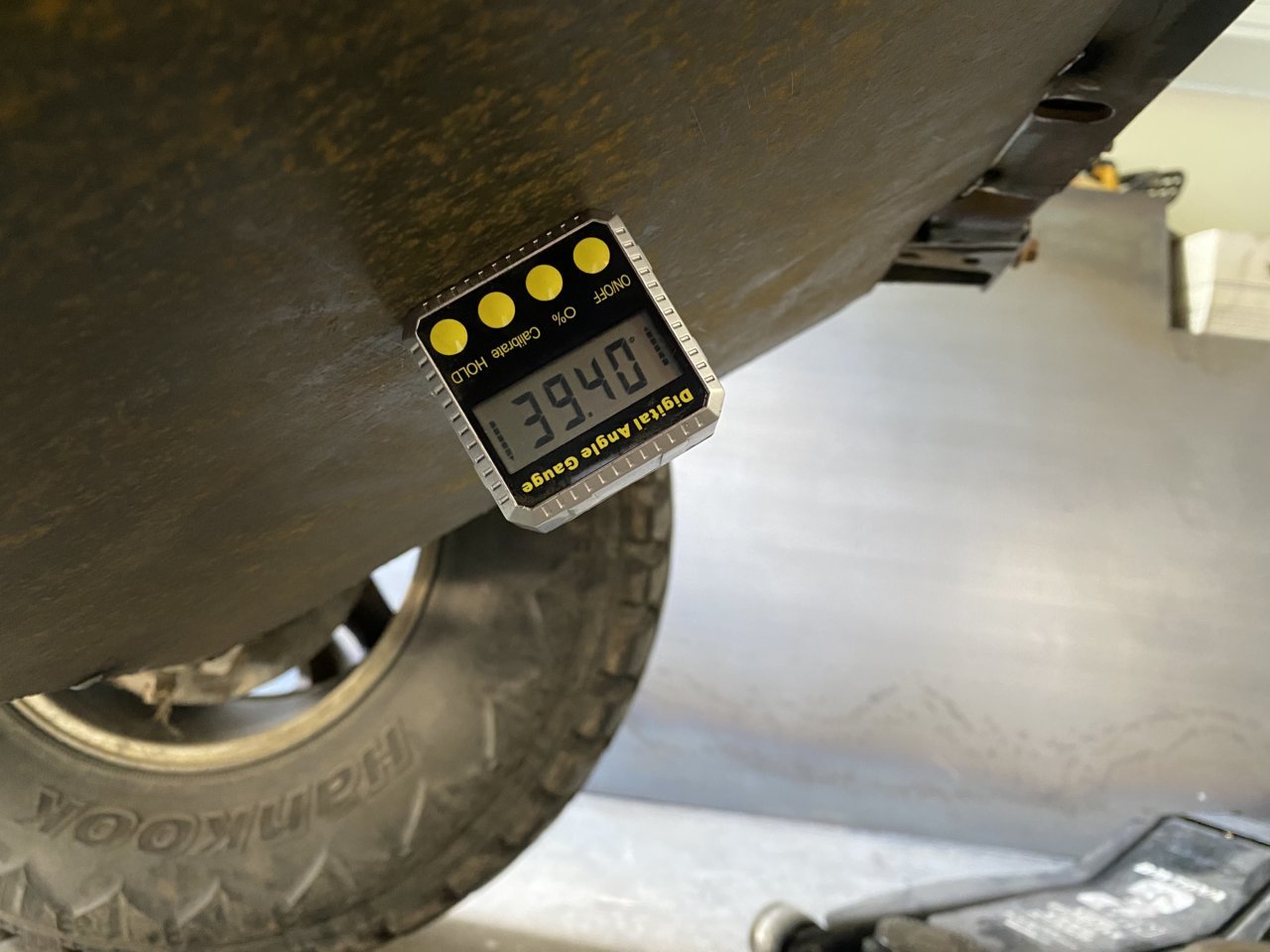

    Everything is only tacked up, but I’ll be gaining 15.7° approach angle at the skid plate.

  14. Jun 26, 2020 at 3:13 PM
    EatSleepTacos
    Mar 24, 2015
    #151688
    59,834
    Randy
    West Valley, AZ
    2017 4Runner

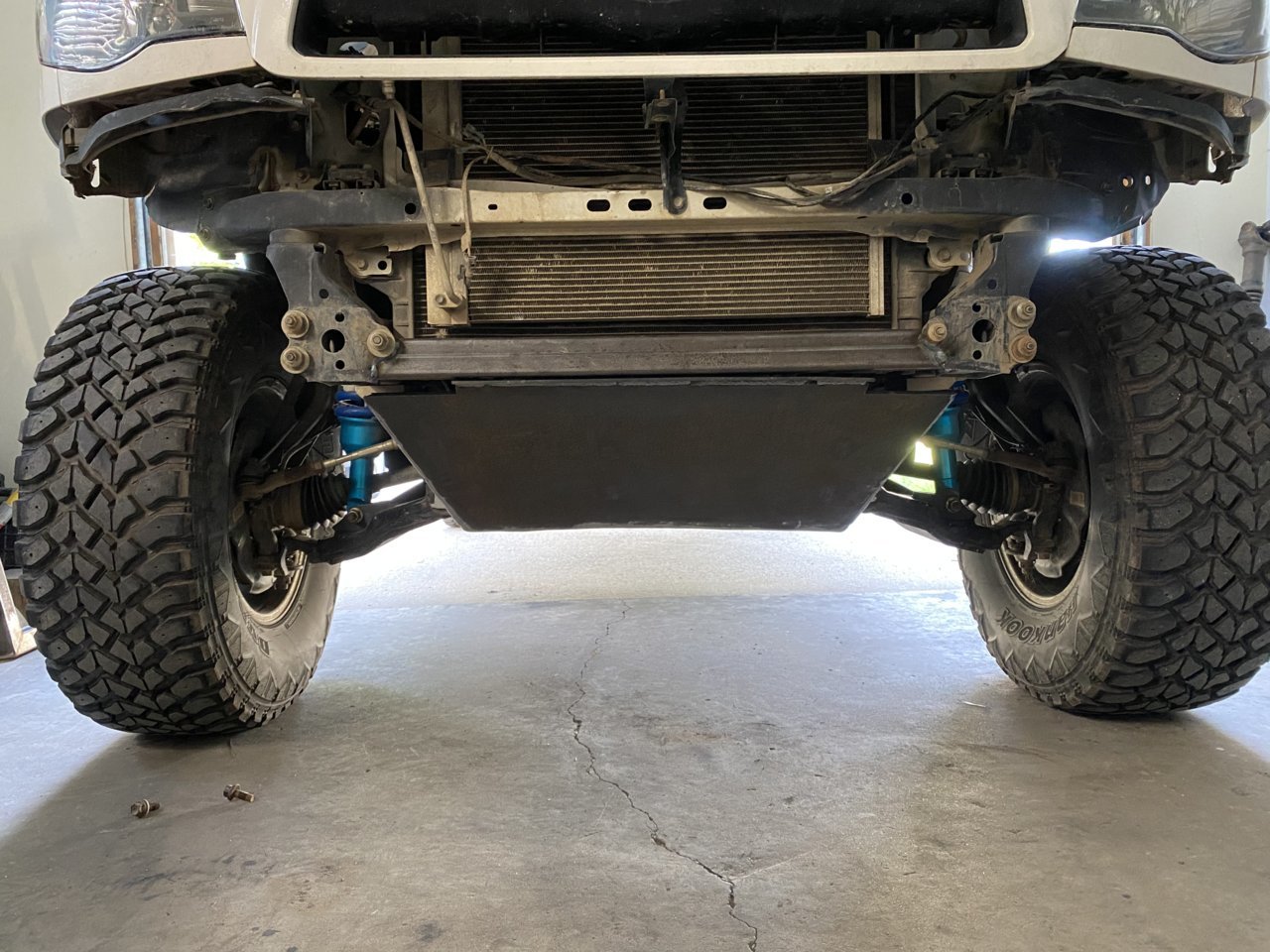

    Now just need to paint it, which will happen tomorrow.

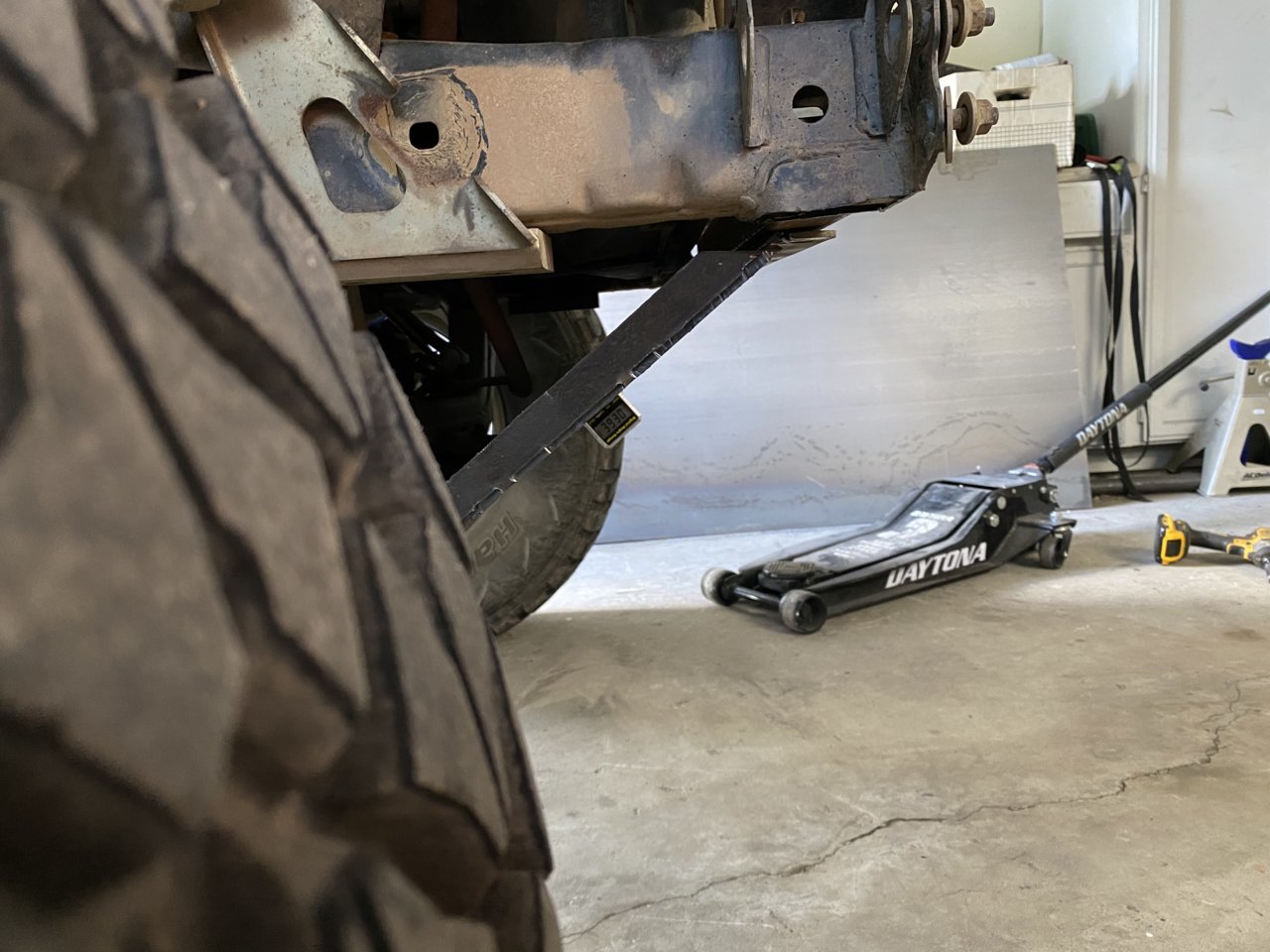

    EatSleepTacos
    Mar 24, 2015
    #151688
    59,834
    Randy
    West Valley, AZ
    2017 4Runner

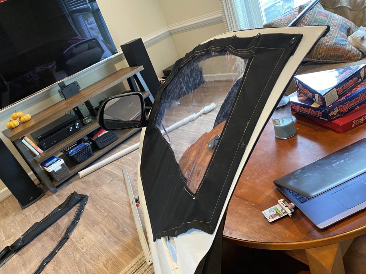

    @buyobuyo you we’re asking about being concerned about hitting something so I snapped a couple pics for you. The closest things are those little brackets which I may cut off tomorrow

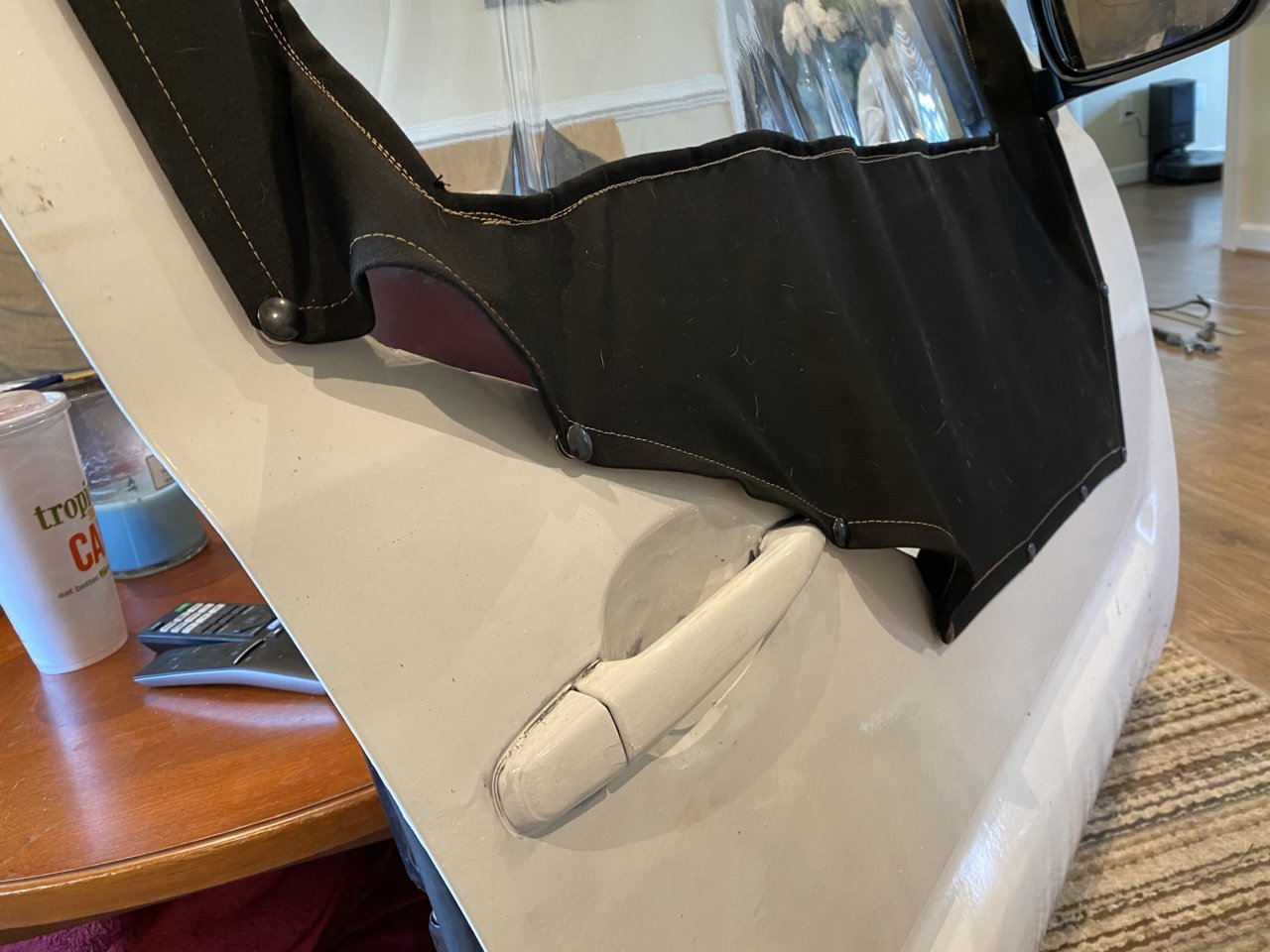

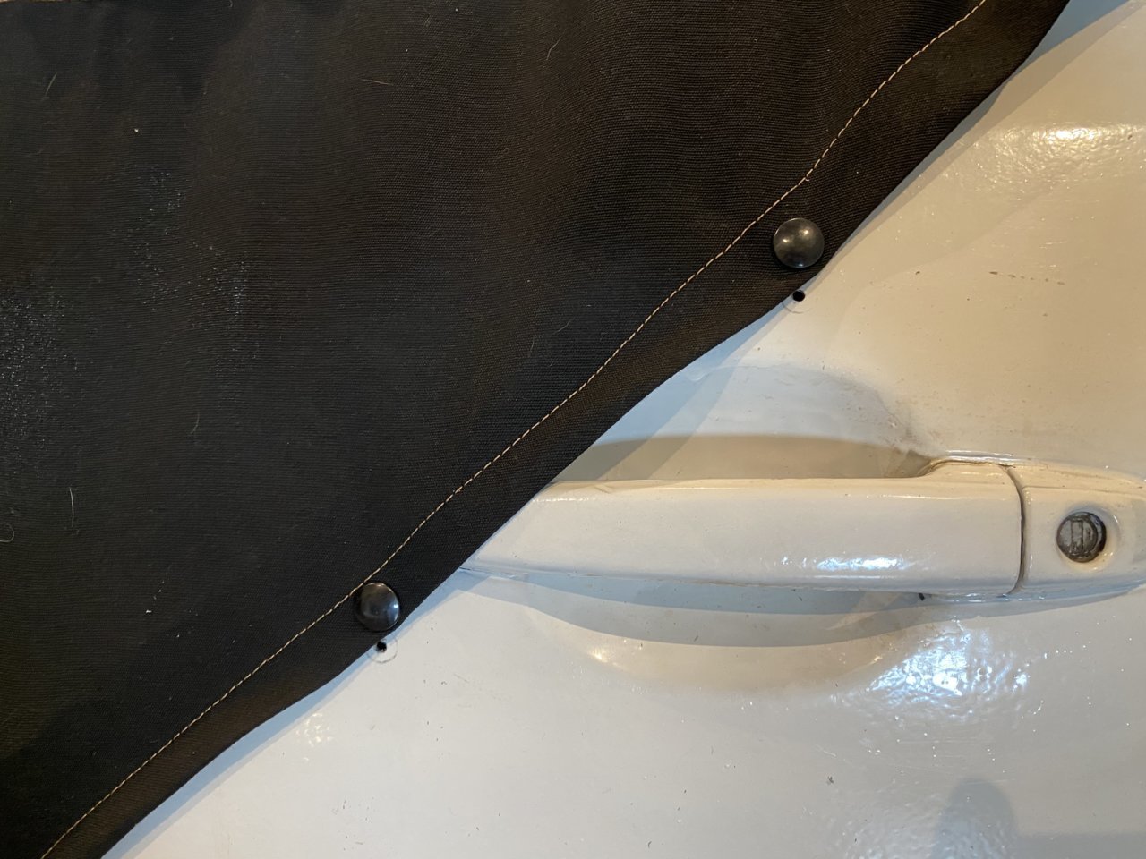

    RobP62
    RobP62 NVR20LD
    Jun 4, 2017
    #220718
    41,519
    Rob
    Street, Md.
    TTC Member #0125

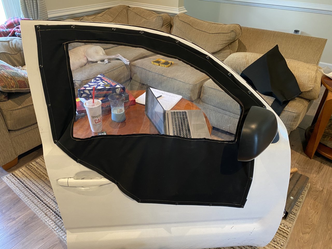

    That looks like an easy fix. Just move the snaps on the door. With the bedliner it's easy to cover up the mistake. You're going to want that panel as tight as you can get it. IMO. :notsure:

  18. Jun 27, 2020 at 8:31 AM
    RobP62
    RobP62 NVR20LD
    Jun 4, 2017
    #220718
    41,519
    Rob
    Street, Md.
    TTC Member #0125
    Well, and honestly the stronger velcro is not as flexible so running curves would be a bitch.
    Slashaar likes this.
  19. Jun 27, 2020 at 8:50 AM
    EatSleepTacos
    Mar 24, 2015
    #151688
    59,834
    Randy
    West Valley, AZ
    2017 4Runner
    I don’t think it’s a snap issue so much as a sewing issue. They’re not sewn perfectly so it’s going to be impossible to get a nice flat window. It should be fine.
  20. Jun 27, 2020 at 9:05 AM
    RobP62
    RobP62 NVR20LD
    Jun 4, 2017
    #220718
    41,519
    Rob
    Street, Md.
    TTC Member #0125
    It looked flat laying on the floor originally. As long as you're satisfied, that's all that matters. :thumbsup:
    It's still bad ass!
