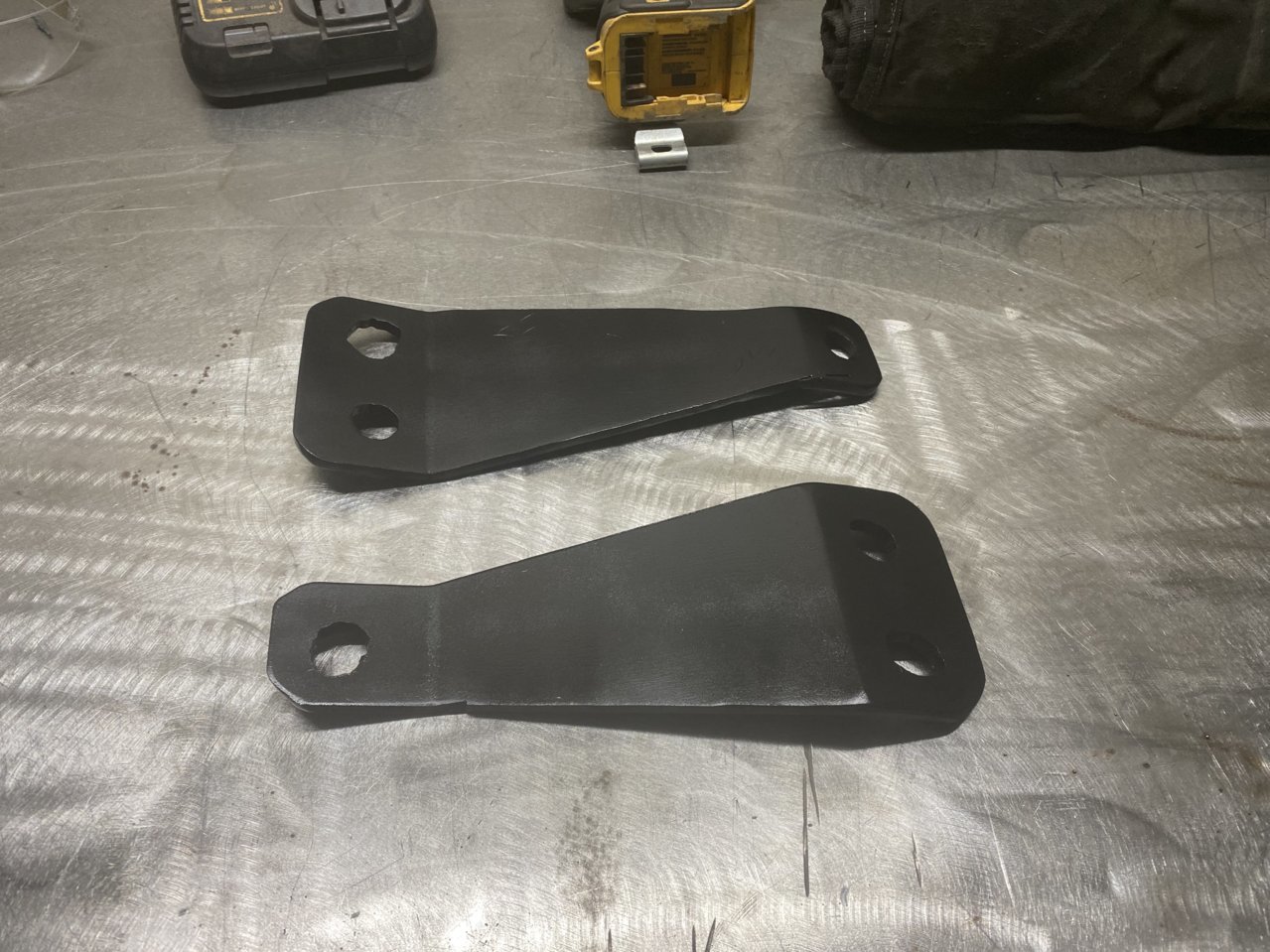

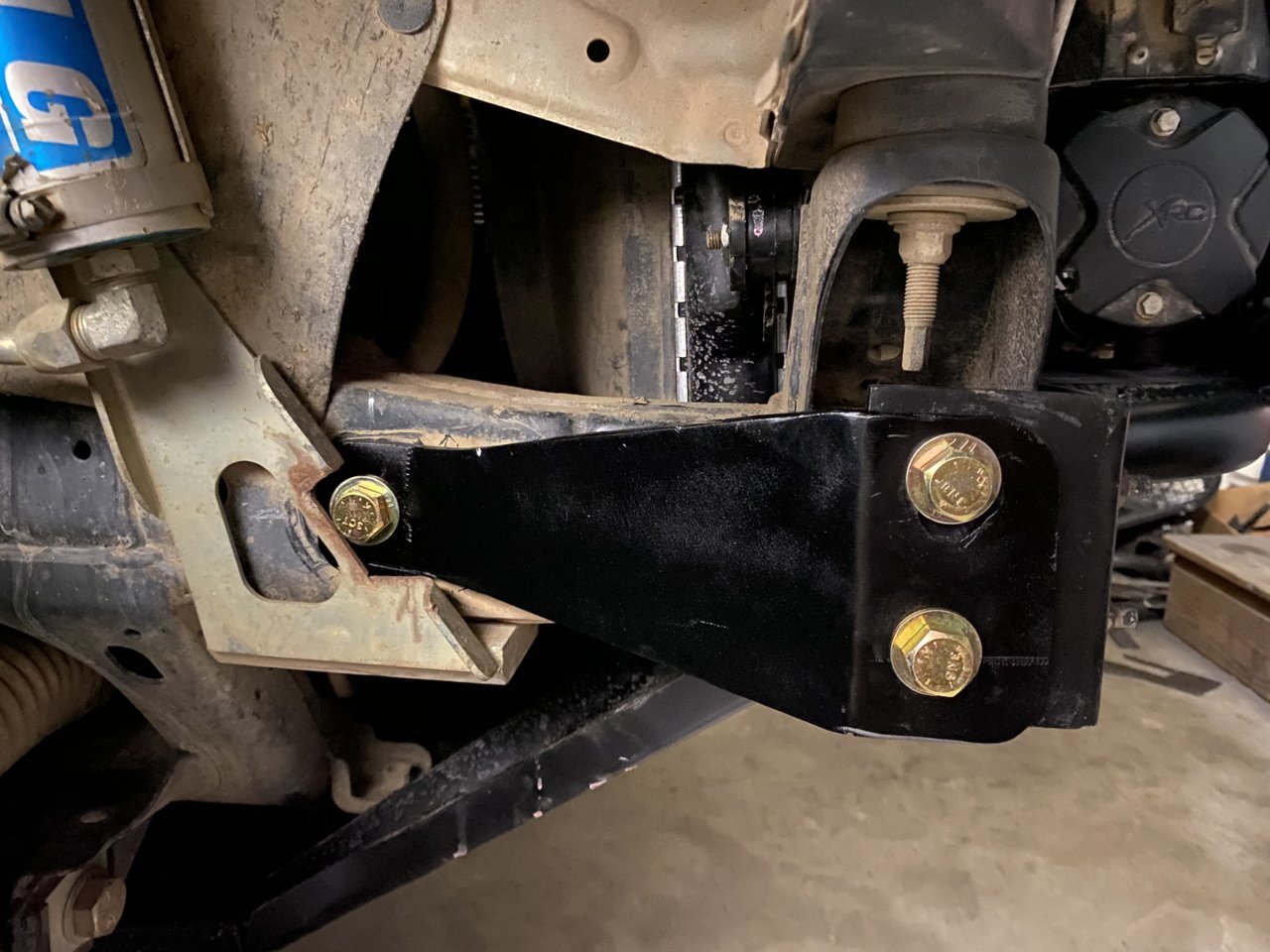

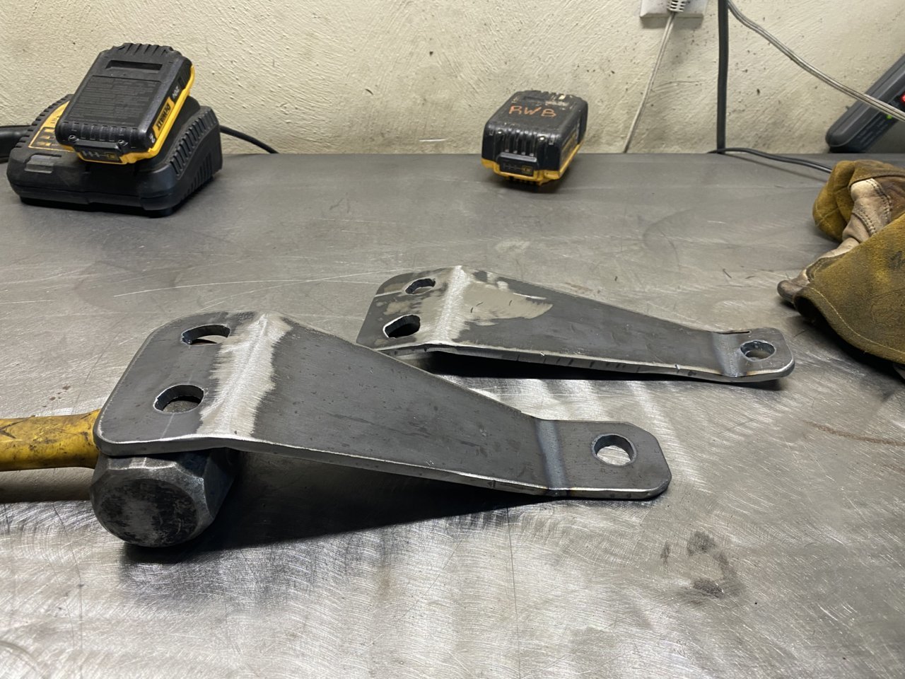

    Built these reinforcements for the bumper out of 1/4”. Just mimicked the straps that were on my old mobtown bumper. It ties the bumper further back into the frame for extra reinforcement on hard winch pulls.

    Looks good, I still need to put those on but not until I have all the holes filled.
