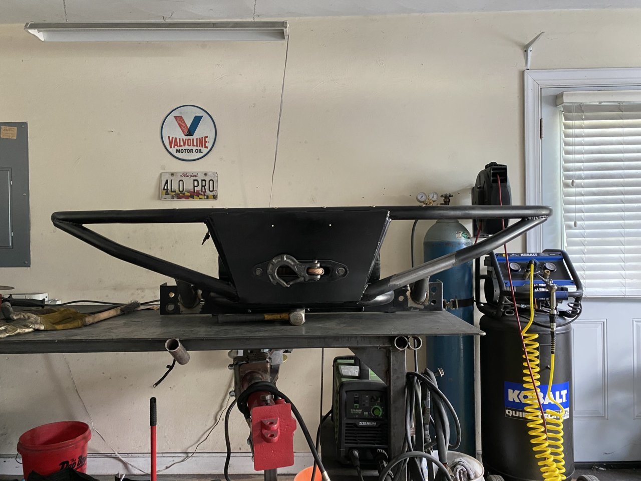

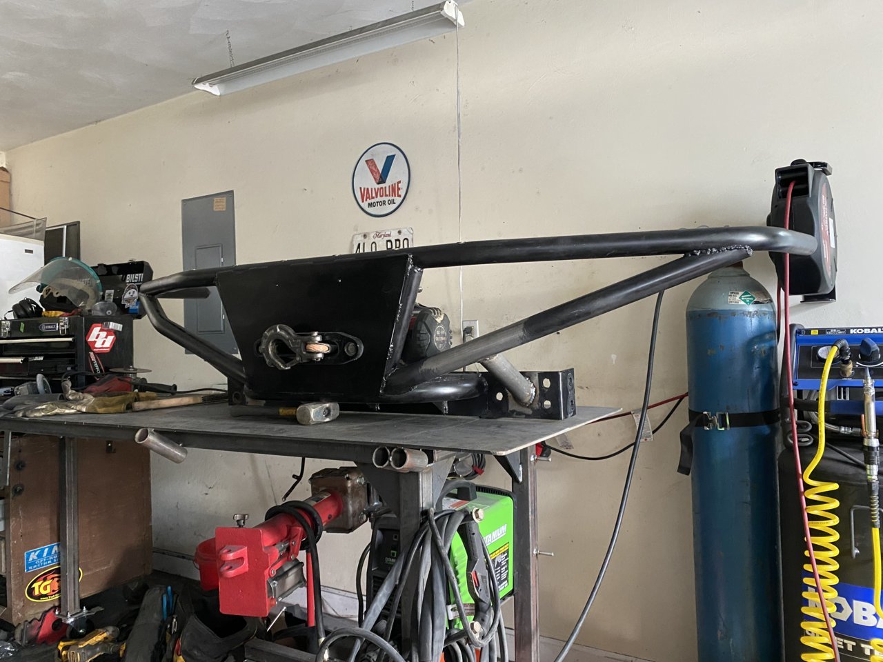

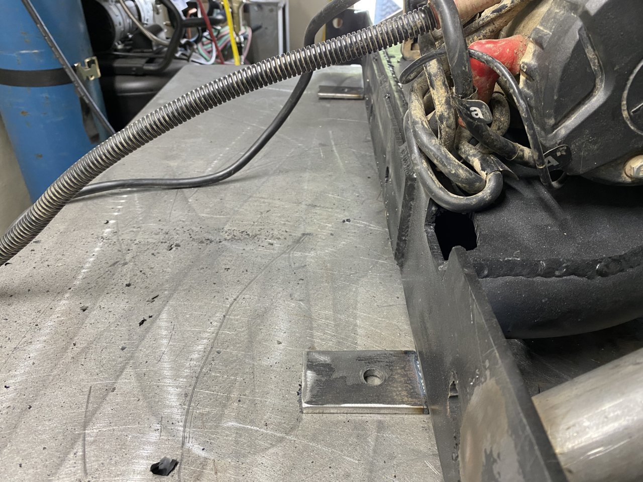

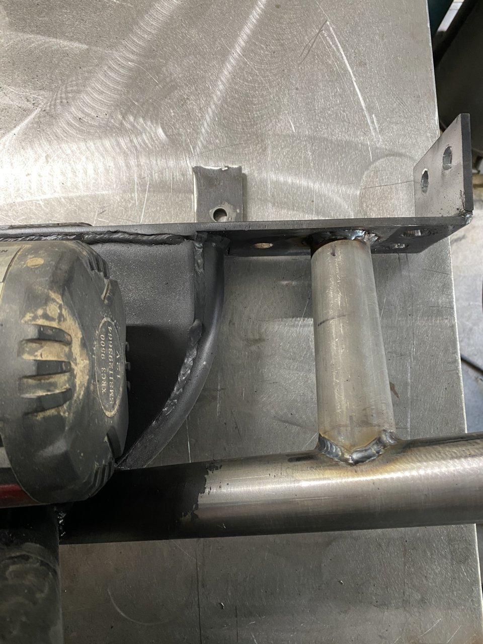

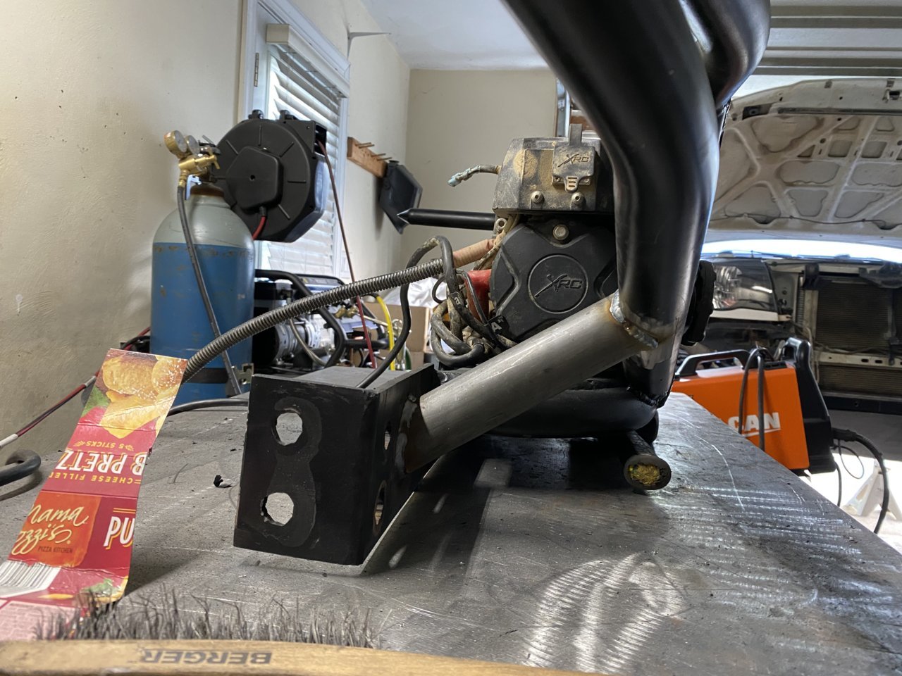

    So if I grab the tip of the main hoop on the bumper, it gave me enough leverage to flex the bumper a tiny bit. If I can do that by hand, I’m sure a winch can do worse. I think it’s because the main Mounting plate is only 4” tall so it can twist a little bit. So, I added tabs that reach under and bolt on. I also added these tubes to provide more support to the main body of the bumper. I realized the other day they had no support since it was only the welds up front holding the whole thing up. I didn’t want it vibrating while driving down the road and causing undue stress on the welds. They serve double duty so now I can toss a soft shackle on there and don’t need to worry about it sliding around.
