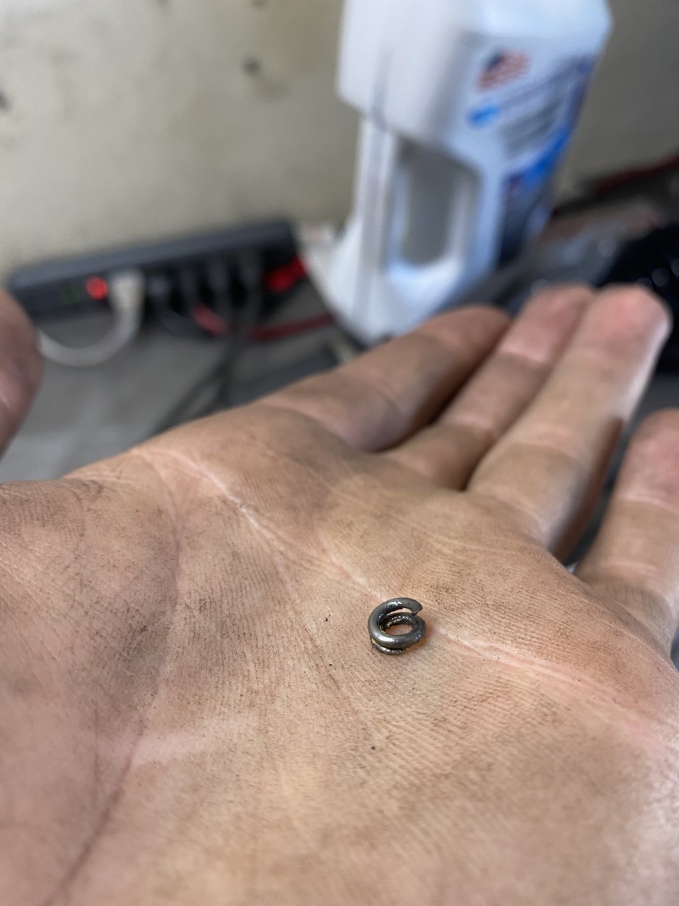

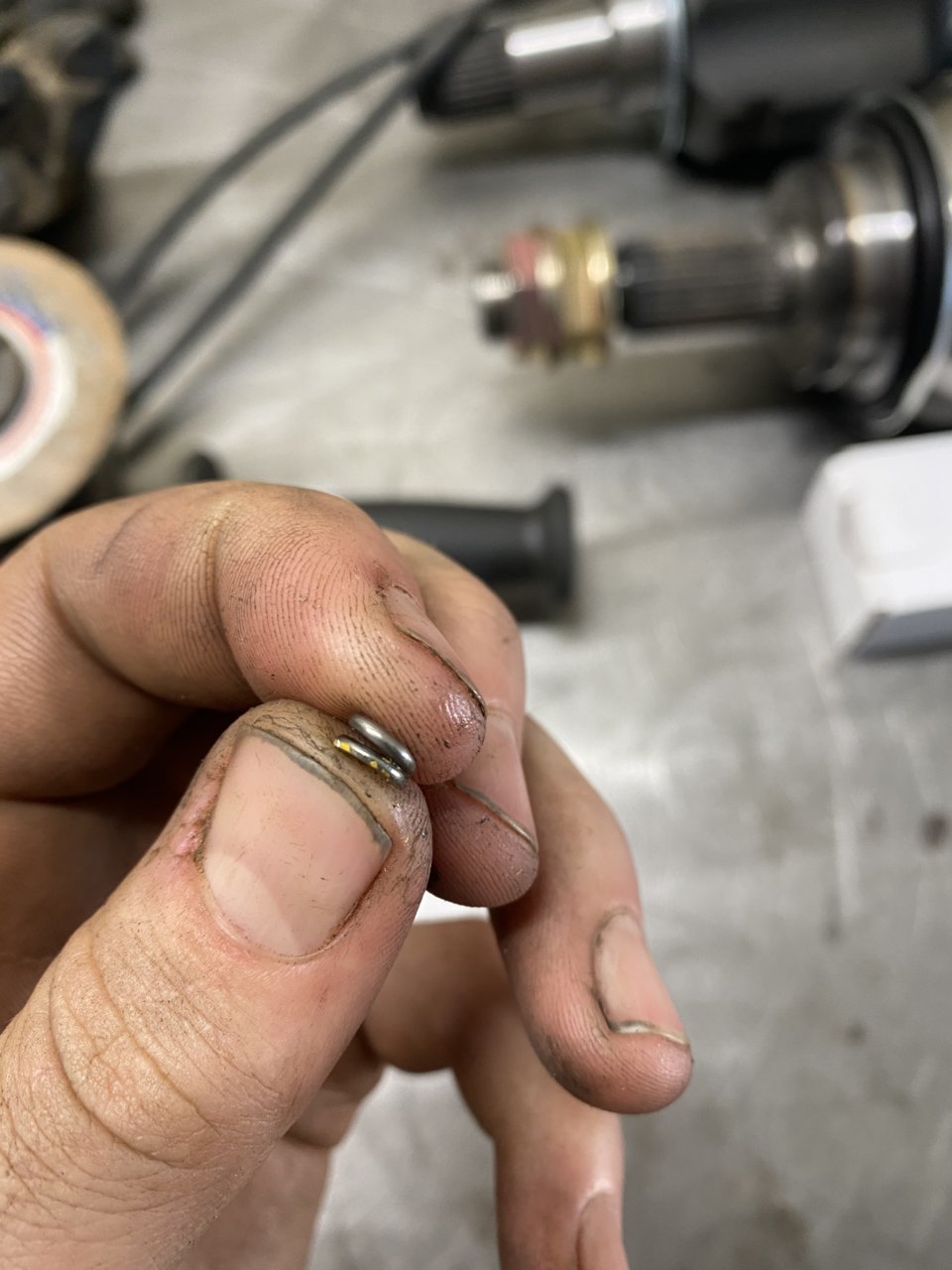

    Changing my rear diff oil and found a tiny portion of one of the springs from my lunchbox locker. I emailed ECGS to see if it’s anything to be concerned about, but due to its design I don’t think it is. I really don’t want to pull the diff and disassemble it just to put in new springs. Maybe next time I’m due for a gear oil change.

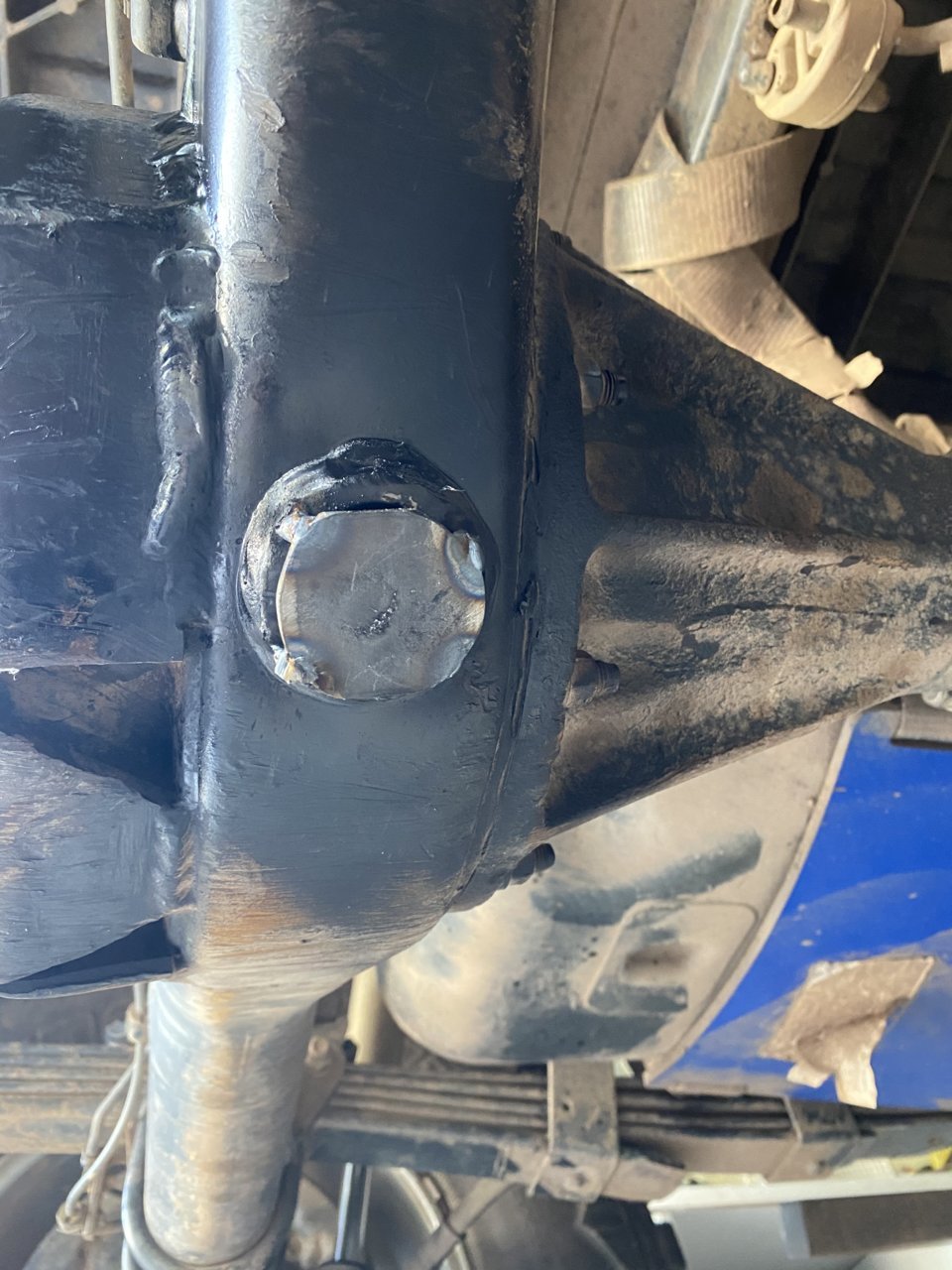

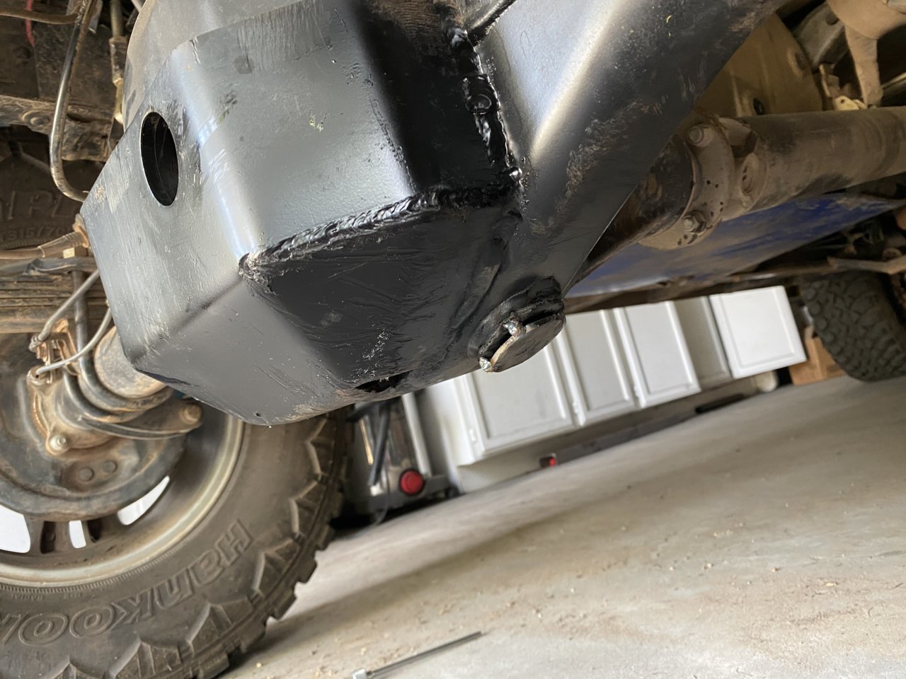

    I’m also trying a little something. One of my recent trips my drain plug loosened itself on the rocks. I took a piece of 1/8” and put some nice tack welds on it as a “protector”. I thought the drain plug was recessed (and maybe it was at some point) but not anymore. That’s why the plate appears not flush, but in reality it’s touching the drain plug. We’ll see if it works or if it gets ripped off.
