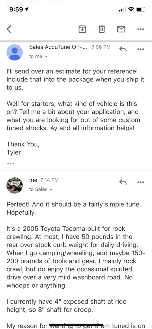

    Everything. Essentially what they want to figure out is sprung weight, unsprung weight an where the shock is located within the suspension travel.
    Weight alone wont tell them enough as the shock could have different leverage depending on its placement if that makes sense.

    He asked me like he was trying to build me a dating profile lol

    They have a sheet to fill out. I'm would assume thats next.

    I’ll let you know what the final cost ends up being. I’m most likely going to buy the stuff to charge the shocks myself (Accutune ships them uncharged) because the one place I know locally charges like $50 per shock or something ridiculous. I can get the stuff to do it myself for like $200

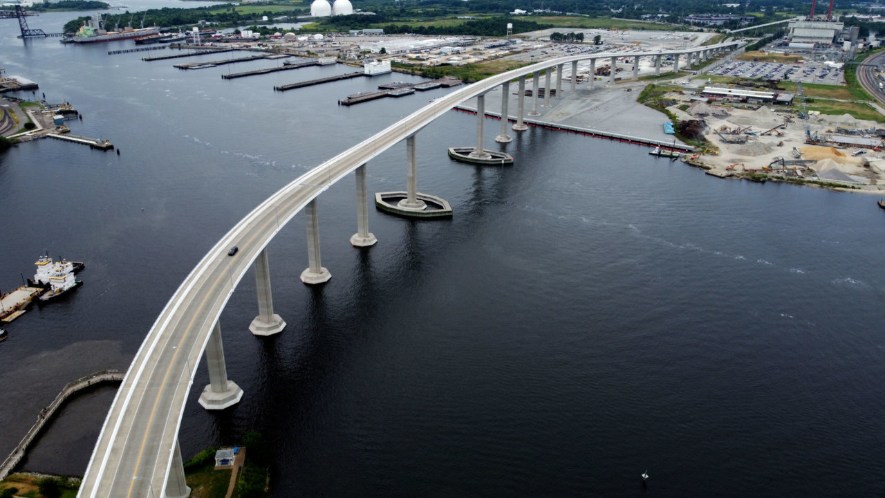

    Made that filthy water look good.
