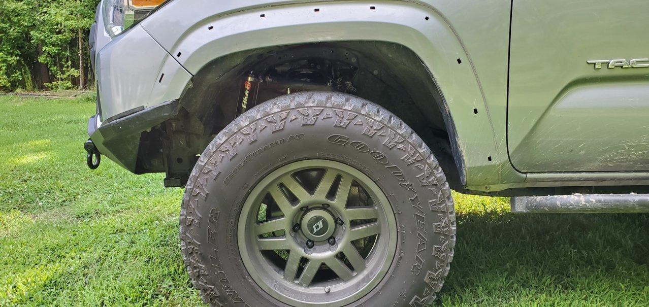

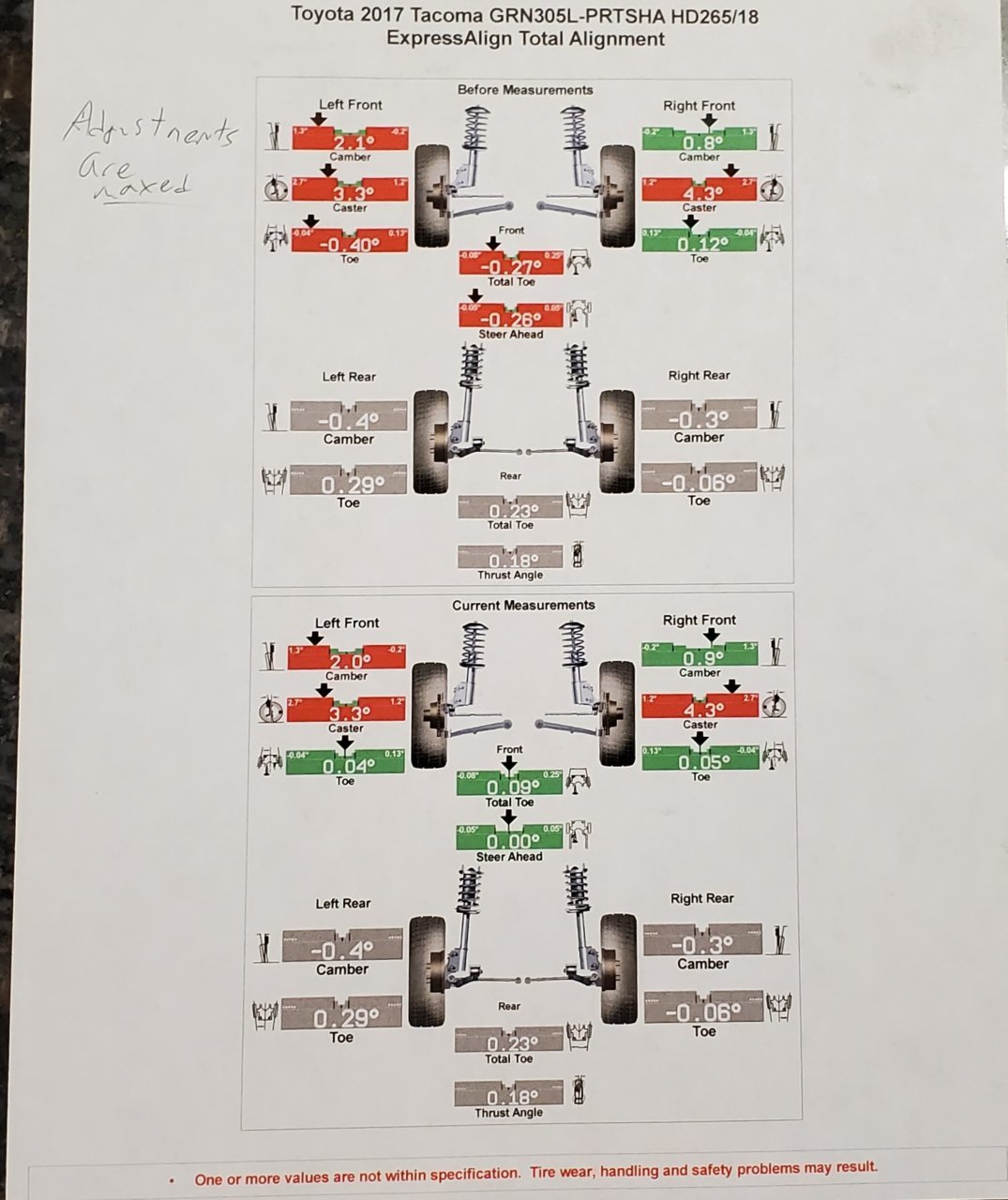

    20200729_172710.jpg they wouldn't adjust the UCA plate, but they got me straight tracking and the driving isn't nearly as taxing.20200729_162145.jpg
    Still rubs in reverse turns and forwards over bumps while turning.
    Already setup a Friday LCA&UCA front alignment tuning with the shop @TaKoToy recommended.

    need that camber fixed on the driver side. They should be able to bring up the caster as well.

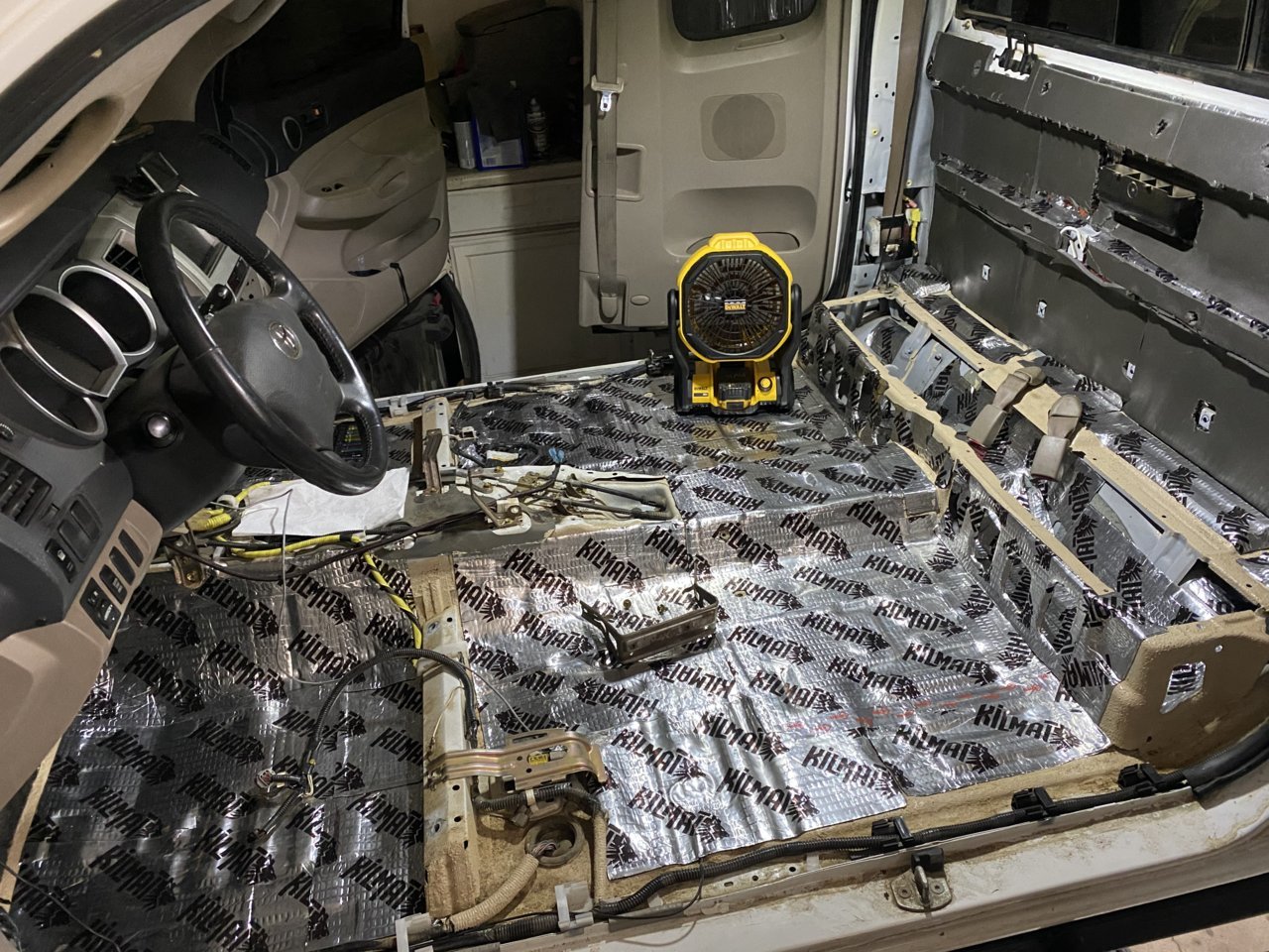

    Got the floor covered with this stuff and finished off the box, so I’m stopping for the night. Will put the foam on tomorrow and carpet as well.

    do you like the dewalt fan? I thought about getting one but $120 is a lot for a small fan.

    I would have died without it. It was on sale for $80 at Home Depot when I got it a few weeks ago. I also use it in my tent when camping.

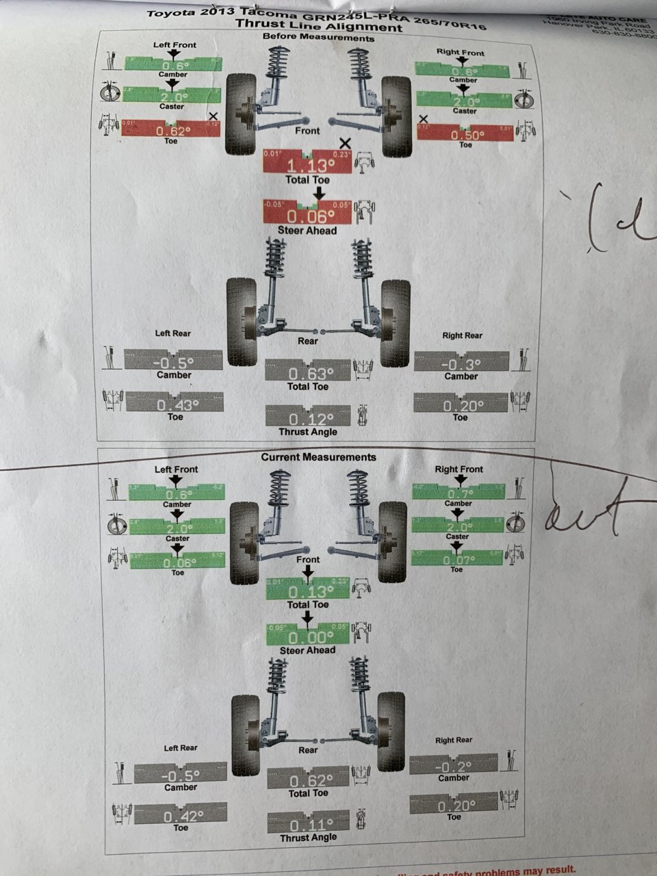

    I'm late to the party but we postin alignment sheets!? Got new upper BJ's installed today:
