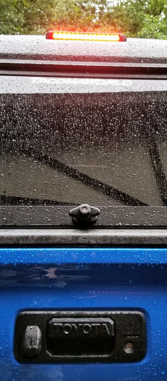

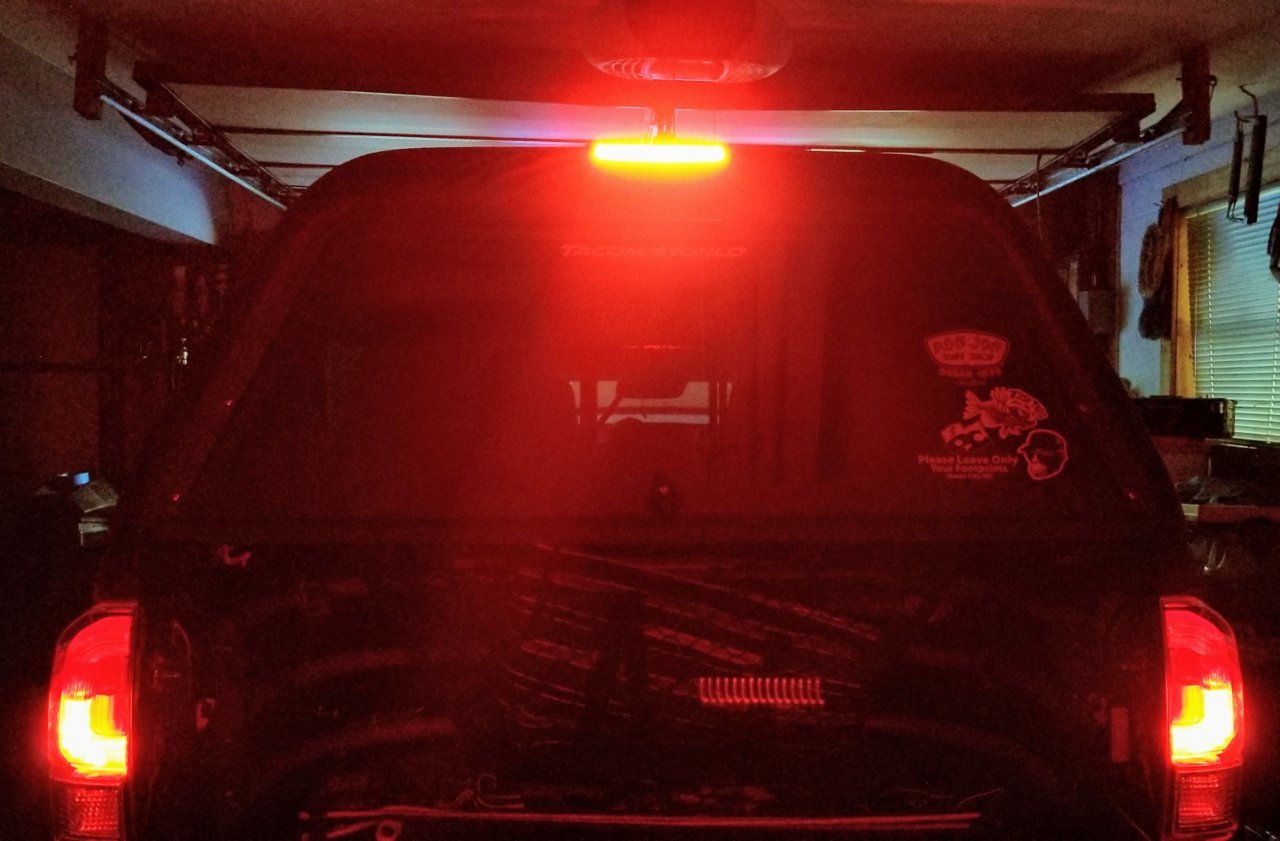

    I tried to get this done all by myself but I had to call in a pro, @Rome604 . He told me what I had already kicked myself in the ass for not doing first. And that is testing the light first. I had 4 splices/connections. One at the tail light, 2 at my weather proof connector, and one at the light. After checking each of first three connections and talking to Dave, I got pissed with myself and removed the light and tested it. So the bad connection was the butt connectors at the light. After redoing those I was good to go!
    Thanks again Dave :fistbump:
    Now I'm legal.

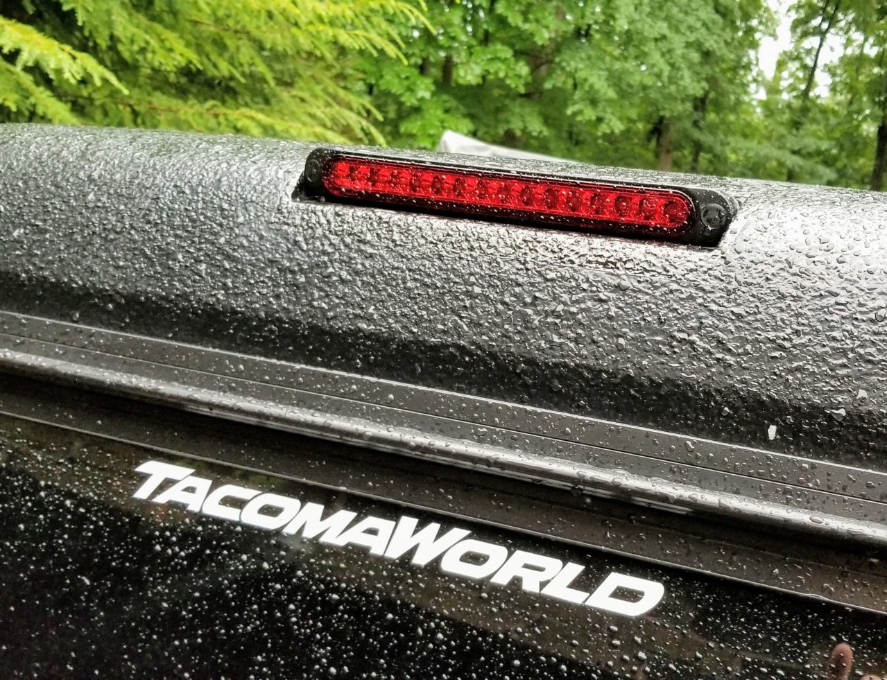

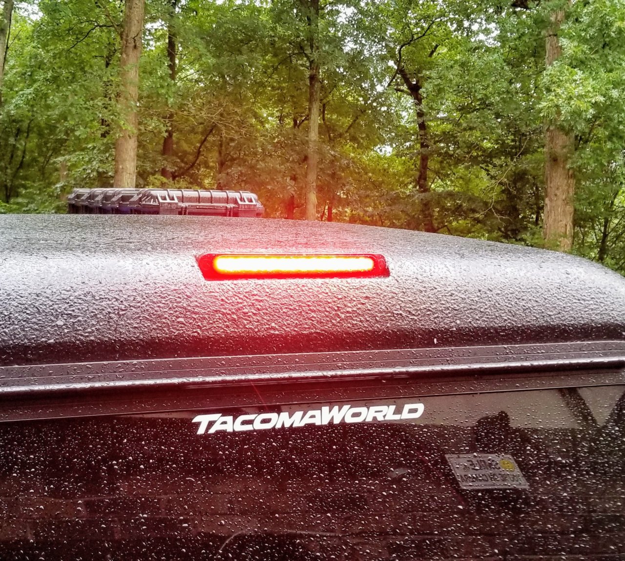

    I went out and checked for leaks after we got like 2" of rain in 5 minutes earlier today but it was all dry. I like how it's not a OEM cap light that fits perfectly in the recess. This is definitely brighter than the original light.

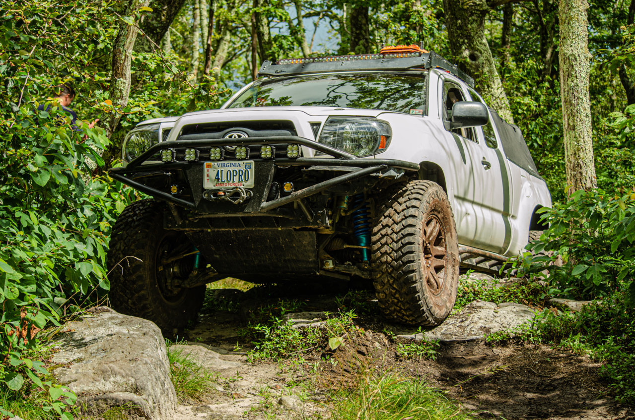

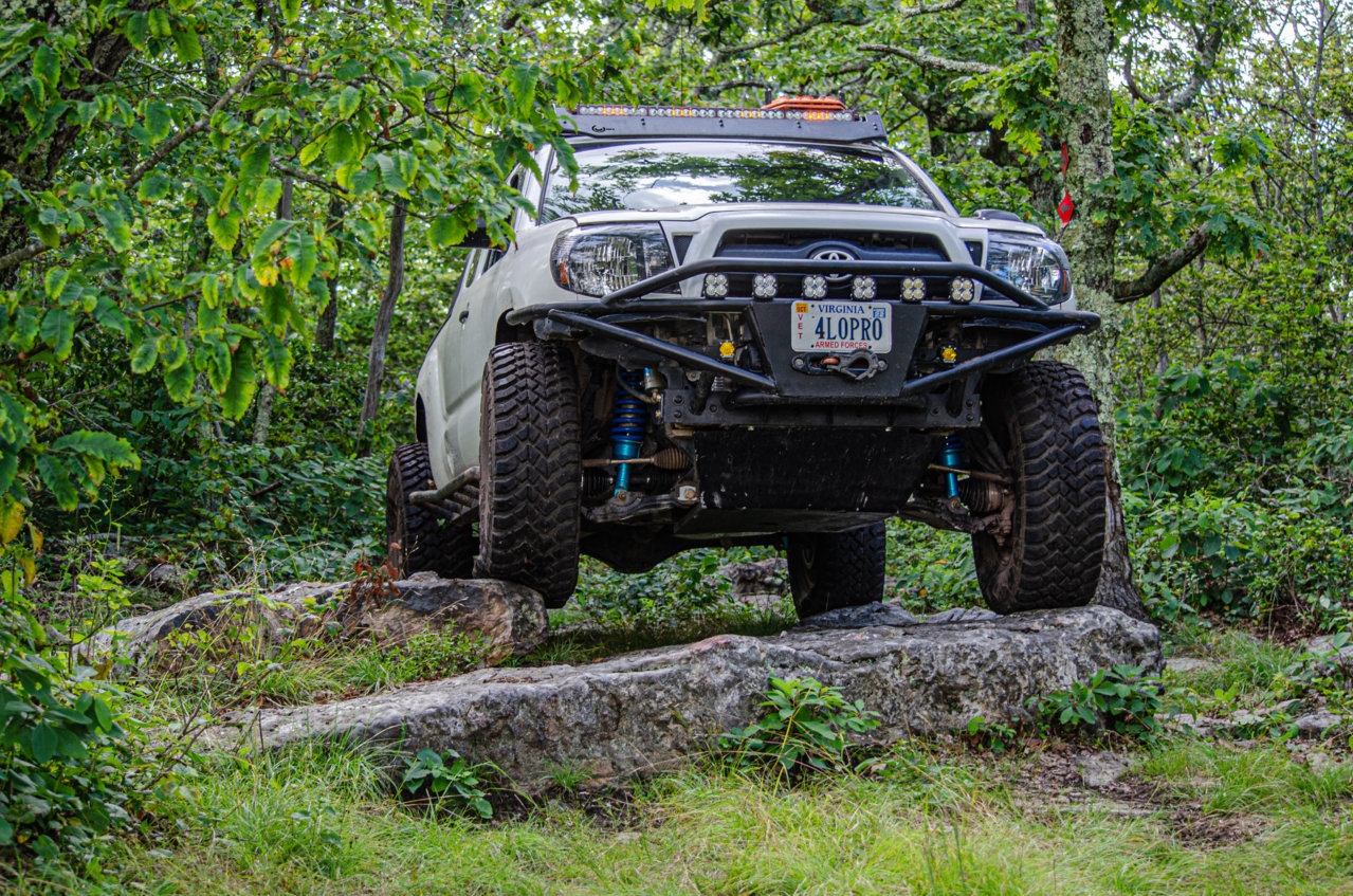

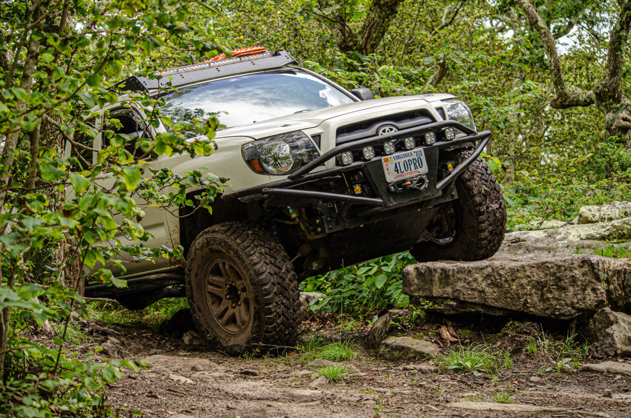

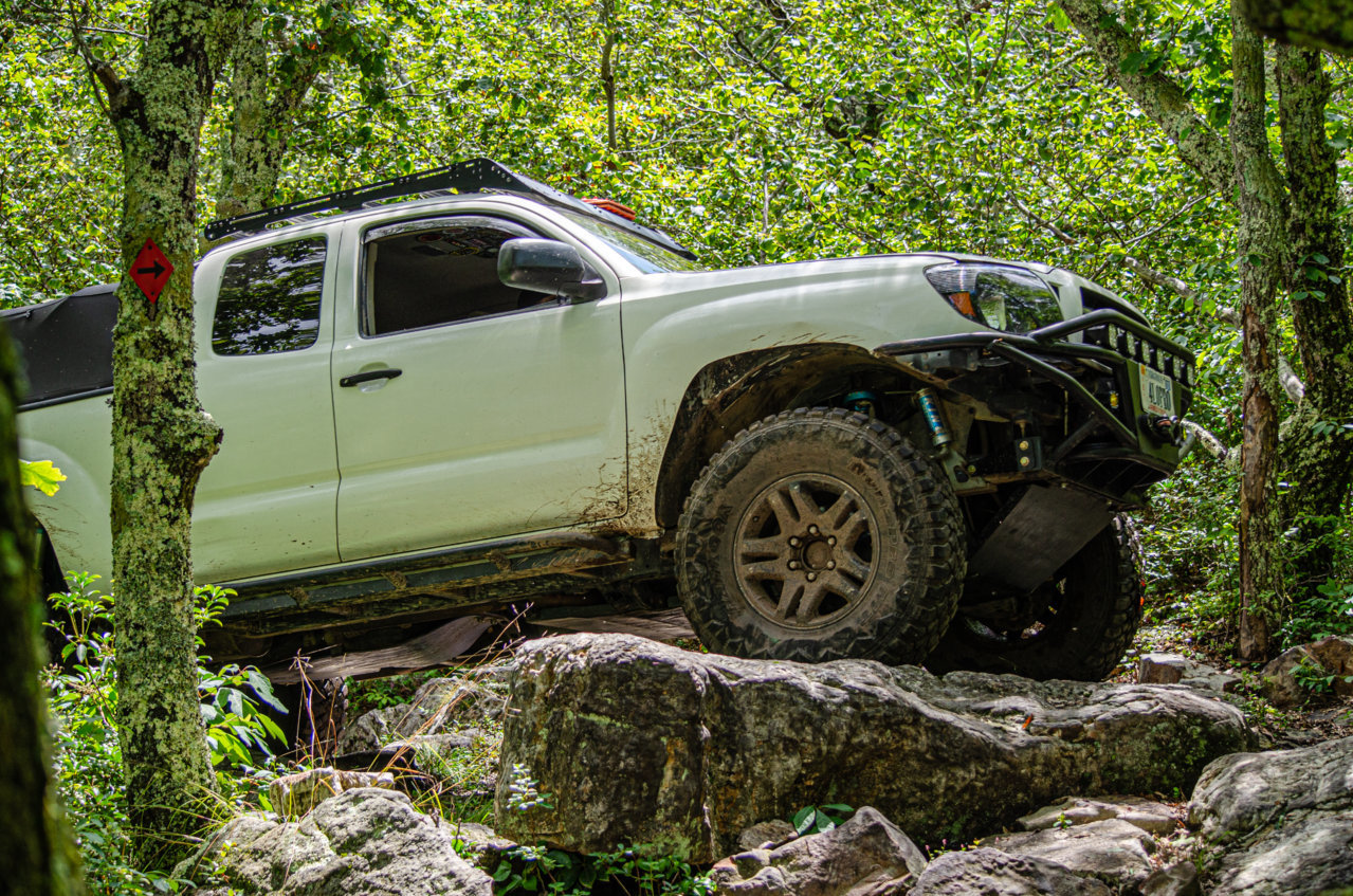

    Here are some of the pics Leslie took of me this weekend. Came out looking might hawt.
