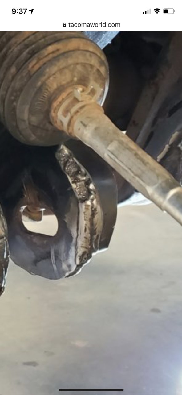

    These keep the cam tabs from moving while you're off roading which is what requires you to get subsequent front end alignments?
    Are these welded in place?

    You can still knock your alignment out of place with these, but at least you don’t have to worry about flattening out the tabs anymore.

    So these just prevent the tabs from bending? If they don't bend, can I assume they are not moving? And if they were bending before, were they moving to do that?

    The tabs themselves won’t move but the alignment bolts can still rotate on their own if you have a hard enough hit.
    with these new ones, it’s as simple as getting a new alignment.
    with the factory ones, you risk simultaneously bending the tabs and needing to fix that.

    The tabs bend first, then the mounts second.
    Steve at dirt designs can hook you up with lca mount gussets.
