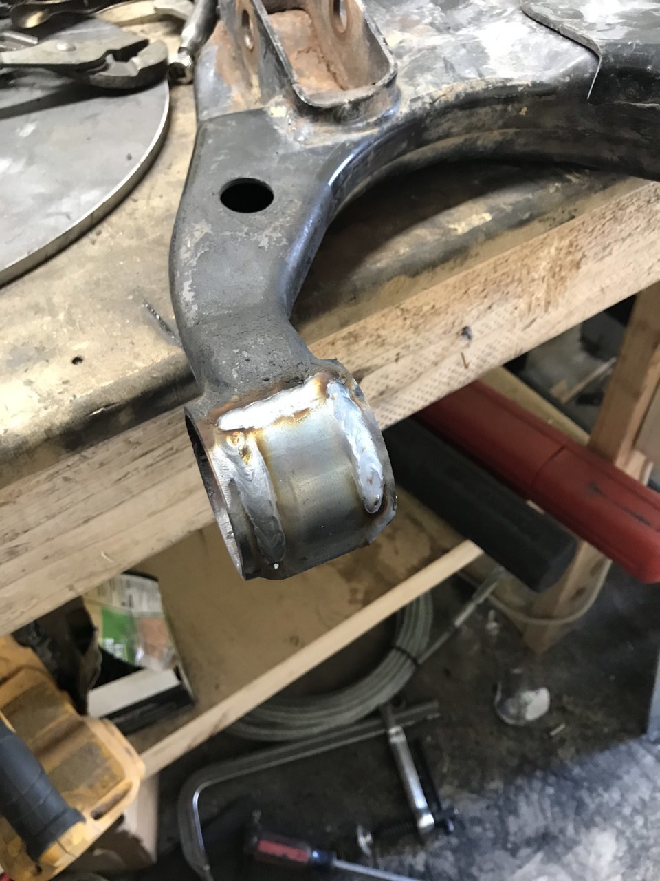

    If you know how to weld, I recommend reinforcing the lca eyes with some tube. I forget the diameter, but it was 1/8” wall. This is the most common place I’ve seen these lcas fail, the eyelet separating from the arm itself.

    I like that a lot. Good of time as ever to do it with them off the truck.

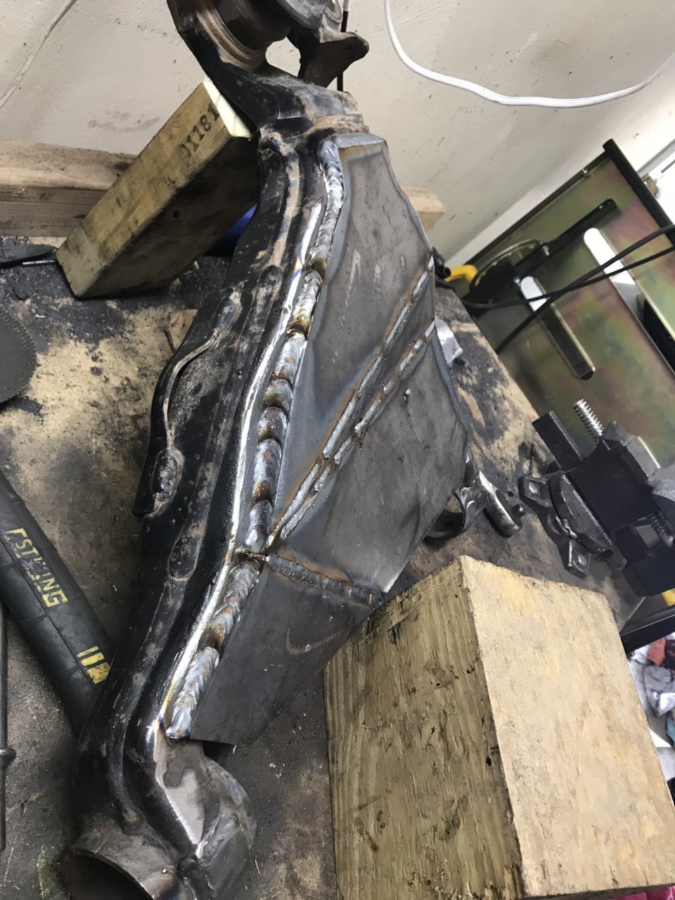

    Yep exactly, and the bushing out, otherwise you’d cook it with heat. I also plated the bottom of the lca with 1/4” but that’s much less a necessity. I just had the steel on hand so I figured may as well.

    You make those, bae?

    Yeah, sorta. All I did was take some tube, cut out a 2” sliver, then cut it in half. Wrap it around the lca eye and weld it. Why, you wanna pair? I have some tube laying around. Not 100% it’s the right size.
