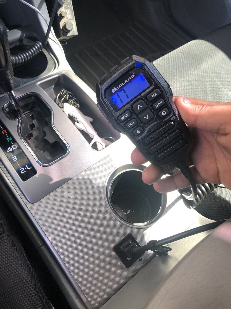

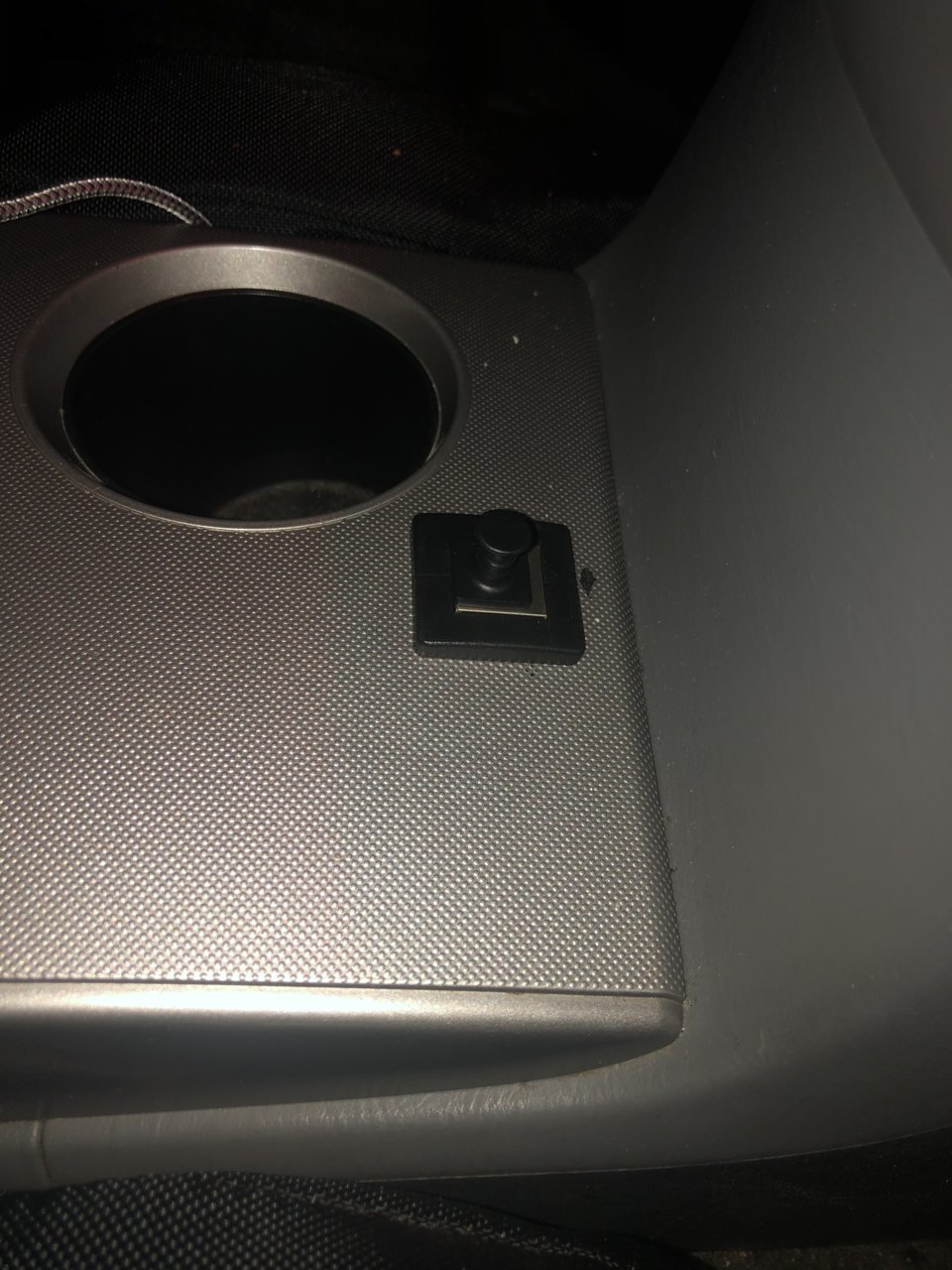

    I got my CAT5 extension in to complete my hidden comms set up. Came out pretty killer.

    Ethernet cable connection?
    Looks legit

    Yessir. Actually thanks to @fatfurious2 for the link to it. It works great.

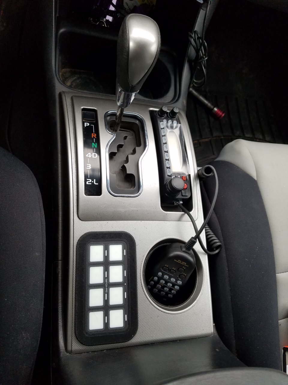

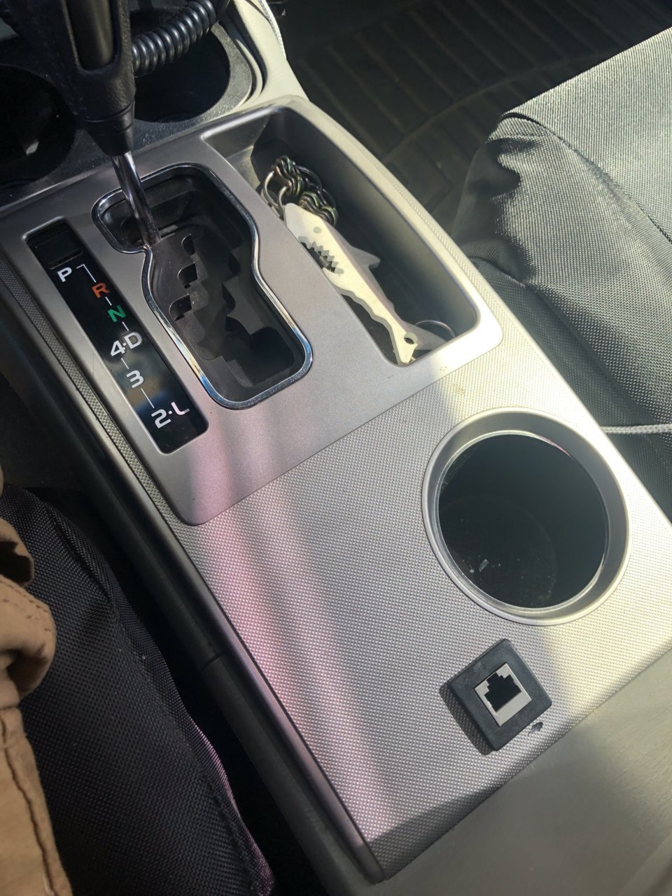

    That’s a great spot too. If I hadn’t just dropped $100 on a new cup holder insert I may have put it there.
    I have my background color as red.

    the "problem" with how I have mine, is that it can get dust/dirt in it. Thats why I have a plug in there. Vertical is better

    Ah that makes sense. I may put a plug in mine just because it wouldn’t hurt anything to have it protected.

    I have a plug, but I also have a random ethernet cable. So sometimes I swap them out. And then my passengers see a bare wire sticking out of my center console, and ask where it goes. (Could say the ejecto seat cable is broken :rofl:)

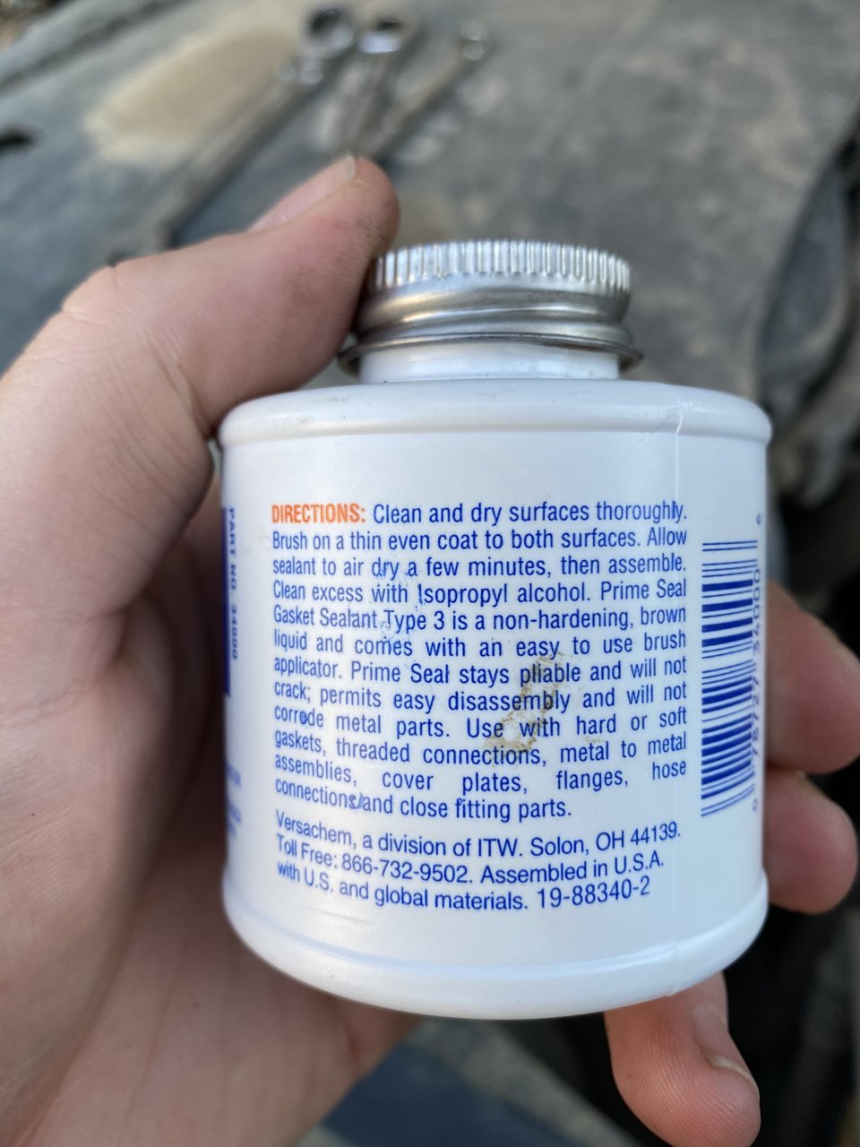

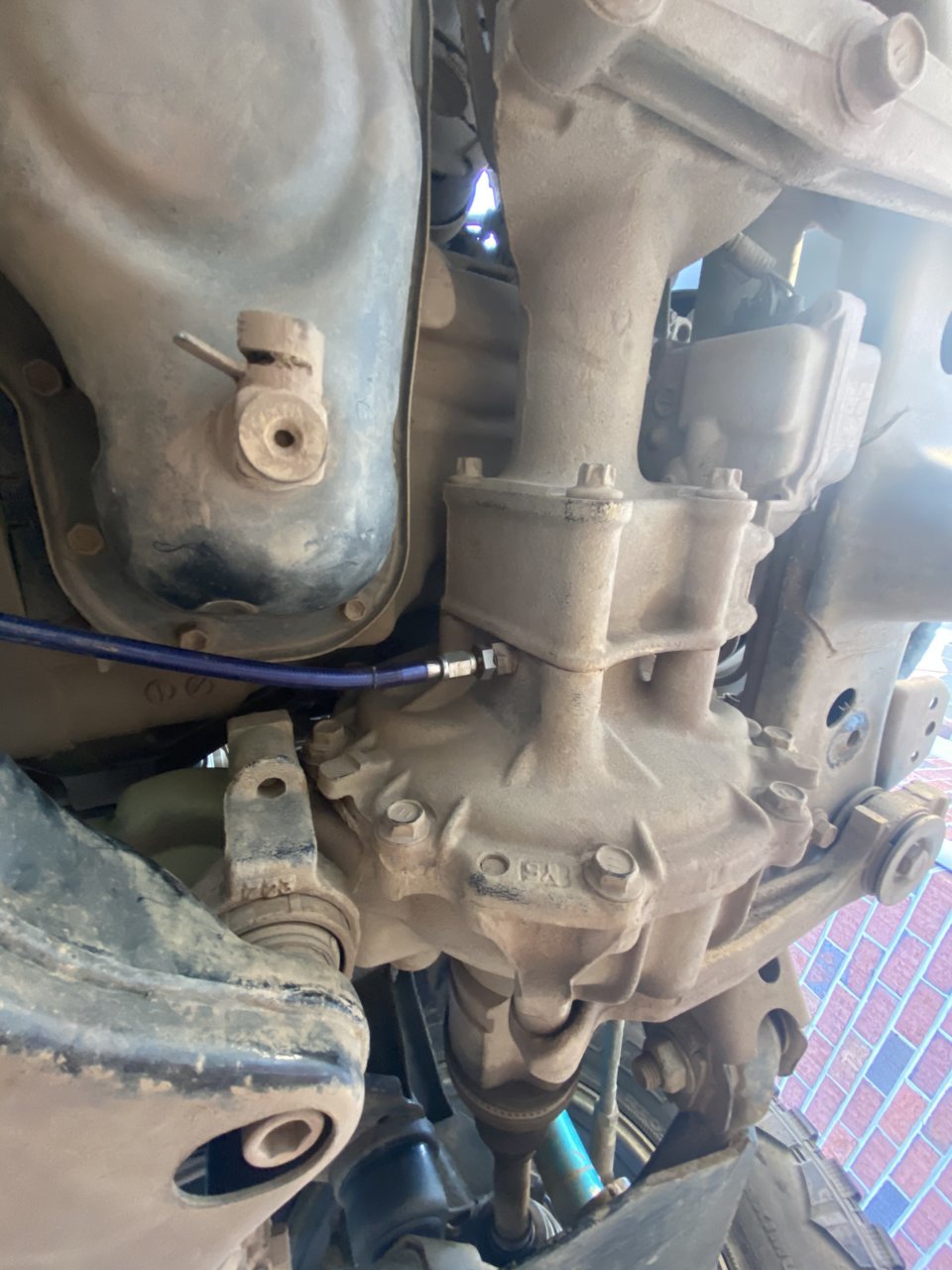

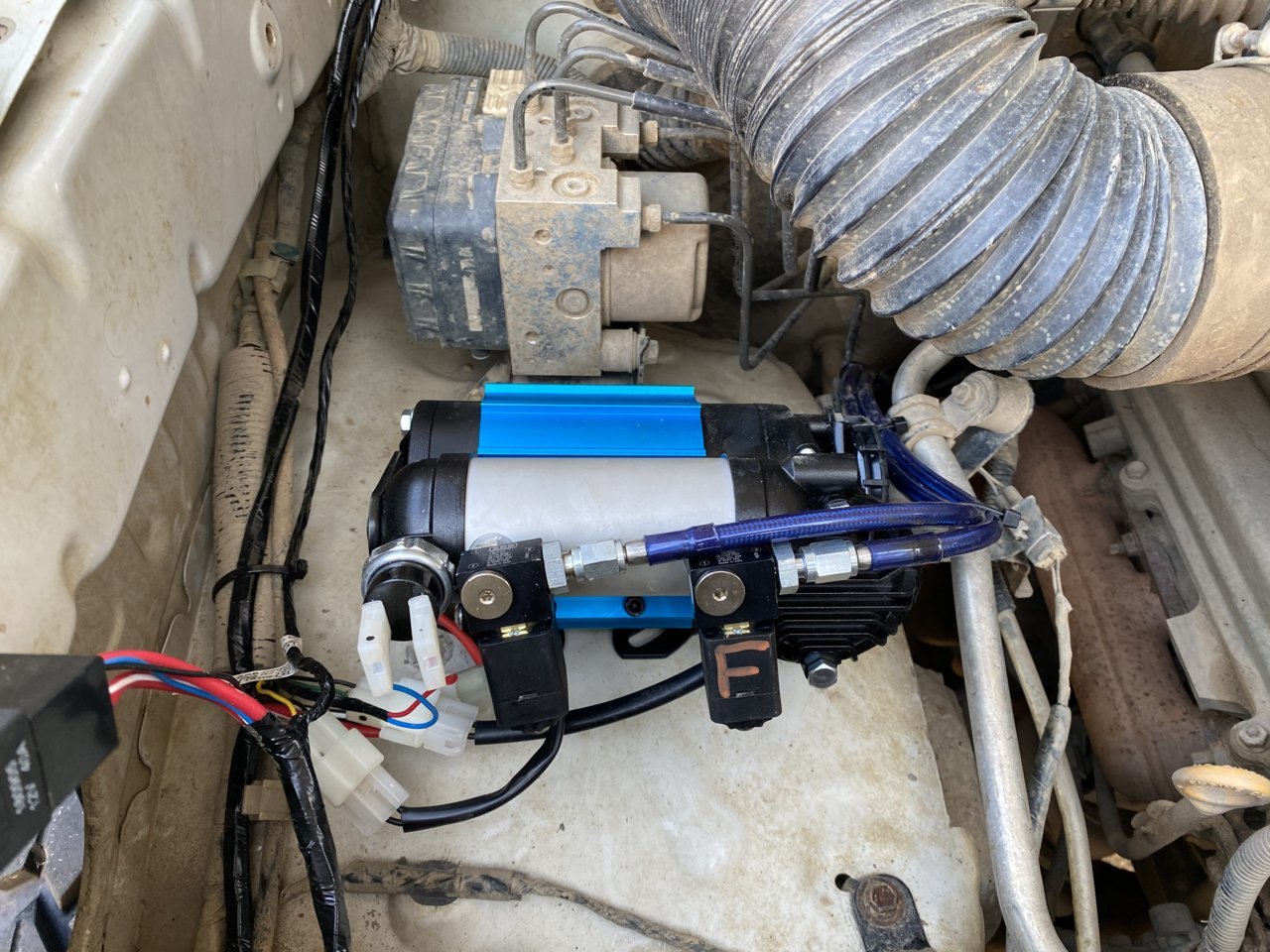

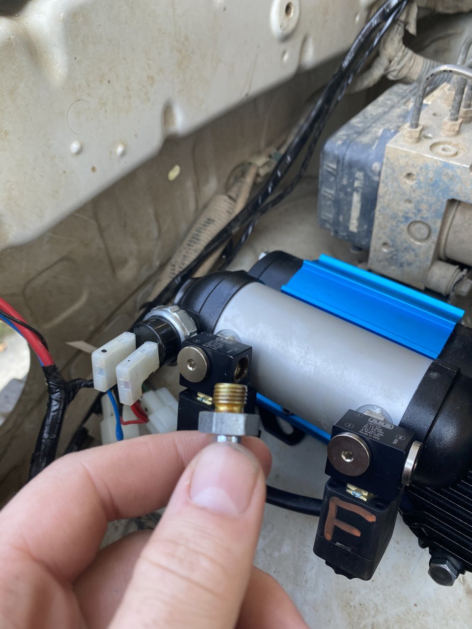

    Giving this stuff a shot on the stainless air lines. Unless I crank down on them, they leak at the fitting. This should work nicely though. I’ll let it cure overnight and check tomorrow.

    If that doesn't work, I think I have the right stuff out in the garage from my air suspension install on my Mustang. It was what all the "experts" recommended. Can take a photo fer yous.

    Thanks. What I’m doing now too is stealing the O ring off the arb fittings and adding those too. This thing should be solid now.

    Well it’s all buttoned up. I’ll test for leaks tomorrow because I want to let it cure overnight.

    You're just saying that because that's the only clean spot on the entire undercarriage!!! Yay daily driving on dirt and muddy road!:mudding:

    Are there any more ports on the manifold?
