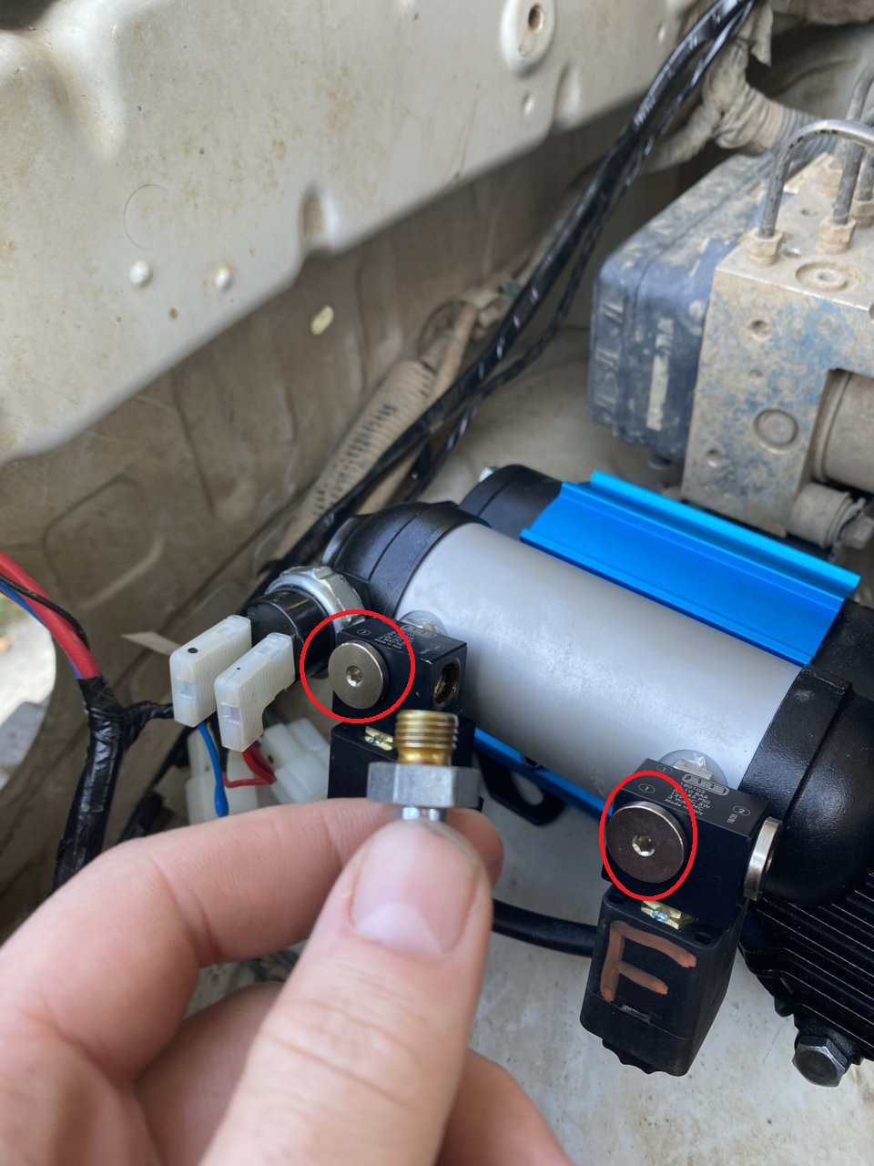

    No, just the three. I thought this was a flaw in design because I was wondering where to put my air hose QD. These come off though and are a straight pass-through to the manifold. I'll remove one and put a QD there.

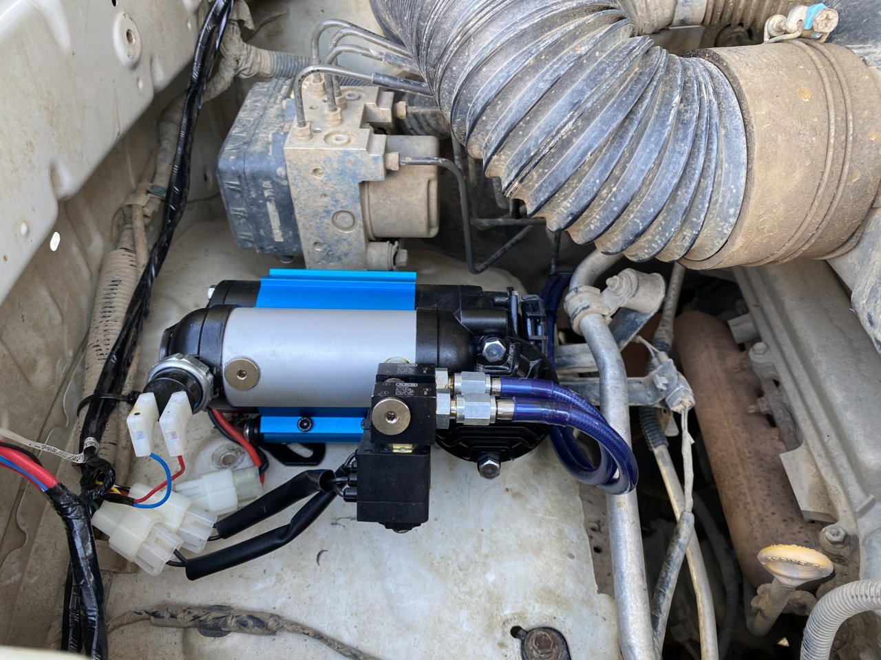

    Also, now it's leaking where the solenoid enters the manifold. I didn't put any sealant there so I'll do that later. I'm glad I'm getting this all worked out now and not discovering it on the trail.
    RobP62 and Greg.Brakes.Tacos like this.

    That was exactly why I was asking. That's just odd they didn't put another port on the other endcap. For me, it probably won't ever be a big deal because the chances of me getting a front locker are extremely slim, but it's nice to be prepared.
    You're starting to learn why I'll never do air suspension on a car ever again. It's a good idea to seal everything. That's how I ended up with the crap I was talking about earlier. I was using Teflon tape and some of the fittings had stuff on the threads already. Still leaked. I ended up removing every single fitting and putting that crap on it. No more leaks. It took a while to get it to the point where the tank and bags would hold pressure over night. Fortunately, you won't really have to deal with any of that gar-bage.

    What I may do is just stack the solenoids on top of one another. They say it can be installed either way and my QD won't be putting stress on the solenoid with a hose attached. Idk, I'll see how I want to tackle it. I'd rather not undo the fittings that I just sealed it. I imagine it'll be gummy and a pita if I have to but I don't think there's any way around it.

    My Spidey-sense says to stack the solenoids. I don't have any other explanation than that. You could wire wheel the fittings clean?

    It says it's non drying, and yesterday I was using xylene to wipe up the excess with ease. So I'll likely undo them and clean them up with a q tip/toothbrush and some xylene. That should get it good enough. I'll listen to your spidey sense since I was leaning that way as well. I'll tackle that later.

    One more leak to track down. No leaks up here and none at the back diff, so it has to be my connection to the front. About to drop the skid. I still had to crack the fuck down on the fittings, more than I was comfortable with, so who knows how much this goop is actually helping.

    Well this is not good.

    It’s definitely more of a pita than I was anticipating.
