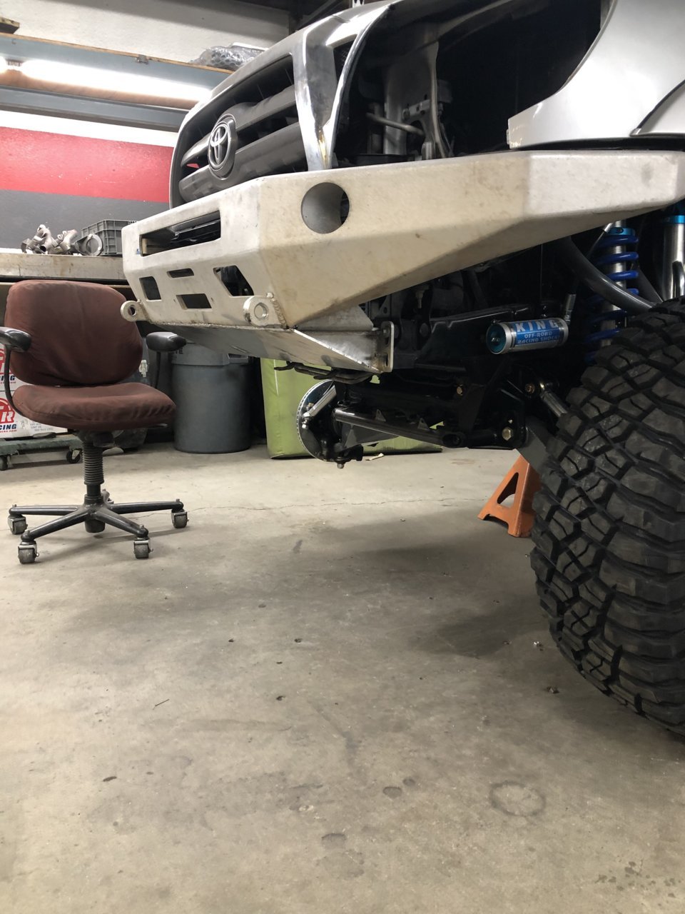

    Seeing this plate bumper modified to be tucked up where mine's at makes me want to redo my bumper out of plate. This looks so clean.

    So I built my current bumper around my winch, the smittybilt XRC 9.5. I built this bumper to be tight as fuck. I'm replacing the winch with a warn and I have no idea if it'll fit in there. If it doesn't, then I'll build a new bumper that'll fit the winch*.
