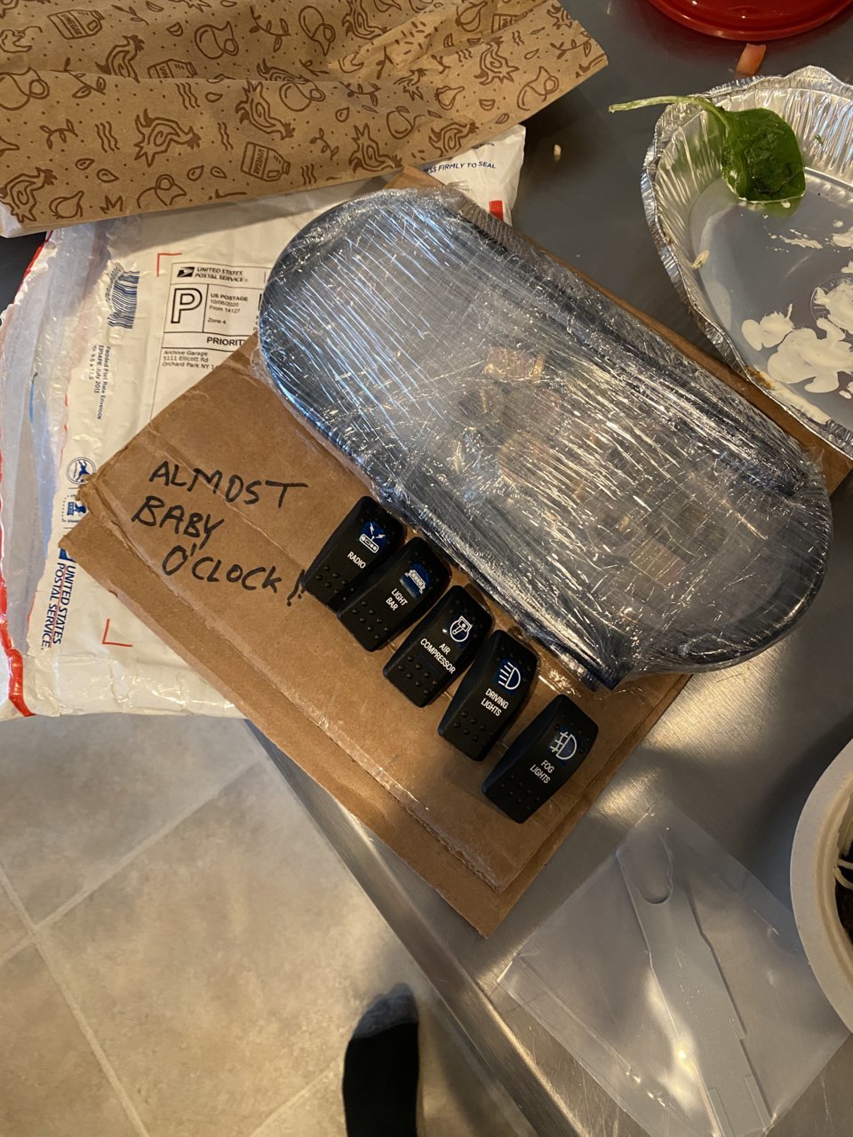

    Just the covers. It’ll be nice to not have to remember what each switch does. And I thought that was a nice touch from Eric at archive.

    Oh. Hell yeah. Thought the wife had written it.

    Nope lol it was a cute little surprise.

    I swapped out my lenses this morning. Incredibly easy with the removal tool. The downside is the color is a little different between the compressor and locker switches, so I’m going to order new covers for those.

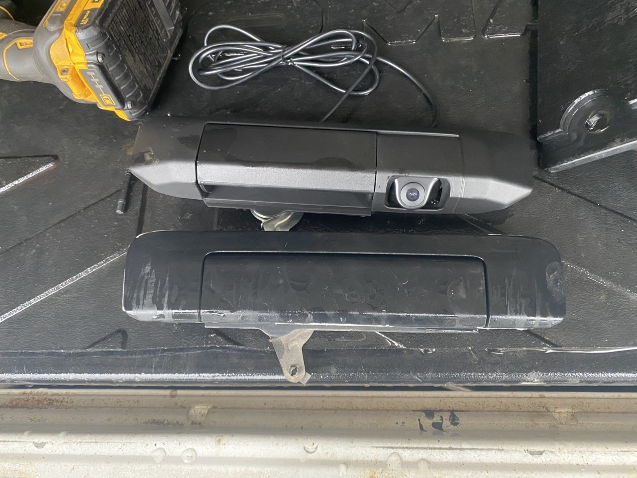

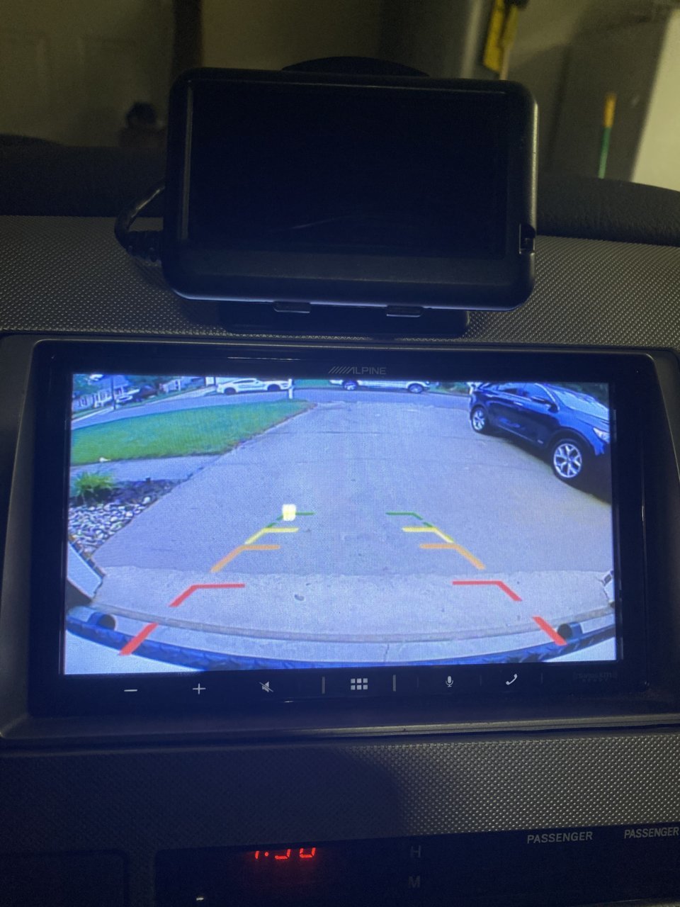

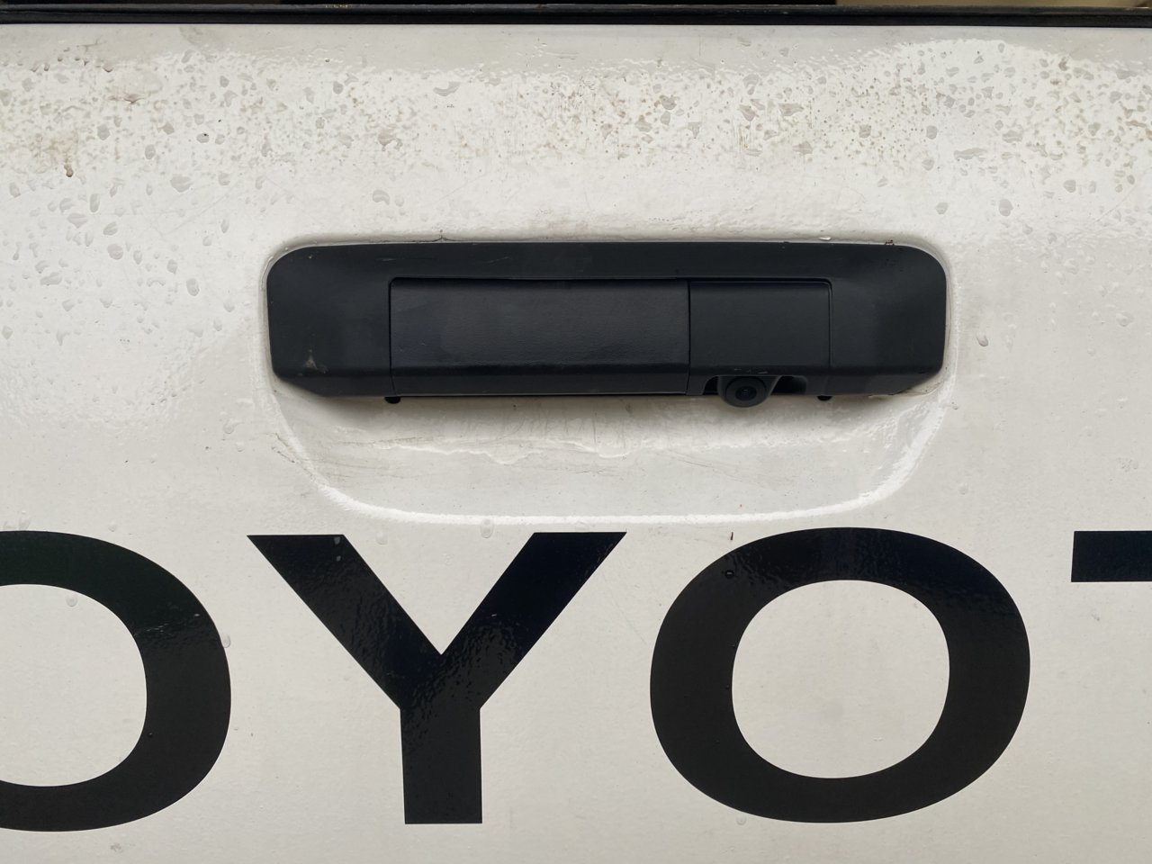

    Man I’m talking to myself today. I got in my backup camera. I wired it in so I can view it in reverse or just by selecting it on the head unit.
    My head unit has a 'reverse trigger' wire, to tell it when the truck is in reverse. Under the drivers kick panel, this wire is what runs to the rear and feeds the reverse lights. I tapped into this for my 'reverse trigger.
    The camera itself has a + and -. I tapped into my head units wiring for that. So the camera will always have power when the truck is on, and because of the 'trigger wire', the head unit knows when to display it on the screen.

    The picture is pretty darn clear!

    I’m extremely impressed at the quality of this kit for only $80

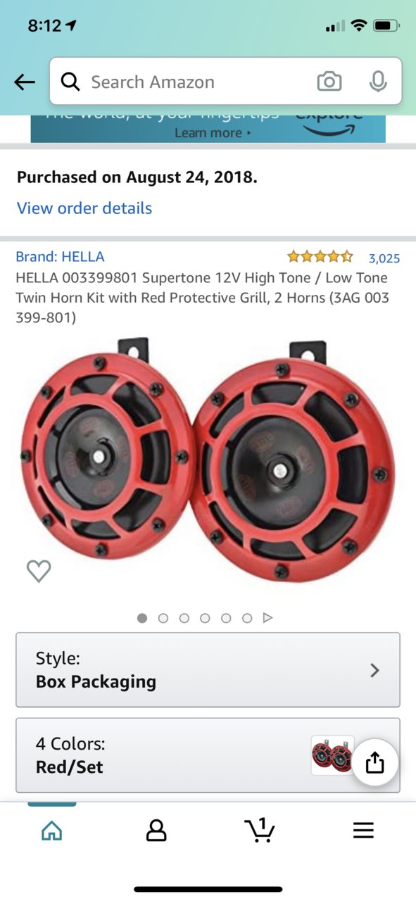

    Some cock sucker changed lanes into me today, almost causing me to pit maneuver them. They did it intentionally too, expecting me to hit my brakes. Pissed me off to no end but I stayed the course with my prego wife in the car. I leaned on the horn but it was wimpy. I’m thinking 3 pairs of hella super tones because fuck you and everyone around me. The price has jumped though since I last checked at $40 a pair.

    Are those the ones bartmaster sells?

    I don’t know who that is. Is that the Cadillac horns? I’m talking about these.

    Oh, yeah. I guess he does sell Cadillac horns. Sorry.
