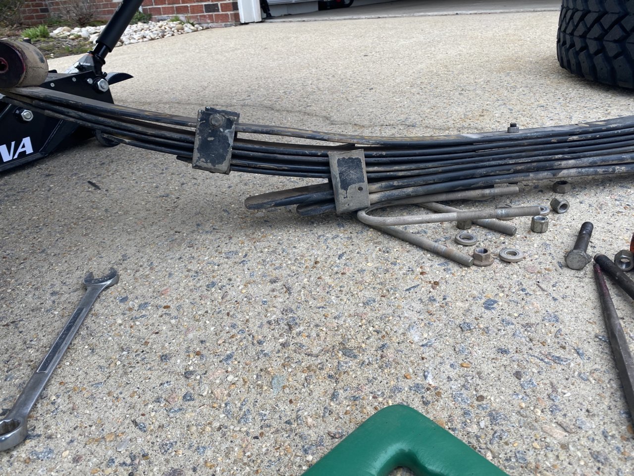

    What was wrong with your Dakars? Mine suck. I hate them.

    This. They still worked fine, but they rode stiff which is why I switched to the Icon RXT. Then it dawned on me to at least reach out to ARB to see if they'd warranty them, and here we are. So I'm giving these away for free (already have a new home).

    Mine squeak (actually creaking is a better way to describe it). Unless I constantly keep them lubed they make a ton of noise. I wish they would warranty them for that.

    I've never really had an issue with that but I kept the bushings regularly greased and only used a dry lube in the leafs.

    Attached is the official pdf from ARB on how to mitigate the squeak.

    I jack up the rear of the truck getting them to droop all the way out and use this in between the leafs as best as I can get it. I even put it all around the bushings and mainly focus on the pads in between the leafs. It stops the squeak and usually needs reapply every 6 months which isn’t too bad in my opinion.

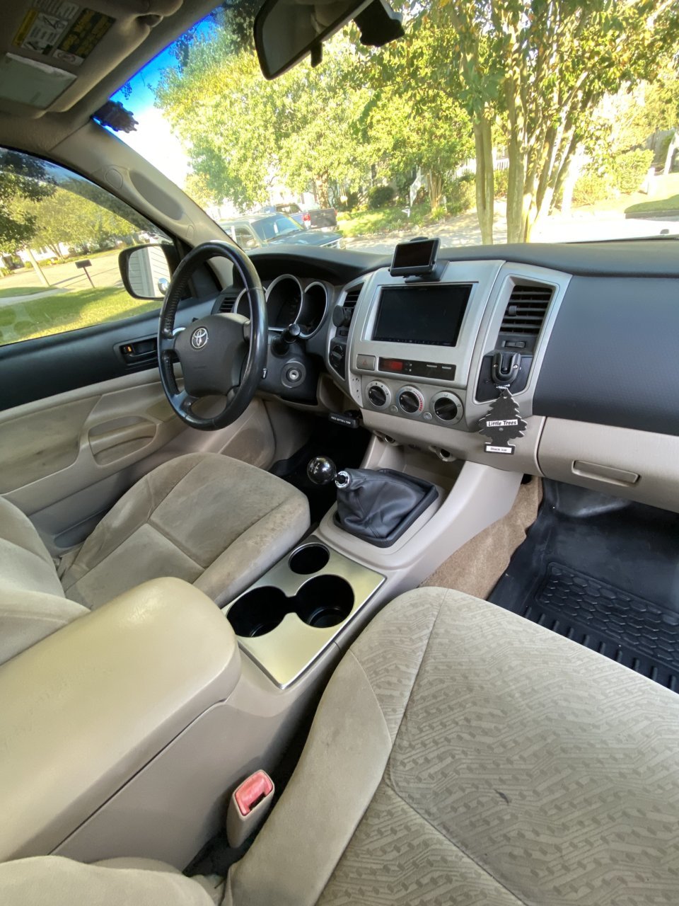

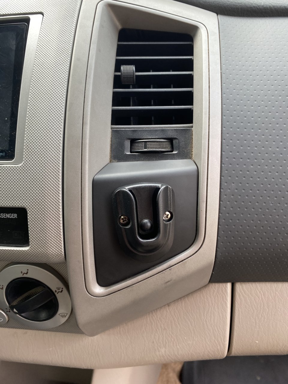

    My exciting mod for the day. Ordered the double cab version of this piece which is blank. In my access cab it has a hole to turn off the passenger airbag, which I’ve literally never done. Moved my mic holder to this because it looks a bit cleaner without the writing poking out from behind it.

    This is the before. You can see it not centered and the wording beneath it if you zoom in. I broke the piece recently removing it and figured that's as good a reason as any to make it look nicer.

    I like mods like this that are big on return, and little on thought or effort. :thumbsup:

    My 63s squeak too but I just have to make sure the grit and grime gets cleaned out from between the leafs my deavers were the same way. But my front end sounds like the red light district in Vegas on a busy night.
