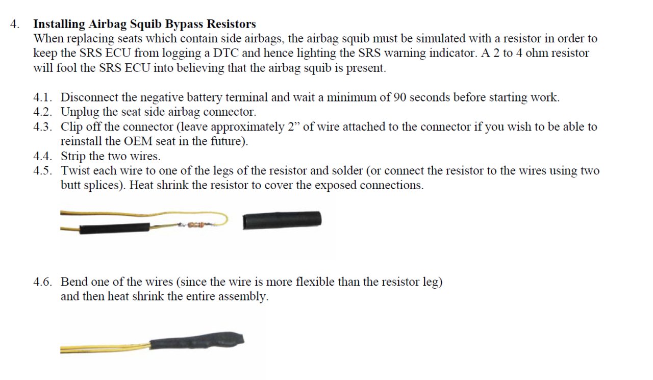

    What would you have to mess with as far as the airbag stuff

    There are airbags in the seats themselves on anything newer than like 07ish. So you obviously just can't leave them unplugged because your airbag light will be on. I don't know what all it entails to put aftermarket seats in a newer truck.

    A resistor is all that would be required to turn the light off as far as I know.

    I found this in the install instructions. So that answers that.

    Ah gotcha yeah you and I don't have to worry much about that stuff then. I didn't know if there was something with ours that may have issues.
