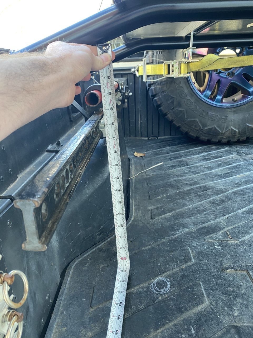

    Nope, but I'll keep an eye on it. It's a fairly light set up. 95lb tent and 30 lbs of bed bars.
    edit: the rearward bar would be very easy to tie into the frame since the bed bolts are directly beneath it. Maybe I'll tie into the frame right there to add rigidty near the bobbed portion. The front of the bed is a lot less susceptible to spreading I'm sure.

    I just have some recollection of you saying that you’d recommend tying a RRT to the frame in a bobbed bed.

    I'd mentioned it before, and I probably still should, but I have to validate my decisions and change my stance :cookiemonster:
    See my edit above though.

    Circle is the bed bolt. I can have a tube come straight down and some 1/8 plate with a hole that’ll grab onto the bed bolt. Easy peezy and no bending. Should only take a couple of hours to add.

    Make some corner gussets for the front of the bed like ATH makes I have them and they suprisingly added a lot of rigidity.
