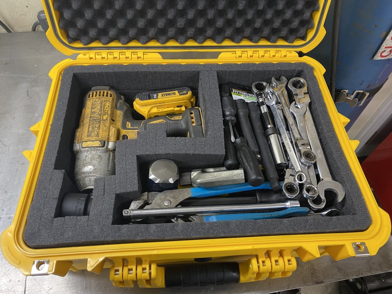

    I need to get a little more organized and will tweak some things but the proof of concept worked nicely. Now I have a waterproof container with the essential trail repair tools.

    Between the case and tools it was only like $200ish for all this I think, though I didn't really keep track. Not including the impact of course.
    This way I can tackle pretty much anything suspension related, change a CV axle, and remove spark plugs in case of hydrolock scare. Of course there are always more tools to be carried but this should cover almost anything I'll encounter on the trail.

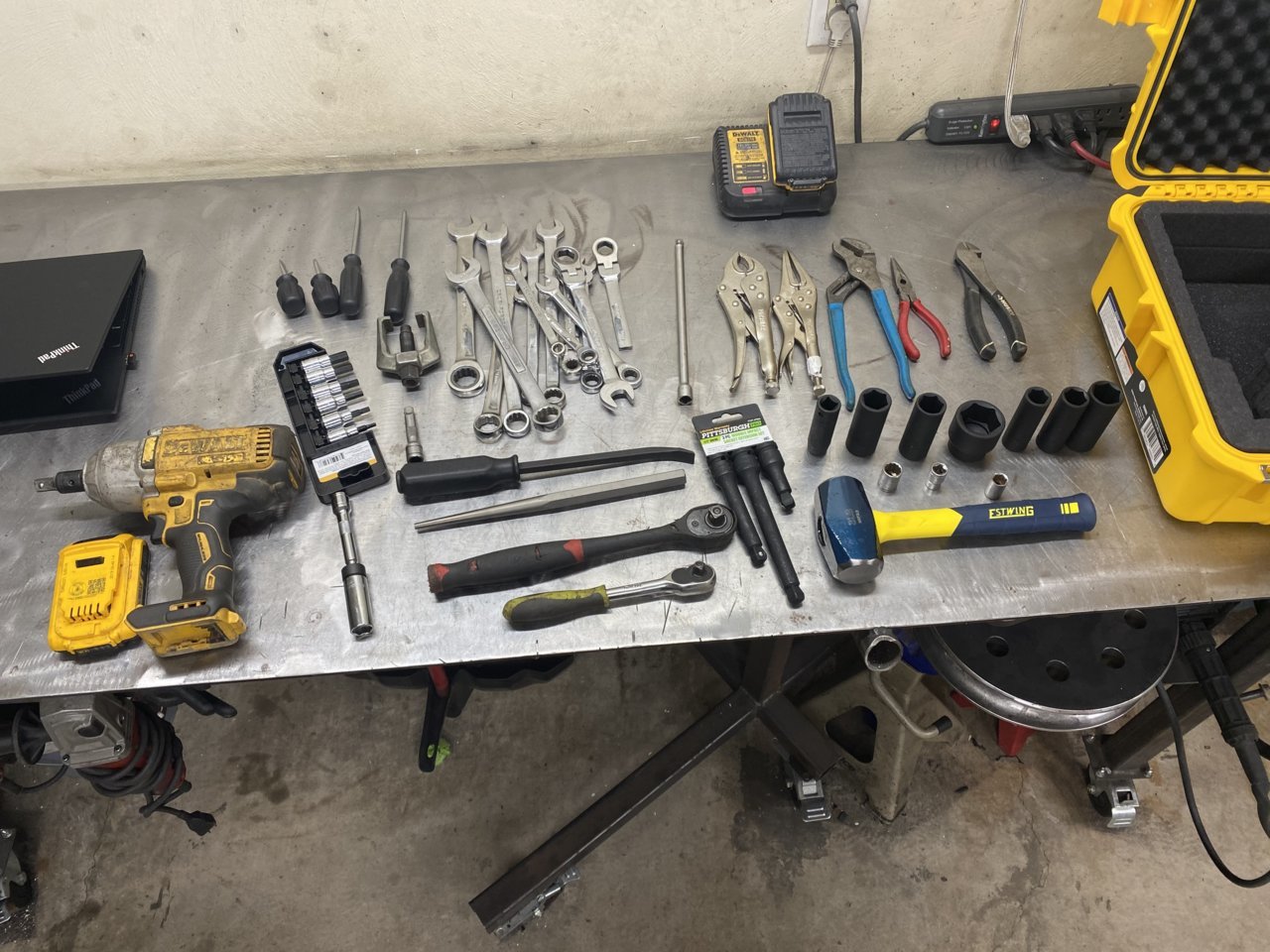

    To add to this, I only have essential sized wrenches and sockets. 10,12,14,17,19,21,22,24 wrenches and sockets and a 35mm socket for the cv axle. And two of each wrench.
    I also added electrical tape and zip ties as well.

    I've been slowly widdling down my truck tools and I'm hoping this will cover the bare essentials based on my previous adventures. This would have contained all the tools needed for all my previous trail fixes.
