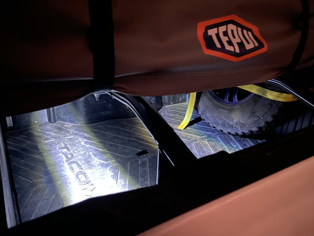

    I finished wiring in my rigid chase light. It took me awhile since there’s so many functions, but it’s done and I’m happy with it. I didn’t need this courtesy light or the strobe chase light, but might as well wire them up. Not the brightest thing but will provide at least some light.

    Now you can see stuff in the bed, and the purple wheel tucked back there!

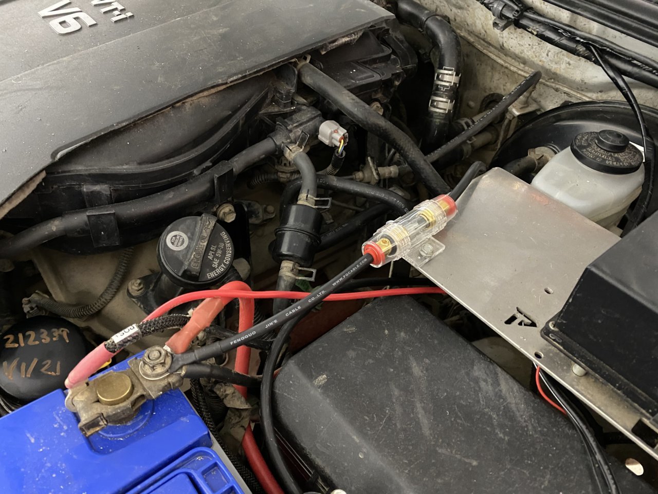

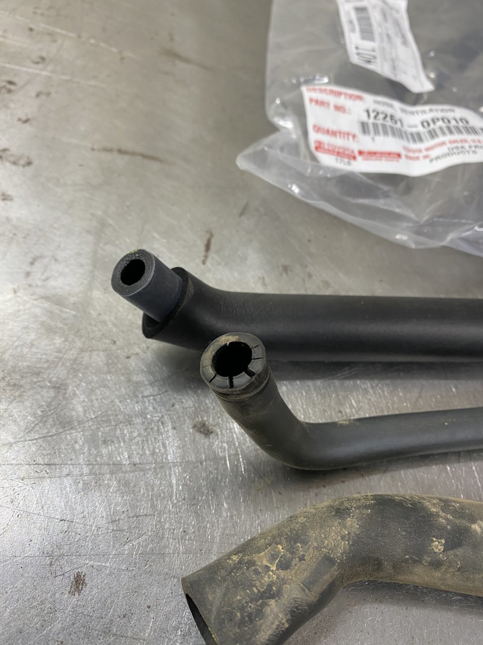

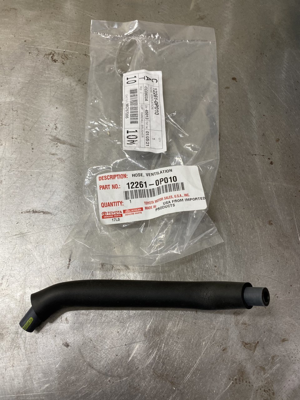

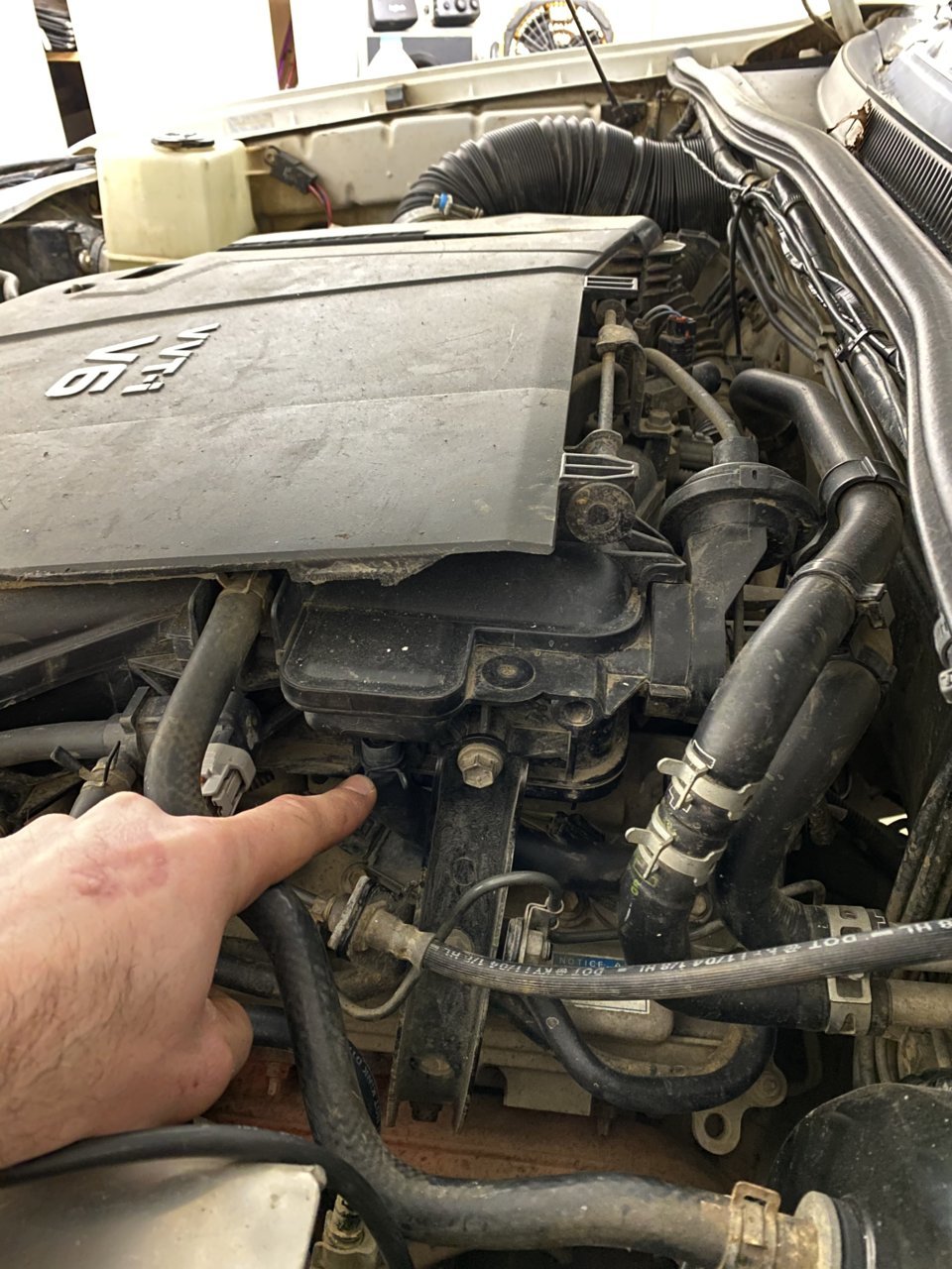

    When I was changing my spark plugs I noticed this vent hose was cracked, so I replaced it today. I also fused the 8 gauge wire for my solar panel. Didn’t want to burn ol betty white down.

    Darn PCV hose. Good catch before it got bad

    It was cheap and easy to replace so I figured I might as well. At some point I want to give all the hoses I can see a once over to check for cracks. Try and catch anything before an issue arises.

    I hear ya. I’m just glad the location of the 2nd gen PCV valve isn’t in as stupid of a location as it is in the 3rd gen.

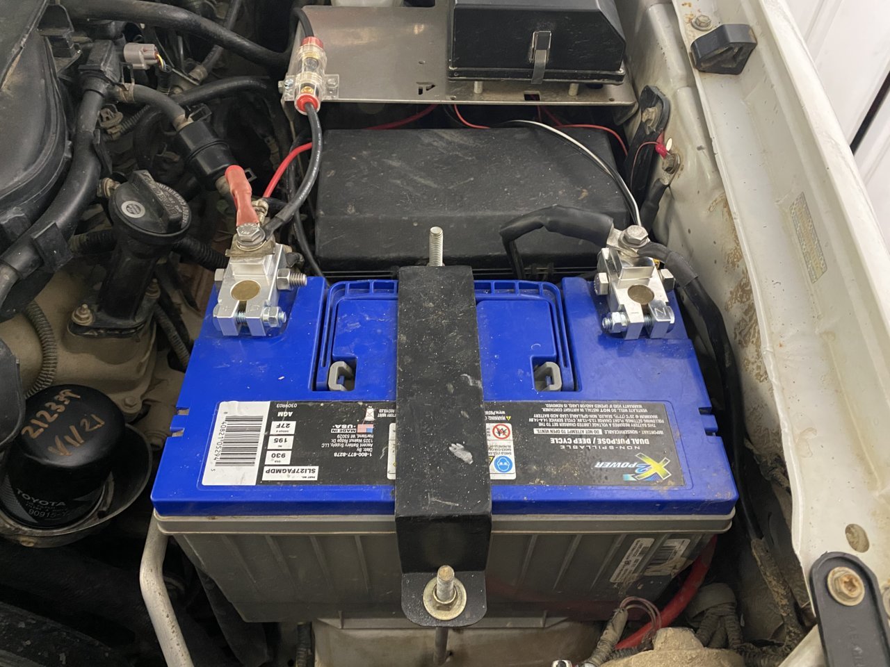

    Installed the sdhq terminals real quick too. I’m impressed with the quality.
