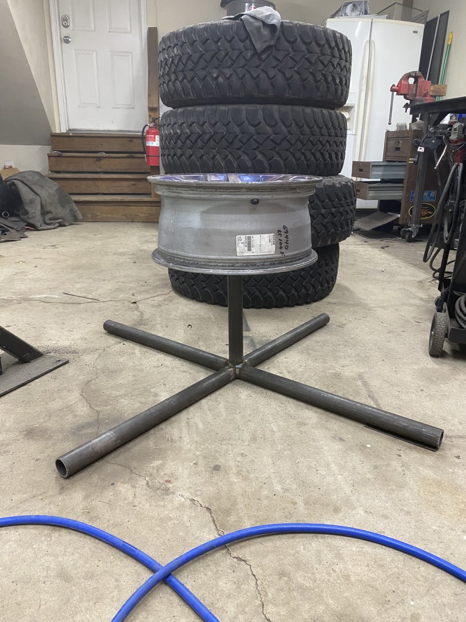

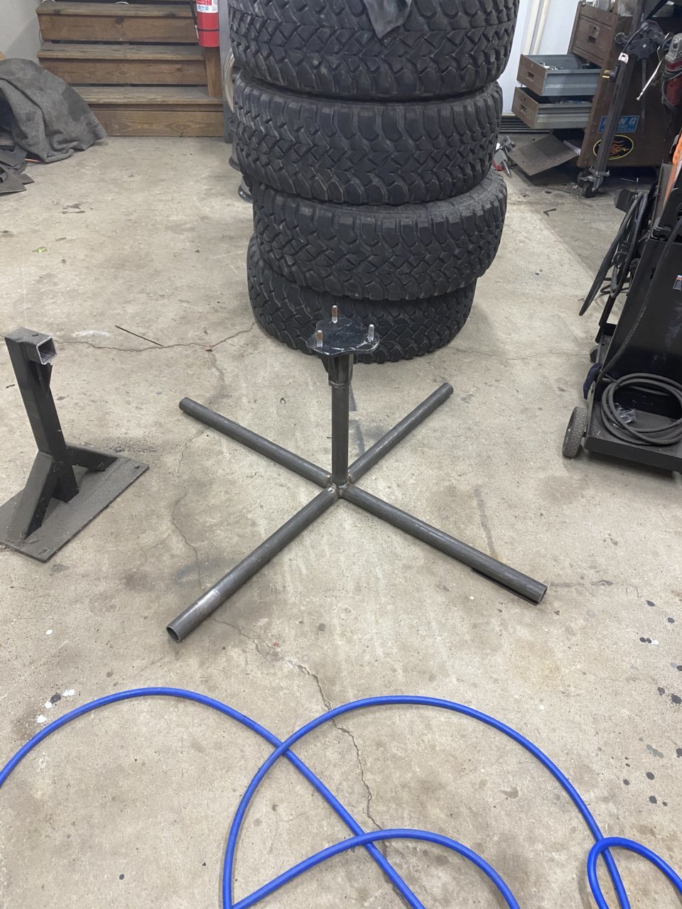

    Whipped this up in about 40 minutes to hold the beadlocks while I wrestle on the tires. This should be a nice improvement over resting it on an upside down bucket.

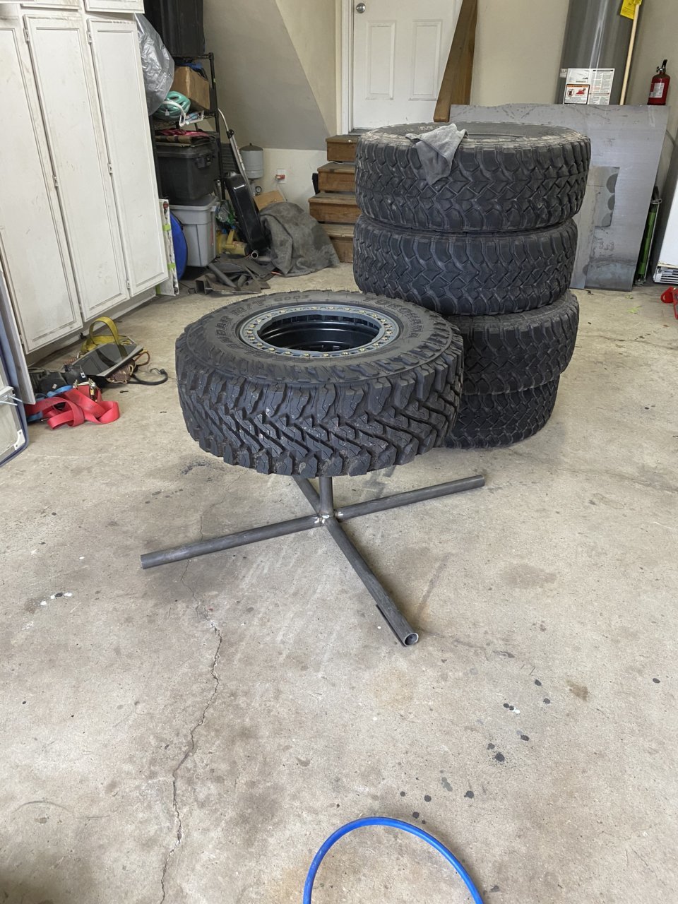

    These beadlocks are proving to be quite the worthy opponent. I removed the ring on one of them and attempted to dismount on my own. I made zero progress aside from removing the ring. Went to a tire place and asked them to dismount but they couldn’t without risk of damaging. I have a few more tricks I’ll try tomorrow and then head to a place that specializes in custom wheels. If that doesn’t work, there’s an overpriced off-road shop that may be able to do it.

    On the plus side, my little stand works fantastically.

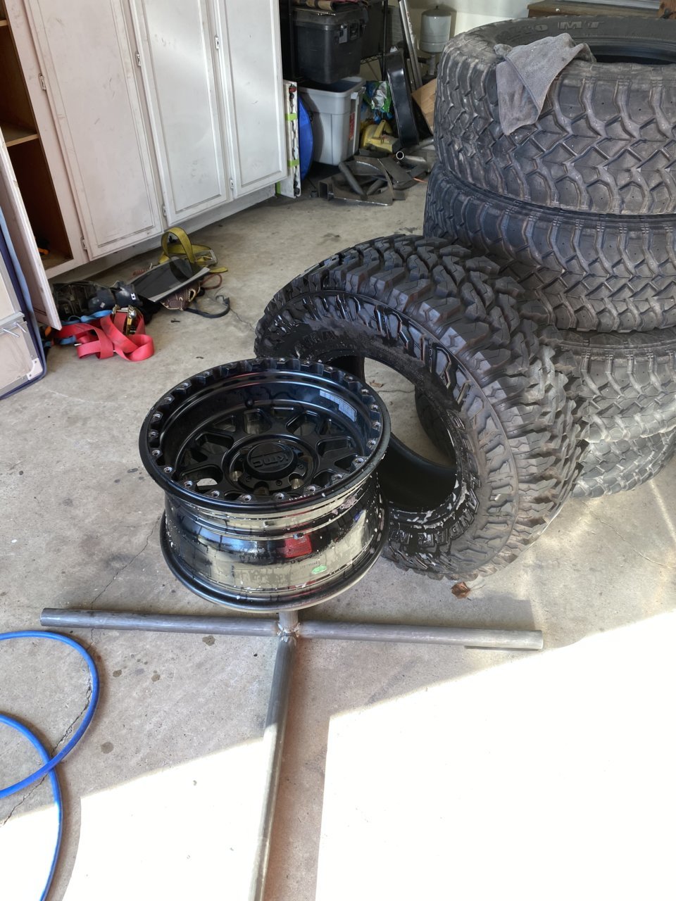

    Ok, beadlock status update for those following along at home. Gonna fuck around more with the hi lift tomorrow to get the rear bead broken. Now that I have a better understanding of the design I think I can manage this alone.

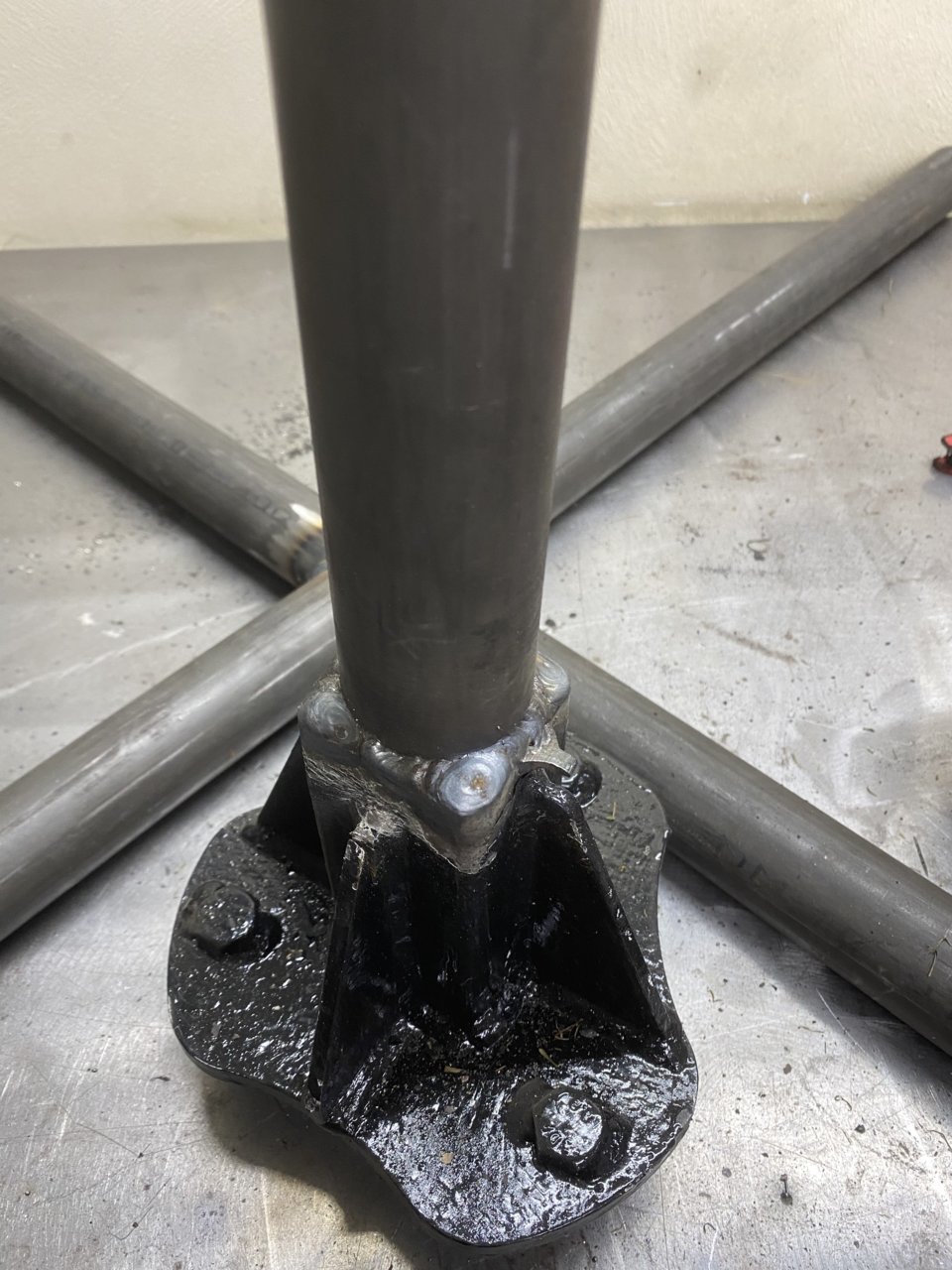

    It’s not unfortunately. I finally repurposed my old swingout. Cut off the mounting plate, slipped in some tube and welded it solid.

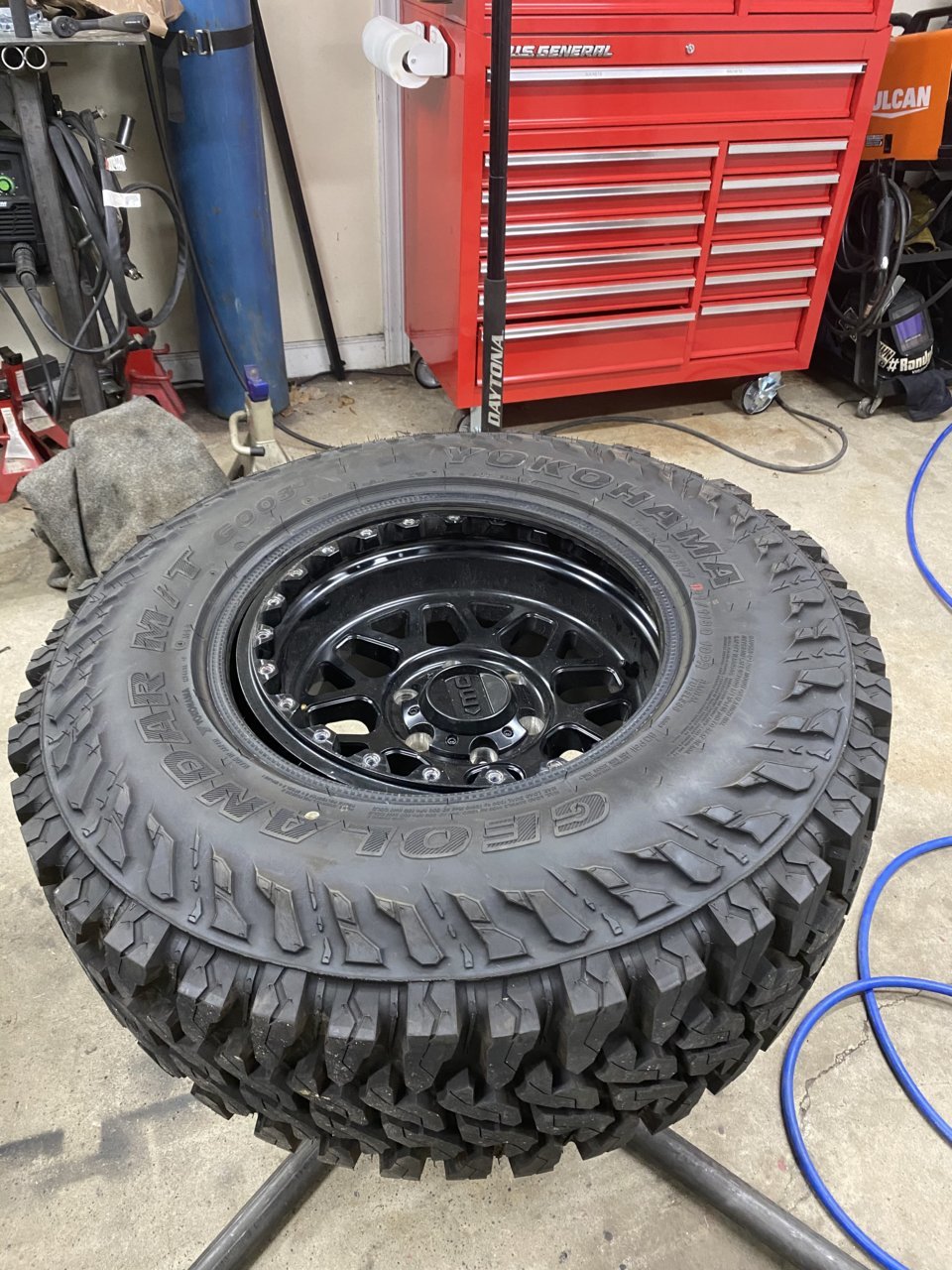

    WHO’S YOUR DADDY YOU FUCKING TIRE.
    20 minutes of painstaking hi lift action, working my way around the rear bead to break it free. Then all of 5 min to remove the tire and put my hankook on.
