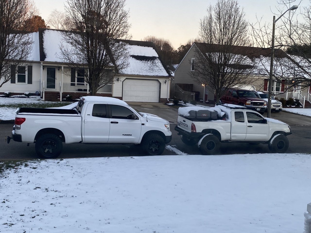

    Hi there stranger!!

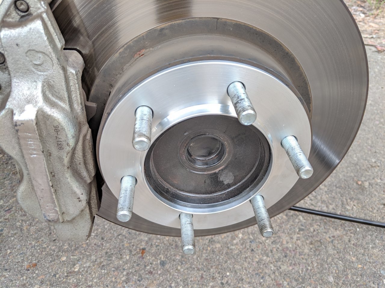

    Were you still rubbing the shock with the new wheels?
    You can get some extended studs from O'reilly's pretty cheap. I'll see if I can't find the link someone posted but it gives all the specs of the knurled end and stuff so you could even cross reference to get longer ones if needed.
    Bora and the ability to order pretty much whatever you need for spacers, adapters, etc. is awesome.

    No but I knew I would. On my previous set up I had 1.25” rear spacers, so 3.6” effective backspacing and I rubbed. I went for 2” rear spacers, or 2.95” BS, and didn’t rub anymore. So I’m adding the 1/2” spacer to get back down to 3” BS.

    1/2"
