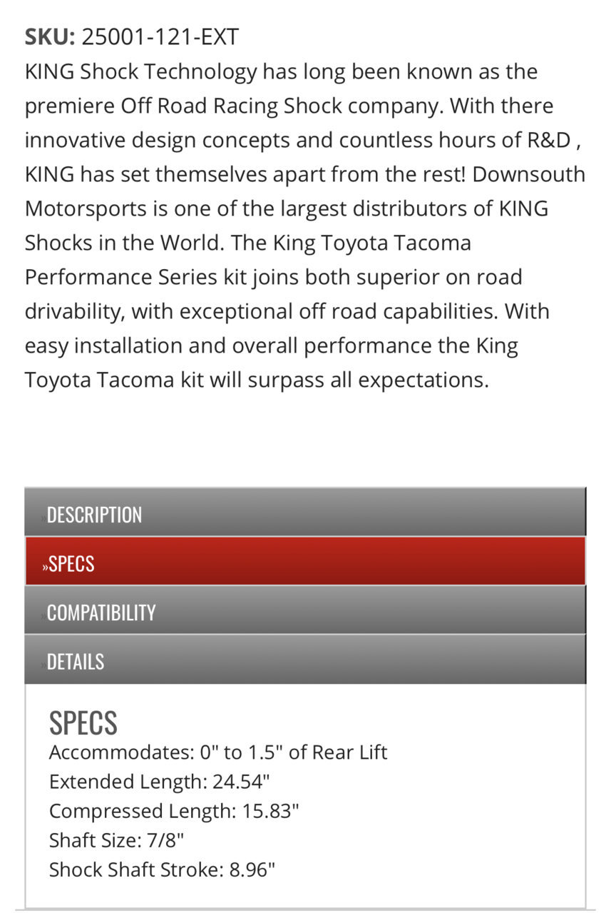

    King needs to offer a short body 11” for the Tacoma. The b110s are good, but too long at full compression

  12. Feb 9, 2021 at 10:33 AM
    EatSleepTacos
    EatSleepTacos [OP] Well-Known Member
    Mar 24, 2015
    #151688
    59,844
    Randy
    West Valley, AZ
    2017 4Runner
    Eh, nothing too crazy. Not bad at all but could be a little better. Still only a 10" shock.
    Measurements: Extended - Collapsed - 15.901 26.027"
    Vs the B110
    16.34" to 27.28
    DoulosXP likes this.
  13. Feb 9, 2021 at 10:39 AM
    BamaTaco56
    BamaTaco56 Well-Known Member
    Mar 25, 2017
    #214383
    10,307
    Trey
    “requires 1” bump stop spacer”. I wonder what bump stops this measurement was based on.
    also wonder what the difference between these and the “extended travel OEM fit” offering from king.

    I dunno. I *think* that the oem rear kings is around 24.5", EXT is a little longer than that, and now this Tundra offering. I never cared enough to find measurements on those since I was never planning on running them

    So that shock from accutune basically is a short body B110. That’s cool.

    How do you figure? The b110 is an 11" shock and 27.3" extended. Or are you talking about the tundra one.

    that picture is the oem fit extended length.
    I’m talking about the tundra one. B110s are actually tundra shocks as well.
