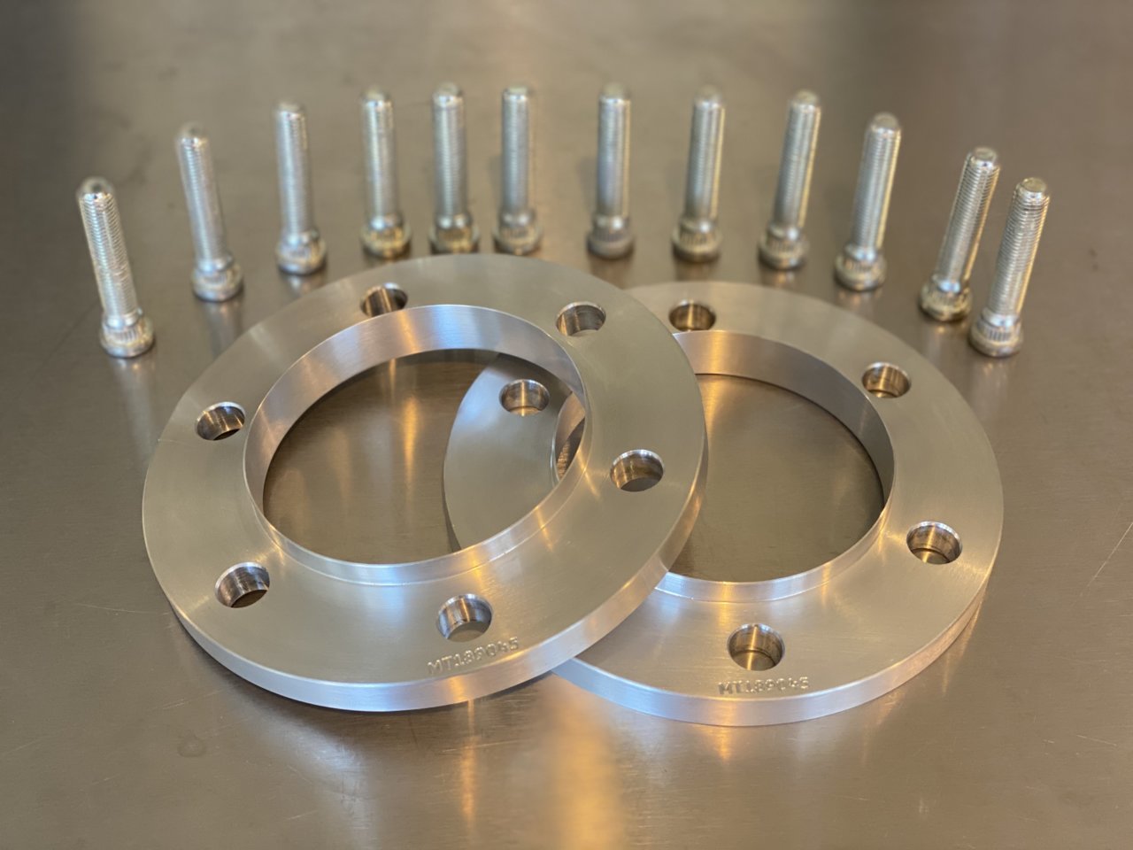

    My custom slip on spacers from bora arrived. @Darkgoatracer
    1/2” thick. 106mm inner hub. 108mm outer hub.
    Studs are 1/2” longer to accommodate the added thickness.
    These will go on the rear to help clear the shocks at full articulation.
