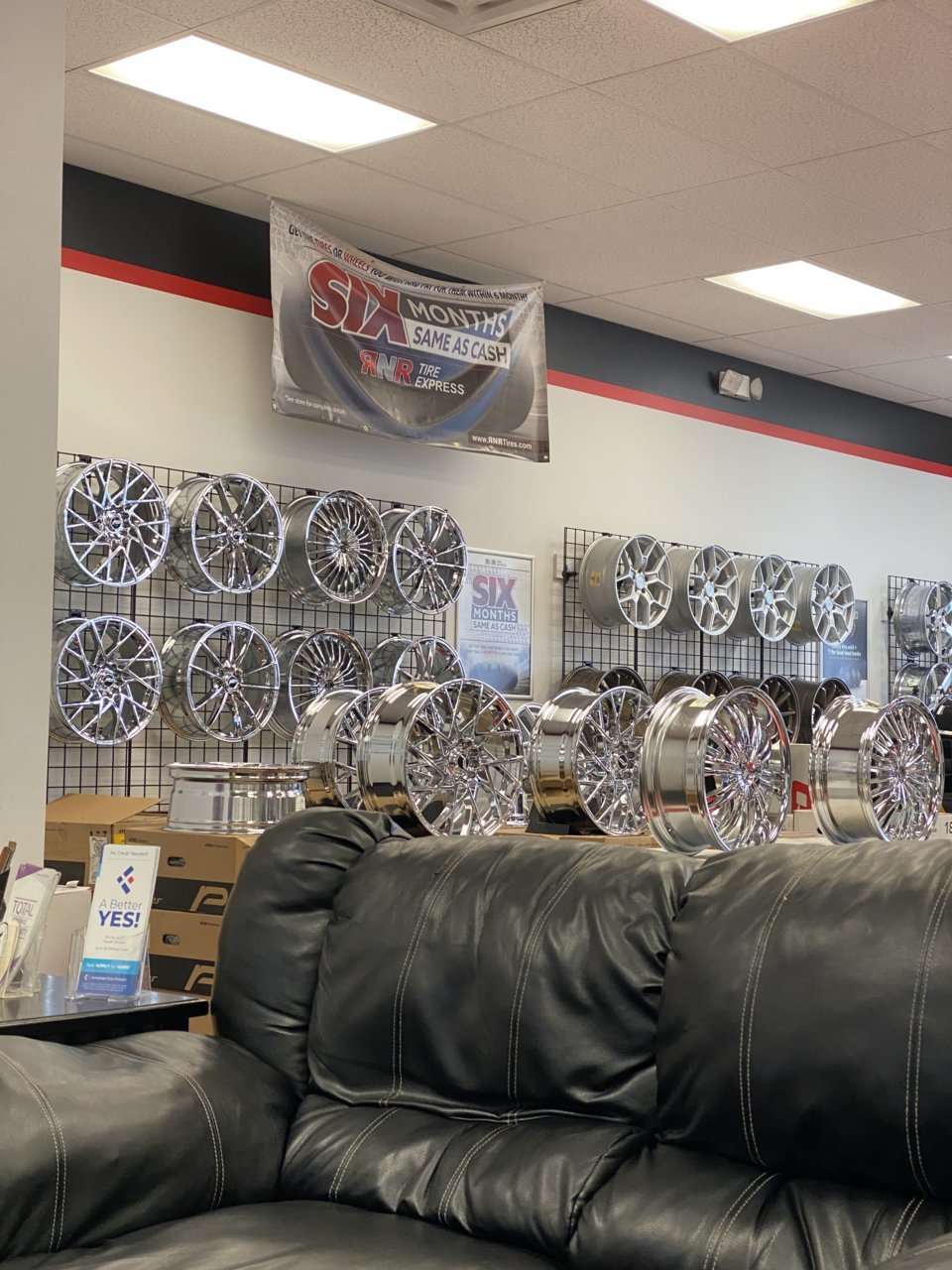

    I think it’s time to switch up my wheels. The beadlocks are overplayed.

    Six months same as cash. You could get a second set.

    Have a street setup and an off-road setup. Good thinking.

    24x14 or bust
