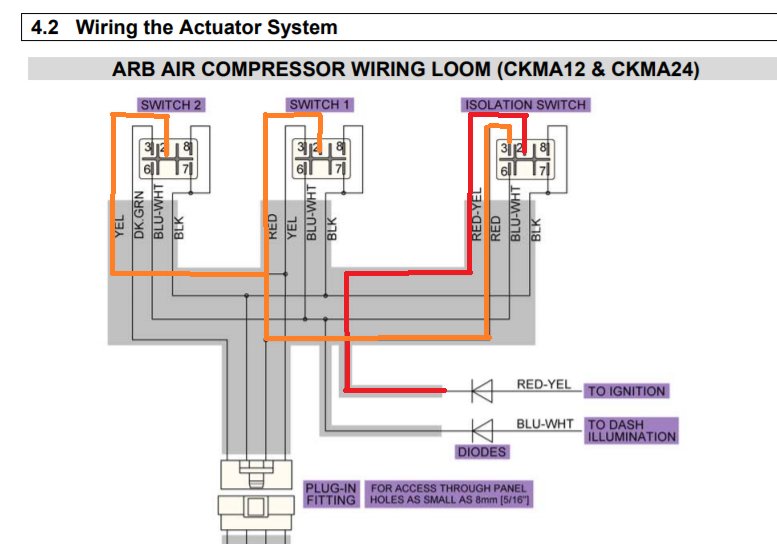

    Nevermind, I figured it out by looking at the wiring diagram. This is the normal diagram.
    All I'd need to do is have the front locker get power from orange.

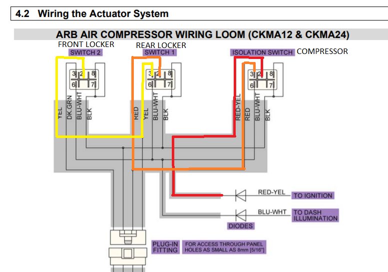

    I definitely needed it this past weekend with a destroyed rear and one front axle broken had to come off the hill in one wheel drive.
    So the power goes to the rear locker switch via the compressor switch when it's turned on. I just T'd off that by moving the wire that Originally went to the front locker when the rear engaged. If that makes sense. If need be I'll pull my console or make a schematic

    Yes that's it

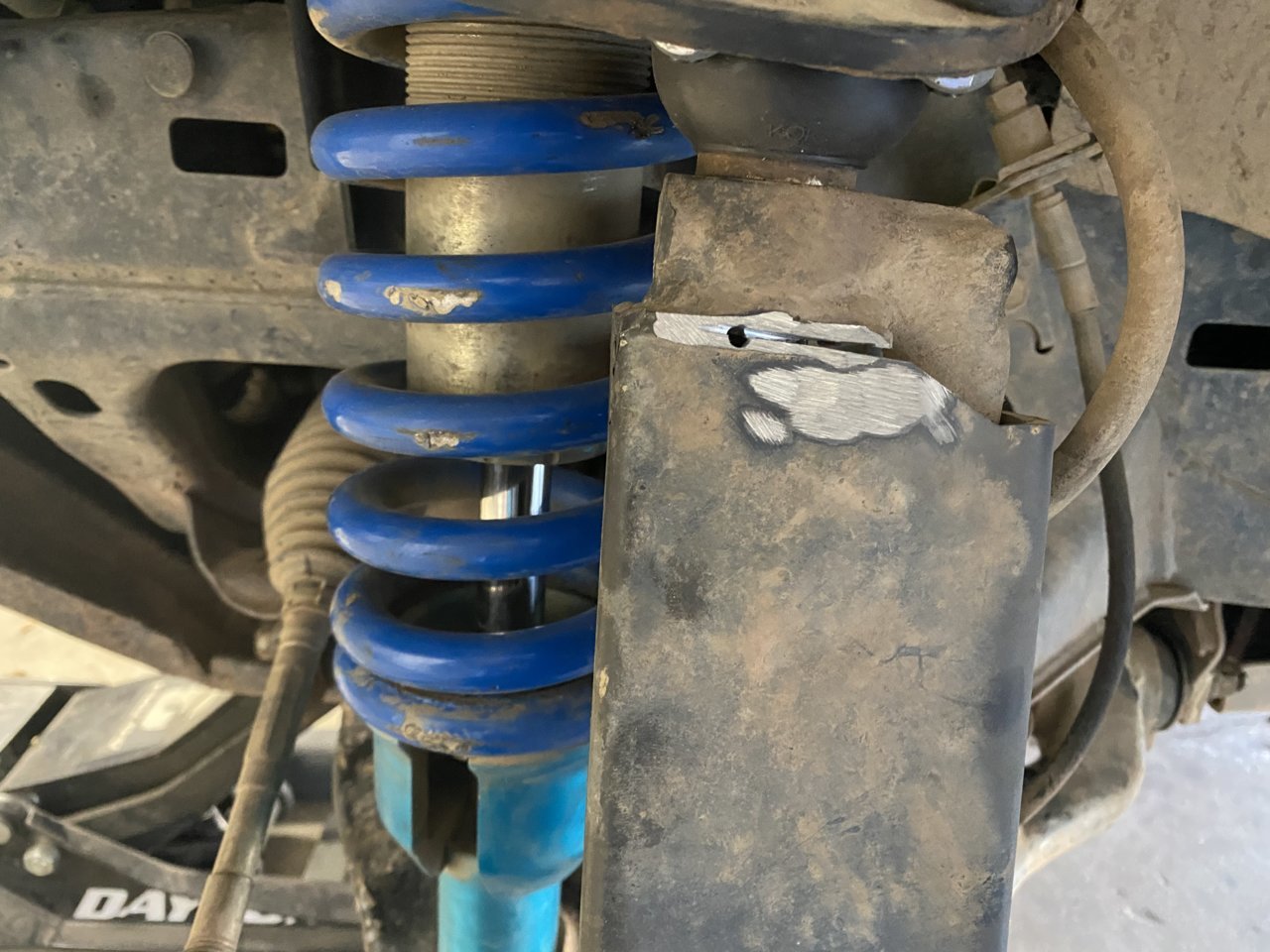

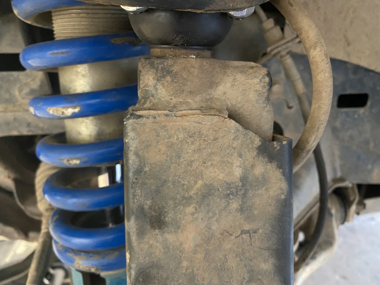

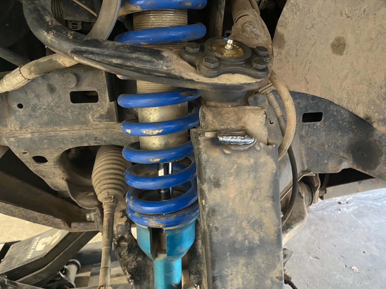

    While I was replacing ball joints today I noticed a crack on one of my spindles. It was an easy fix and I’m glad I noticed it.

    JBA arms, right?
  13. Feb 25, 2021 at 8:49 AM
    EatSleepTacos
    EatSleepTacos [OP] Well-Known Member
    Mar 24, 2015
    #151688
    59,835
    Randy
    West Valley, AZ
    2017 4Runner
    Yeah. I'm now on my third set of upper ball joints. The first two sets only lasted 18 months each.
