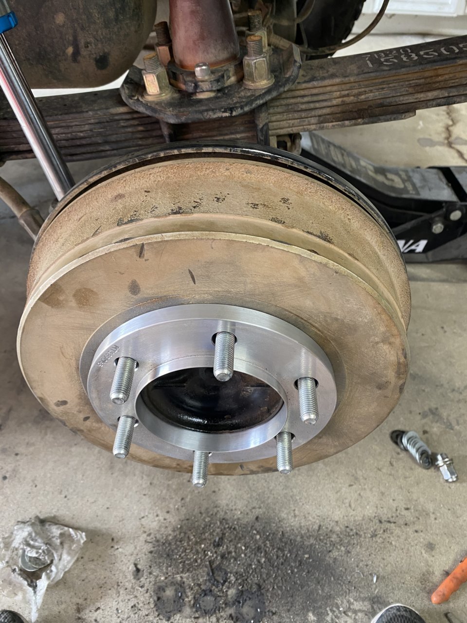

    I was juuuuuust able to fish the new studs in without having to disassemble the rear brakes. All I had to do was take the drum off, obviously.

    Custom order I assume? I like the idea of slip on spacer. What kind of specs did you need to know to order them? I imagine I will need spacers for my shock relocate. 3.5” BS with 295s currently. These might just be the ticket to clear the 2.5 12” smoothies.

    Yeah, custom from bora. You just need to know your bolt pattern, hub diameter of the truck and hub diameter of your wheels. Mine are only custom because I needed a 108mm outer hub for these wheels. Either way you can order right from their website.
