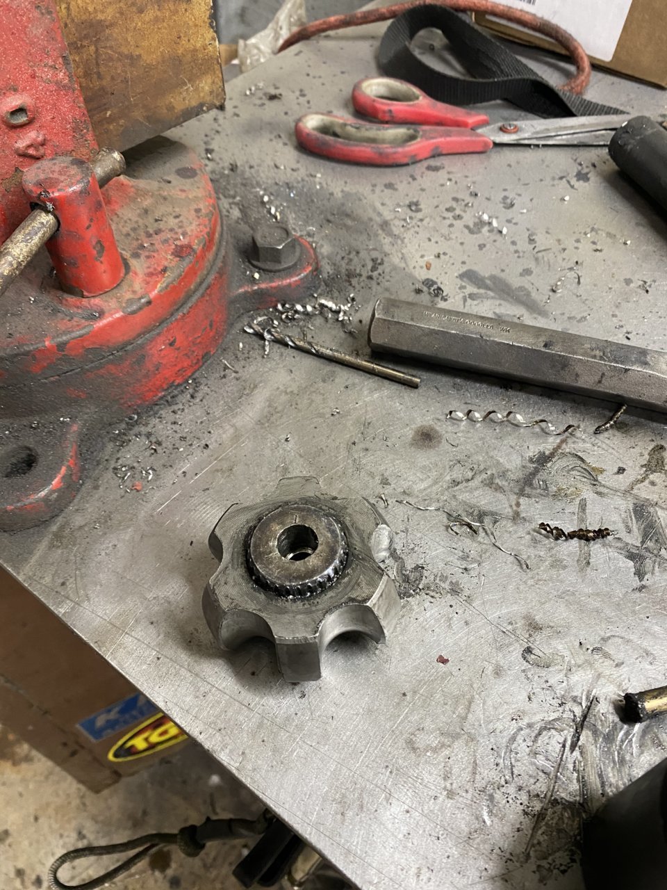

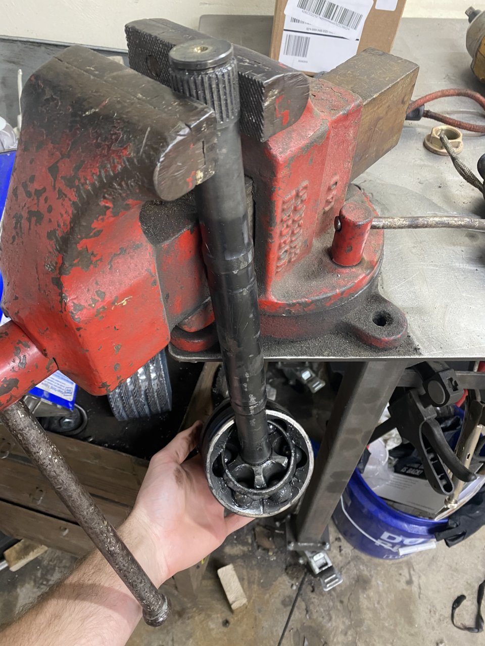

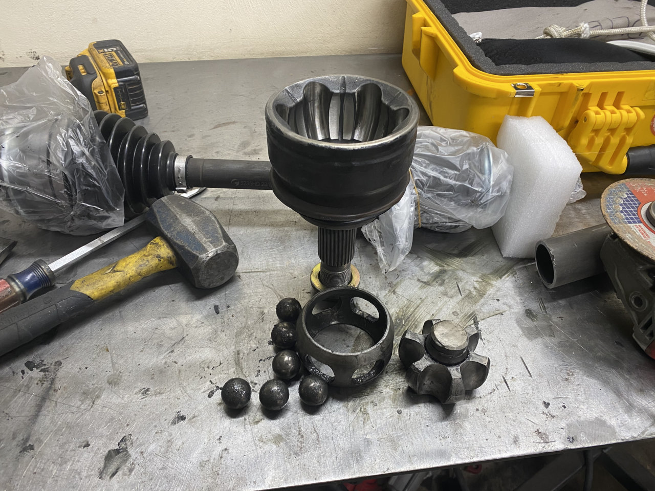

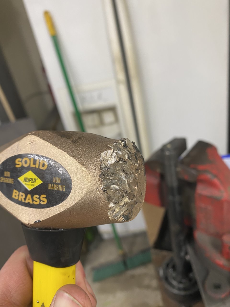

    Cv disassembly part 2. It was recommended to me to try a brass hammer and smack on it. I even went at it with 2 hands and no luck. So then I cut the shaft off and disassembled. That didn’t help at all because this stub is still in the star. I’m going to source another OE axle and just mail it to JD Fab and let them deal with it. They’ll disassemble them and reassemble the new ones for only $329.

    Big reason why shops just replace the whole axle. Costs about the same out the door doing the whole axle than just a joint.

    I would do the same if I didn’t have to reuse this outer. The inner joint is a piece of cake. It’s this one that is most definitely not a piece of cake. I’m going to cut it in half with the plasma cutter because fuck that thing.

    Yeah. I was going to suggest a hammer than remembered you needed to save on it. I still have a dead blow hammer that was my go CV separator.
