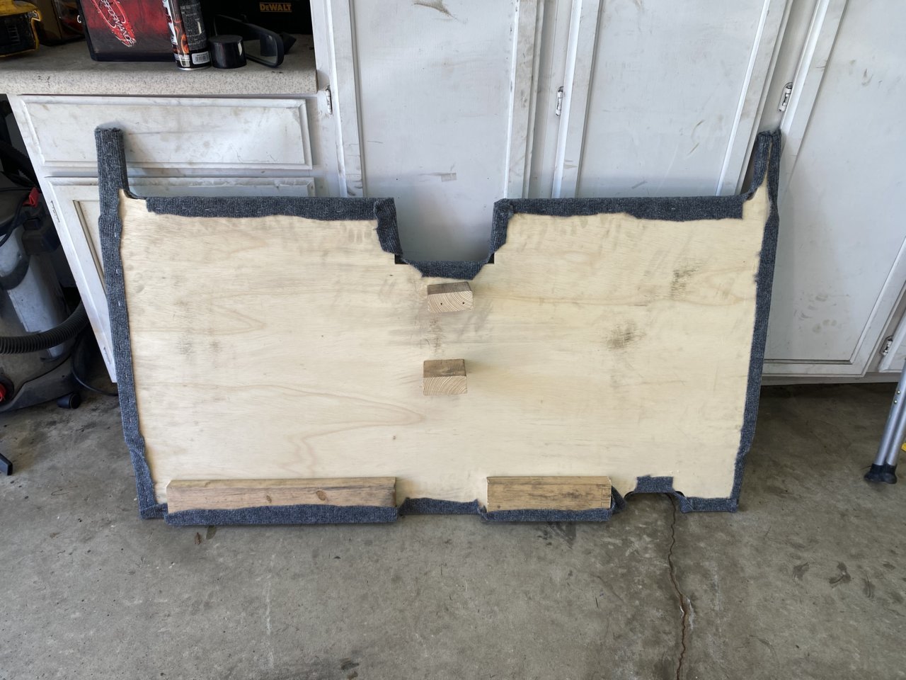

    Built a platform out of 3/4” plywood today. All that’s left is to create some brackets to secure it to the seat bolts. I’m going to add D rings and carry a tote with all my spare fluids and parts back here. I want it very well secured so it stays put in case of an accident.

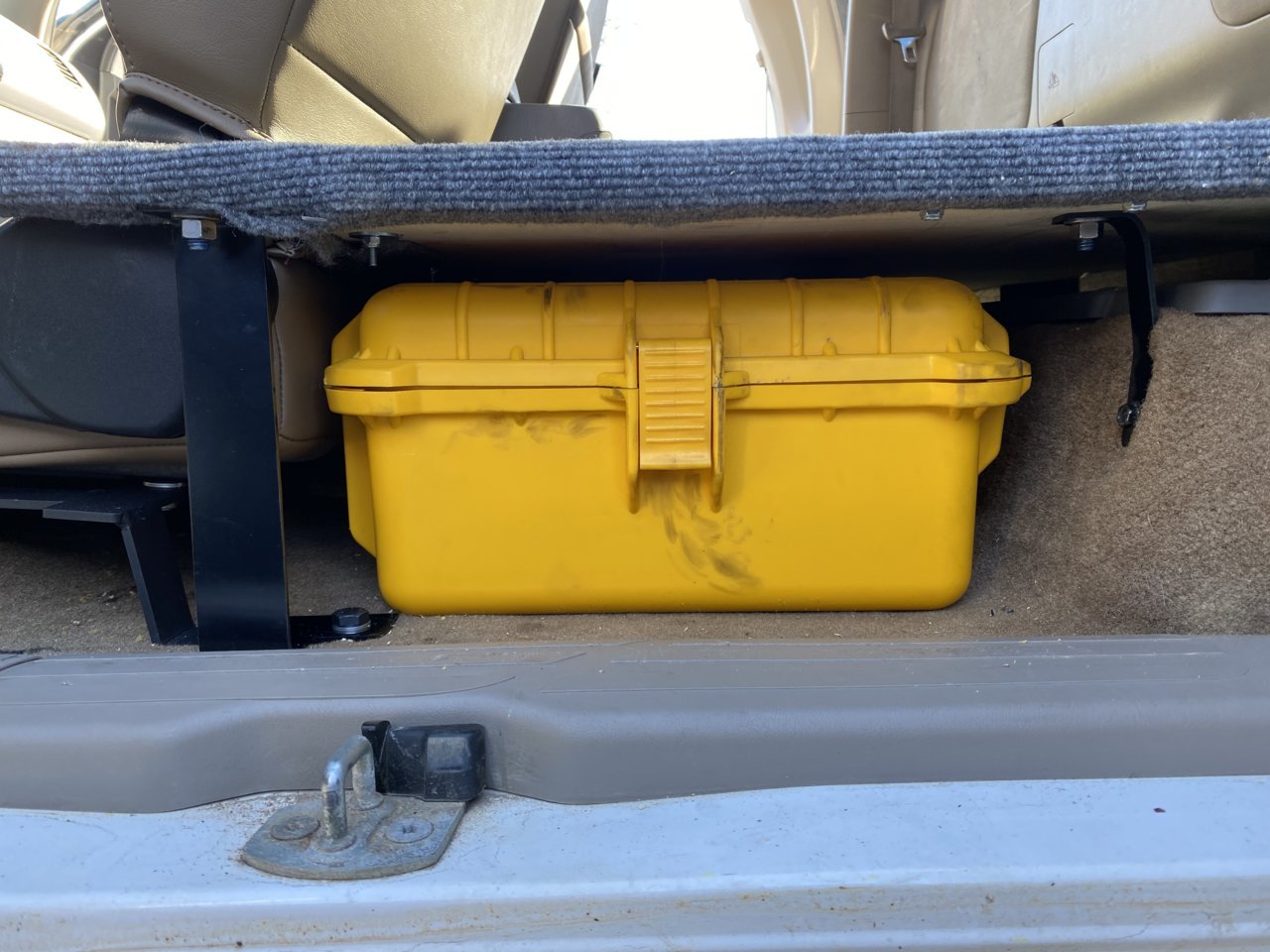

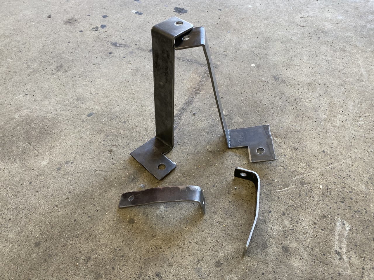

    Finished up the platform today. I added L track, secured with 10-24 hardware and fender washers. Created some brackets that tie into the seat bolts and bolt to the platform with 3/8” stainless steel hardware. Overall I’m incredibly happy with how it came out. It’s rock solid.

  12. Mar 5, 2021 at 1:02 PM
    PzTank
    PzTank Stuck in the Well
    Sep 14, 2010
    #43250
    7,076
    Above the Notches
    ‘15 AC SR5 4X4 4.0 Auto
    ‘07 OR leather shift knob
    Those are slick mounting brackets. Really nice!!
    Is the platform secured with just these?
    If so, would you be interested in fabbing up another set?
  13. Mar 5, 2021 at 1:05 PM
    EatSleepTacos
    EatSleepTacos [OP] Well-Known Member
    Mar 24, 2015
    #151688
    59,830
    Randy
    West Valley, AZ
    2017 4Runner
    It has these 2x4’s under it for support, and these braces as well. You could ditch the horizontal 2x4’s and have it sit a couple inches lower but I needed the clearance for the cases you see under there.
    I don’t want to make the brackets without a truck in front of me. Too many minor variables that could make them not line up. That said, I didn’t use anything fancy to make them. Cut them out with an a plasma cutter (which could be substituted for an angle grinder). Drilled the holes and bent them in my vice. No welding required.
