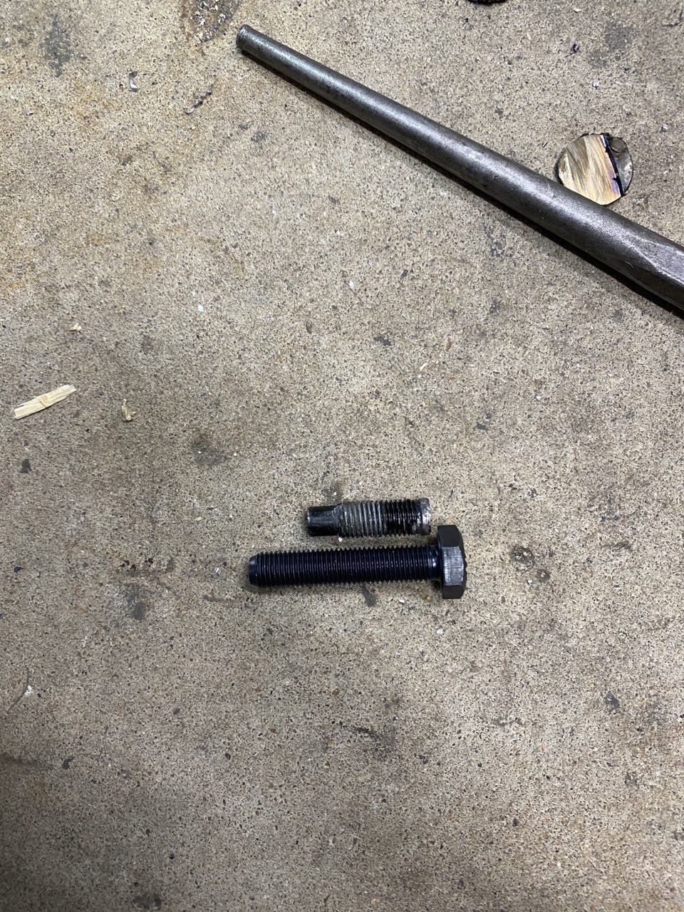

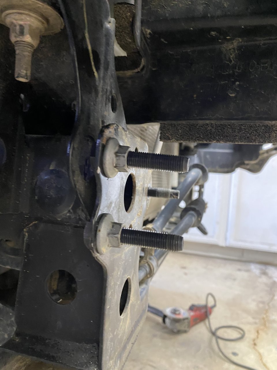

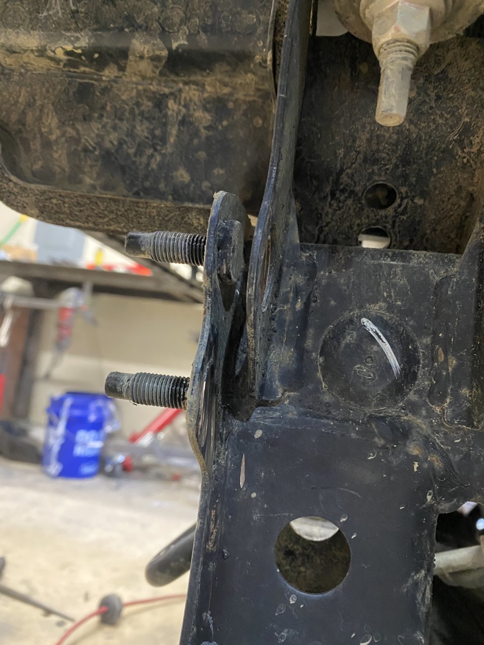

    Added some longer studs for @Greg.Brakes.Tacos today. He wanted to add a bumper brace but there isn’t enough thread engagement because of the thickness of it. M10x1.25 50mm long. Just use a cutoff wheel to cut off the back with precision and gently work it out with a hammer being careful not to bend the surrounding sheet metal.
    Pull the bolts through and use a nut to hold it in place. Throw a little weld on the back and voila.

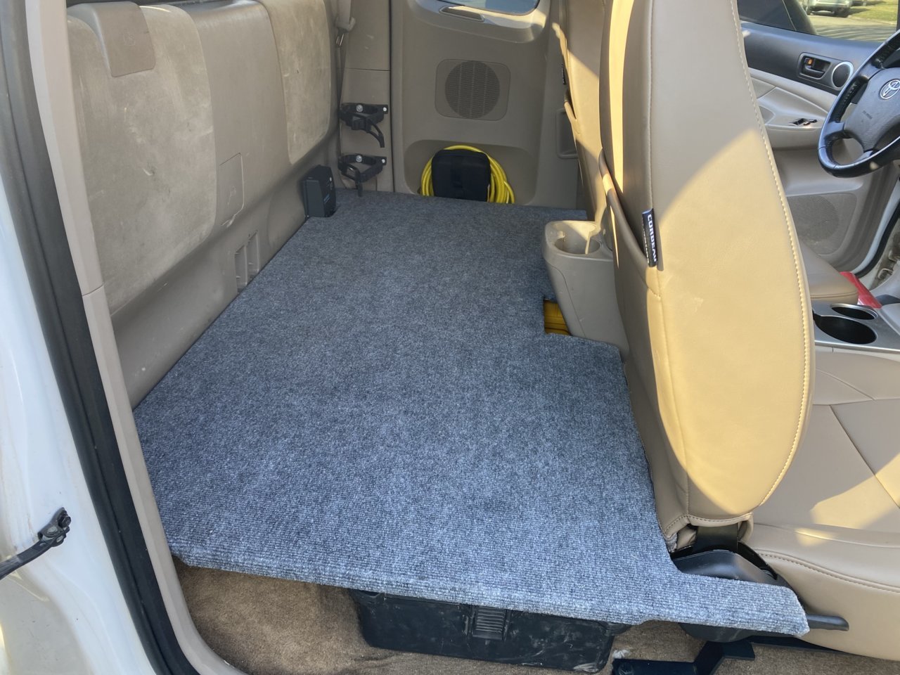

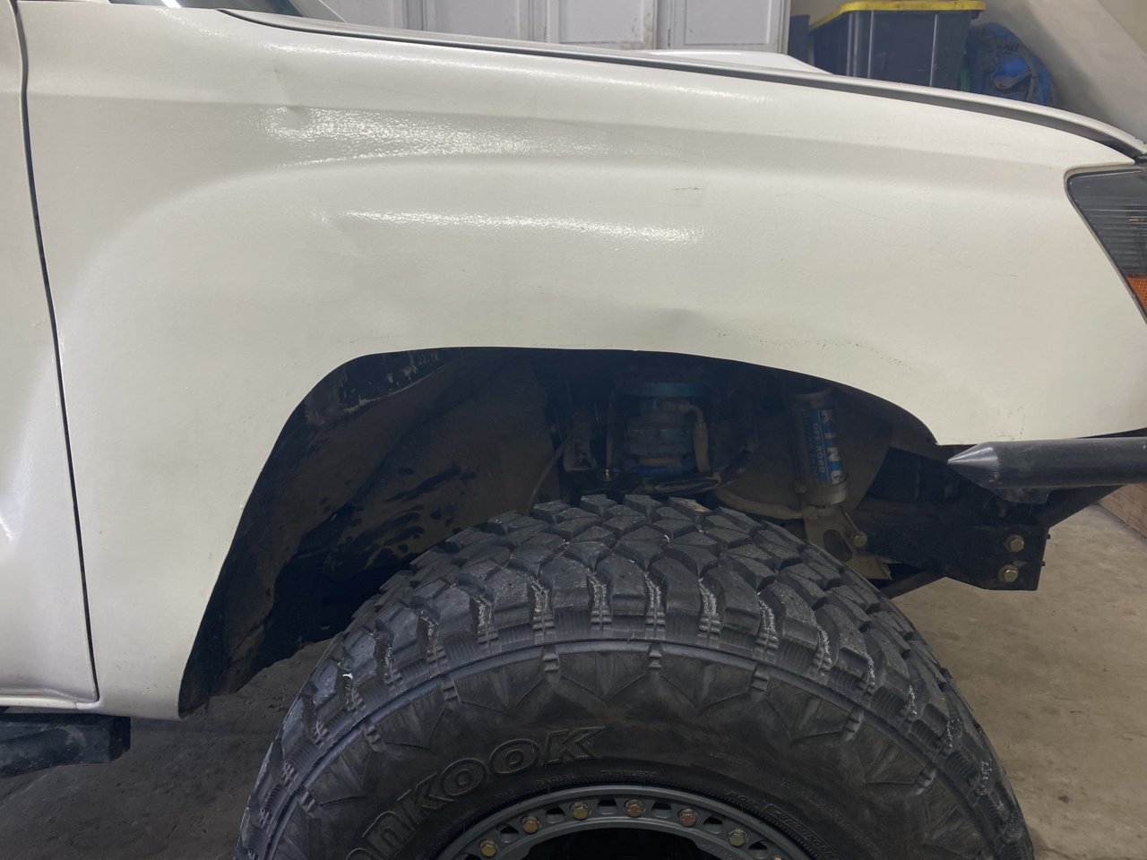

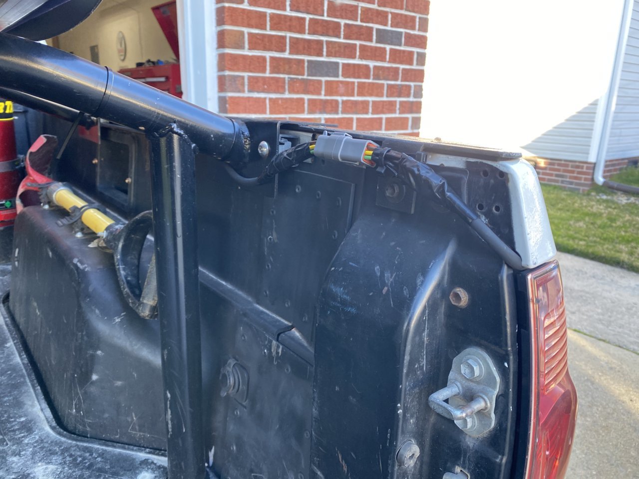

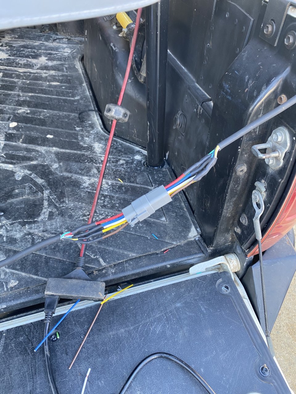

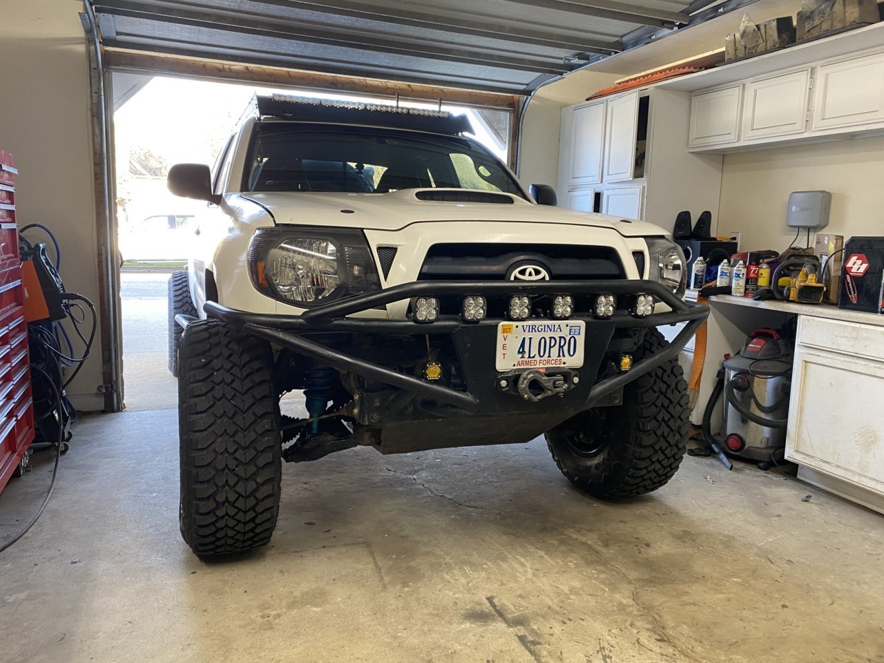

    Super productive day today.
    1. opened tent to double check that its good before this weekend.
    2. Torqued beadlock bolts
    3. Trimmed another inch off my front fenders.
    4. Modified my switch wiring to allow independent front locker usage.
    5. Added quick disconnect to my chase light.
    6. Switched my center four lenses from flood to spot and aimed them better.
    5D3717DE-E57D-410F-B13B-786AE8A66C18.jpg 452E2E4F-9724-4B59-83A0-C7DE317D6CD0.jpg 7A6B78E3-982C-4248-9A73-6F88E28584A8.jpg A21DF7CB-F60E-4470-956A-486F53B1CBD6.jpg

    Are you going to trim the cut fender?

    No, I never bother with edge trim. No reason in particular, I just prefer the look without it and I never go out of my way to buy it. If I had it on hand I might use it.
