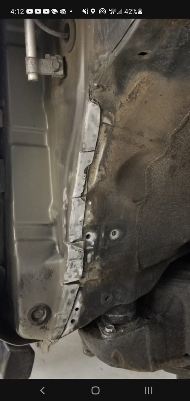

    Yeah sounds like tool improvising fun!!
    I did get a great visual from the main VA thread Screenshot_20210304-161252_DuckDuckGo.jpg
    And the liner salvaging comment doesn't help... let's see if I can just get the tire off the pinch weld this afternoon!

    The consensus is to bend the pinch weld out rather than in like that picture. I smashed mine in, then found more rubbing on my firewall/pinch weld with 295s. Which meant I had to take the BFH to it again. And smashing the bent inward pinch weld was hard. And had little give.

    Bend it outward in one piece, just work your way back and forth along the entire length with the hammer. Prevents need for any cutting which can lead to leaks later on. Some people coat with sealant afterwards for peace of mind.

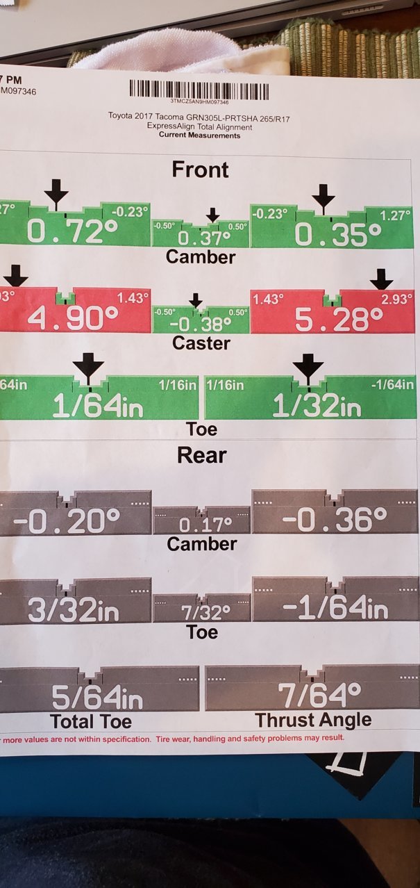

    It's tracking true, just hitting on reversing full lock to left,but hoping the pinch weld tips will alleviate that.
