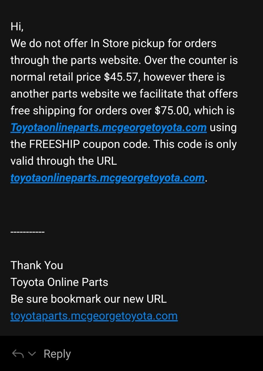

    Truth!!!
    I got my header rail (turd gen problems) and a few filters for less than what the rail and shipping would be (and I'm less than an hour from dealership).Screenshot_20210316-115841_Outlook.jpg

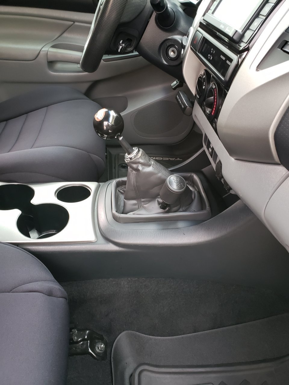

    Have fun! It is actually a pretty fun install and really gives peace of mind on the trail... gives a little extra hum on the street though, but hey it's not supposed to be super quiet in cab.

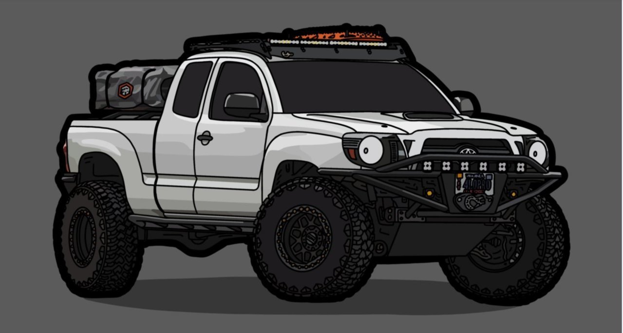

    Here’s my goal for the finished product. Gonna test my sewing skills.

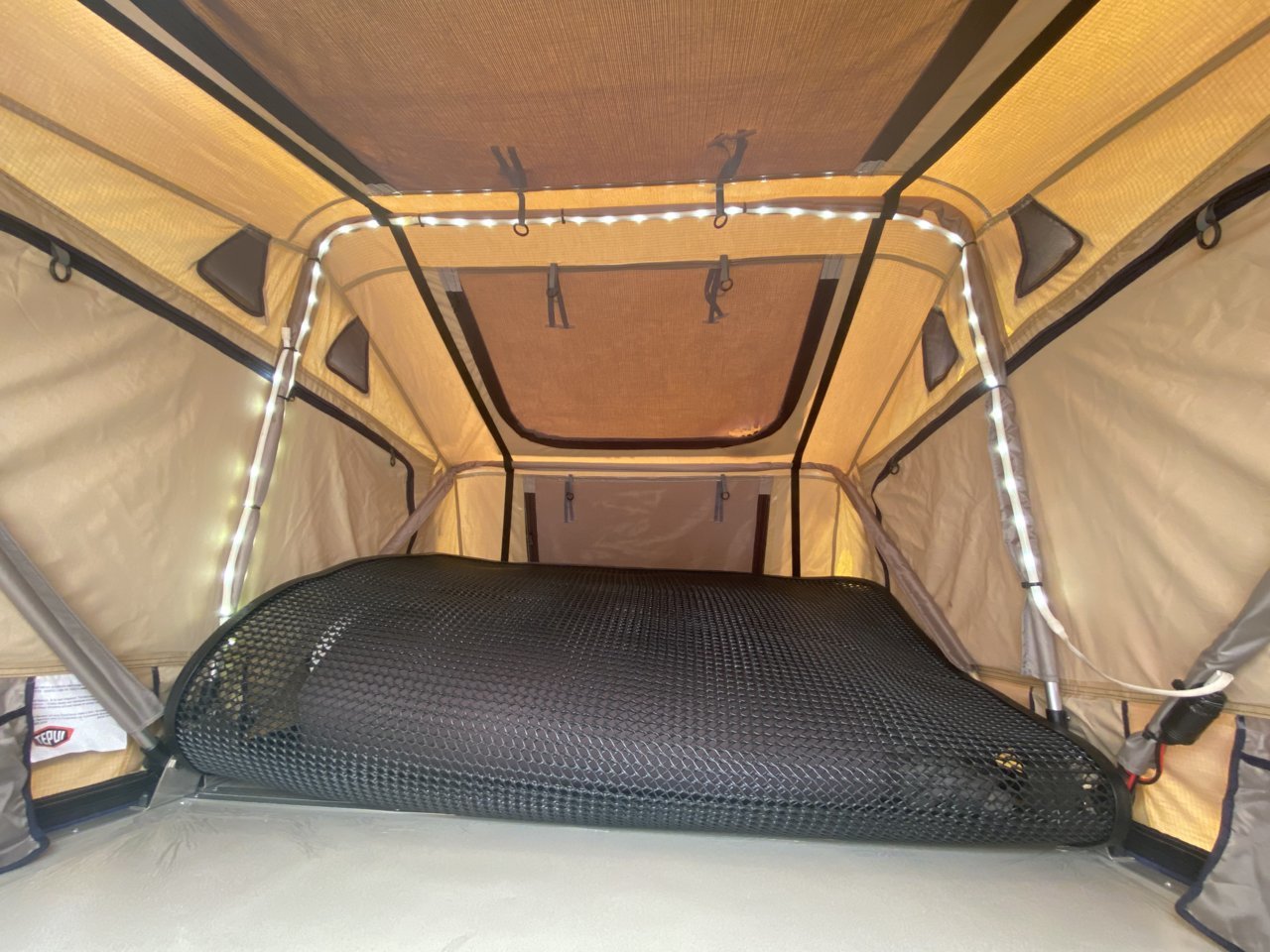

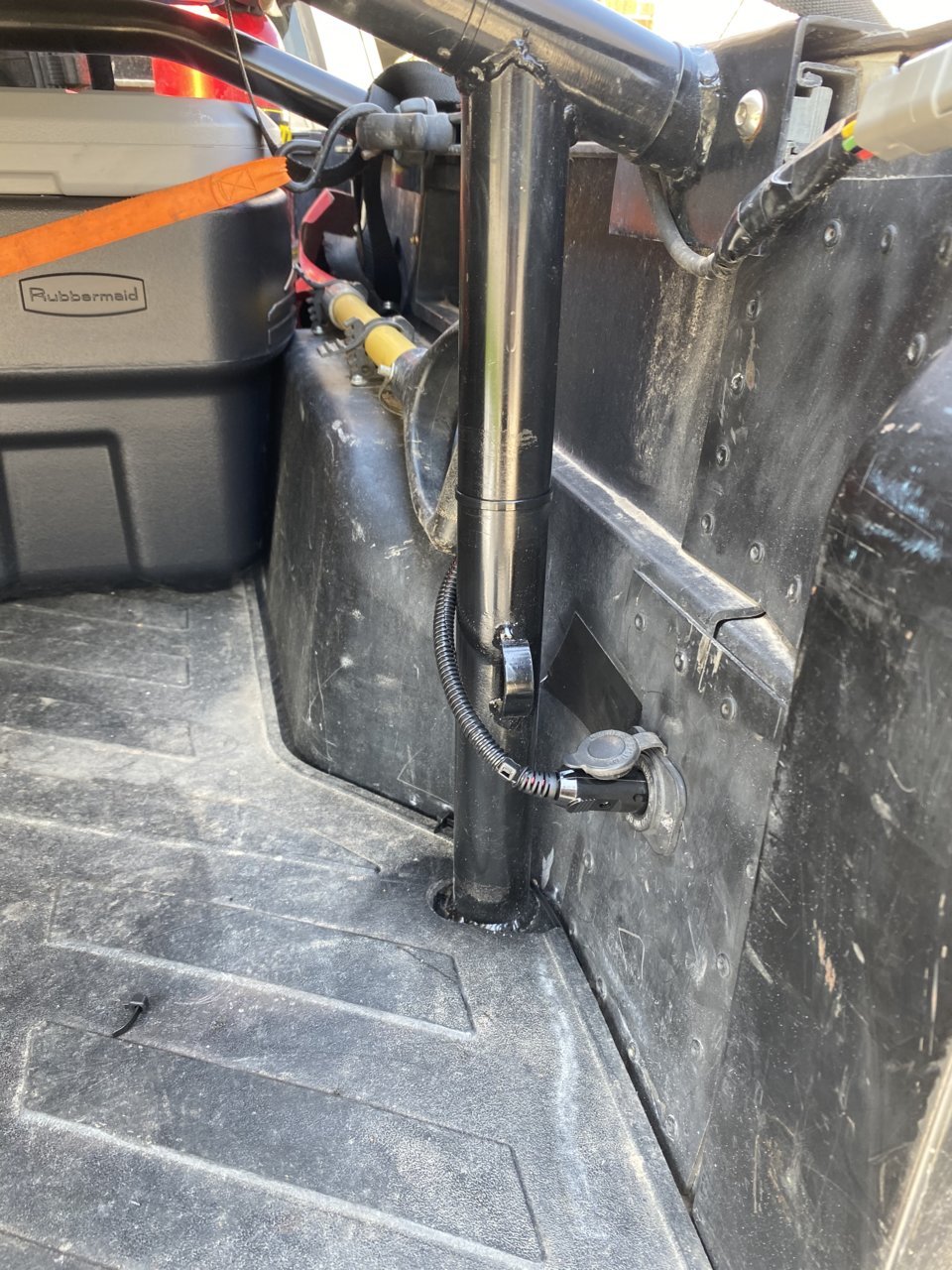

    My afternoon mods were to “hardwire” some usb outlets into the tent as well as my lumenoodle. I had it last trip just lazily tossed up around the poles and it was so incredibly handy that I wanted to make it permanent. There’s an extra usb outlet to charge my phone or run a fan.

    My OCD is screaming 'run it behind the tube Randy!'

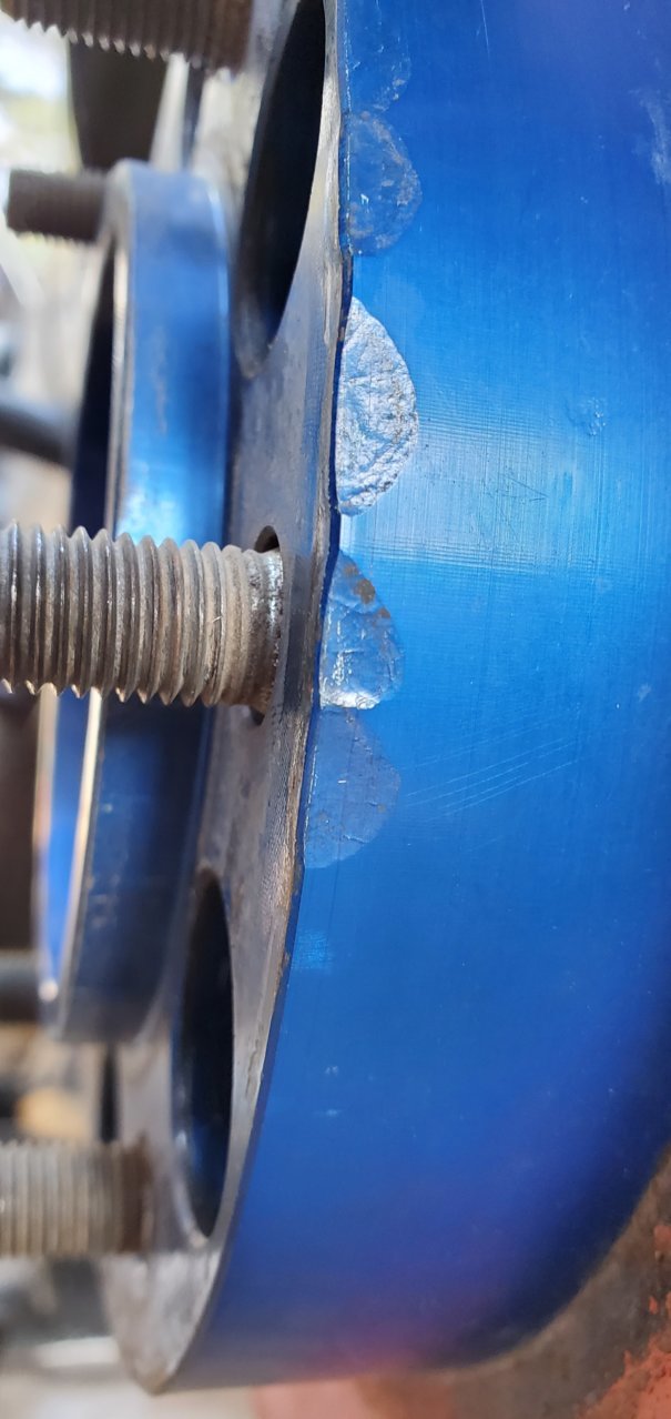

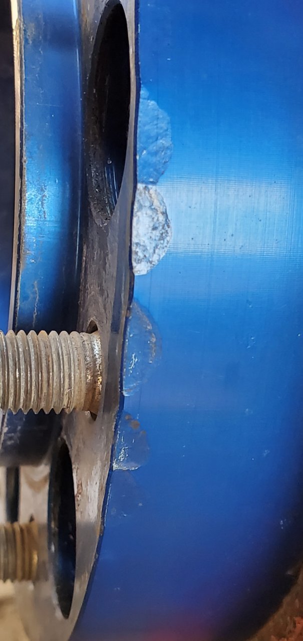

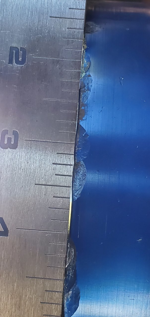

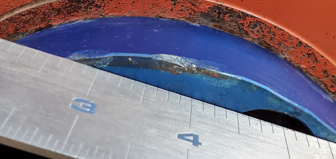

    Hey guys, I was just wondering if these wheel spacers could be considered a great deal. Cause that's what I found on eBay! I've been thinking about getting them for a long time and I think this would be a good option for rig.

    This puts a little less stress on the plug and wire since it’s a more gradual bend vs a sharp 120 degree back towards the tube.
    or at least that’s what I tell myself.

    I’d stay away. Those marks are from someone hitting it with a hammer to free it from the truck. If that person doesn’t even own a dead blow, probably don’t own a torque wrench either.
    Now, there have been instances with my old spacers where I had to tap them with a hammer and it left a slight mark, but those marks pictured are from someone wailing on it.
