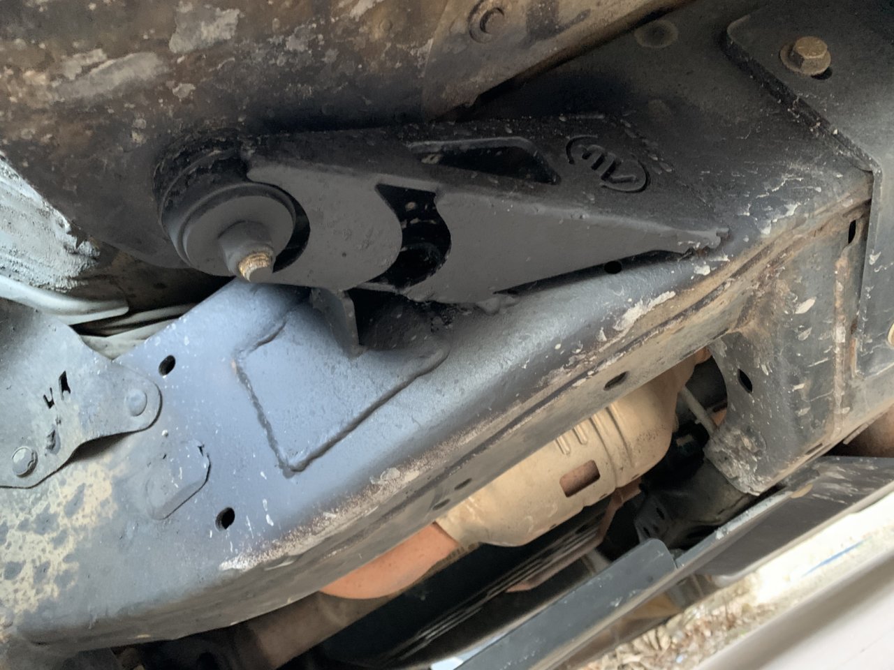

    I’ve never liked the design of the alpine relocate and this just proves it.
    DBE0E279-CE79-4C97-B314-792E264C66BD.jpg E3C5787C-B547-4F9E-8946-1FD1766ADBC9.jpg

  14. Apr 13, 2021 at 10:27 AM
    y=mx+b
    y=mx+b Station Wagon
    Jul 17, 2020
    #334787
    1,938
    Lafayette, IN
    '05 T4R SR5 v6 4wd
    Are those taking chunks of the frame out with them? Crikey
  15. Apr 13, 2021 at 10:28 AM
    EatSleepTacos
    EatSleepTacos [OP] Well-Known Member
    Mar 24, 2015
    #151688
    59,846
    Randy
    West Valley, AZ
    2017 4Runner
    Yeah, it's just ripping the frame. It's a dumb design. Puts a loooooot of force on a long arm and has barely any connection to the frame.
  16. Apr 13, 2021 at 10:30 AM
    y=mx+b
    Jul 17, 2020
    #334787
    1,938
    Lafayette, IN
    '05 T4R SR5 v6 4wd
    yeah thats a poor design, I would have at least put a big ol plate on the frame behind it to help with distribution. Factory body mount is pretty beefy for a reason lol
  17. Apr 13, 2021 at 10:32 AM
    EatSleepTacos
    Mar 24, 2015
    #151688
    59,846
    Randy
    West Valley, AZ
    2017 4Runner
    Yeah exactly. Reinforce the frame there and also add another connection point to the mount, similar to the lil b.

    I never liked that Alpine design. Went with red goat from the jump

    Seems to help a lot with load distribution. I went with lil b and had a plate welded over the giant hole where the factory cab mount was located for extra support on the 2nd gens. I don’t foresee any issues with this design
