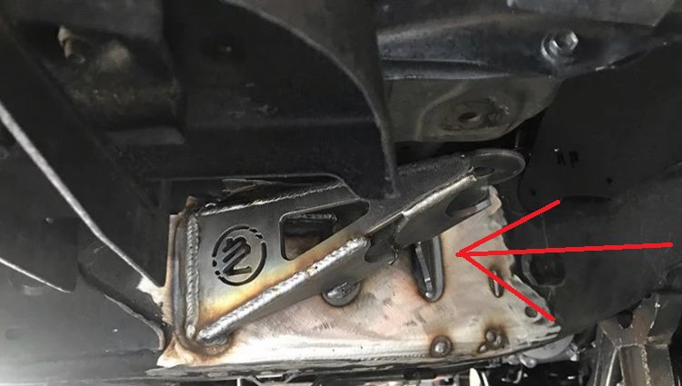

    Even with the RGF ones needs frame reinforcement. Weak and thin steel they start to have issues.

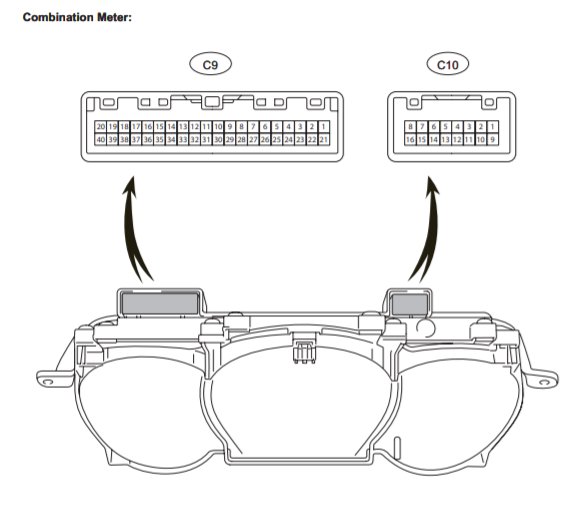

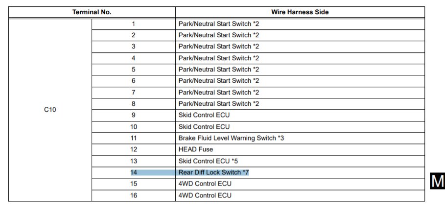

    @6 gearT444E because you're a smart cookie. I know my gauge cluster has a diff lock light even though I don't have a factory locker. Do you know which pin on the back harness lights that up? I would love to wire in my ARB locker switches into the dash so I have a more obvious visual cue of my lockers being on.
    Gunshot-6A likes this.
  11. Apr 19, 2021 at 7:54 AM
    EatSleepTacos
    EatSleepTacos [OP] Well-Known Member
    Mar 24, 2015
    #151688
    59,846
    Randy
    West Valley, AZ
    2017 4Runner

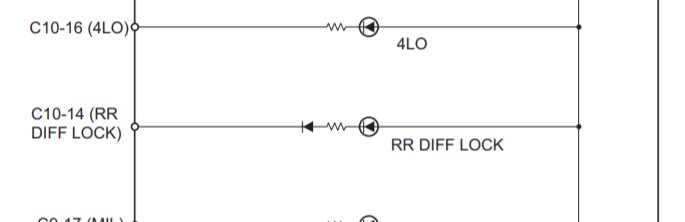

    A little digging through the FSM and I figured out the pin myself. Still not 100% on if it'll illuminate if I just provide 10v-14v. Or if it's the opposite? It looks like if it's getting +12v, the light is off but if it's getting <1v, then the light illuminates. That wouldn't be hard to do. I'll have to pull the dash and see if there's a wire in that pin.

    Hmmm, now the gears are turning a little bit. Rather than just illuminating the light on the dash, I could make it so when I flip on my locker, it actually tells the truck the "factory" diff lock is engage and it kills ABS, also illuminating the dash light.
