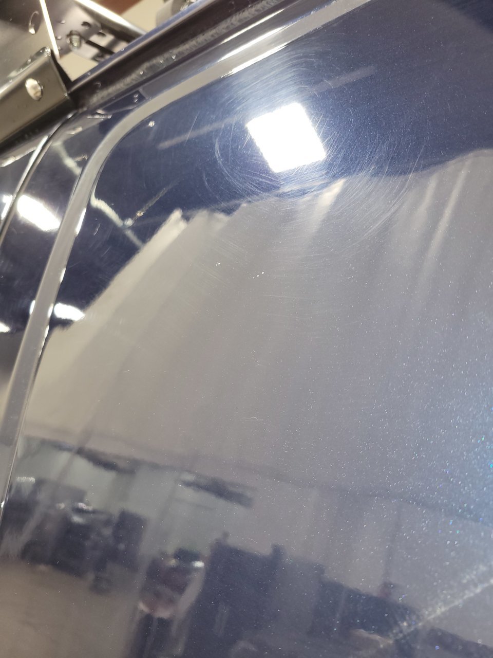

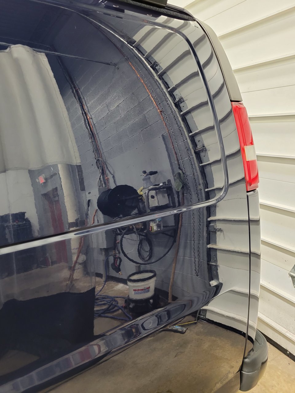

    I'm no expert but have done a bit of touch up, wet sanding and paint correction. My preffered method for bringing something back is:
    1. Decontamination: a good wash with dish soap and then a thorough clay bar work well.
    2. Touch up: i use color matched paint and a rubber squeegee. Apply a SMALL amount of paint to the chip then squeegee over it to flatten the touchup paint with the surrounding surface. This will leave some matte residue around the chip.
    3. Correction: using a decent da buffer 2 or 3 stage the entire car. This will remove that matte residue and normally removes 80-90% of scratches (assuming theyre not through the clear)
    4. Coat: ceramic coat. Theyres no point in using wax anymore.
    Shiny work van paint pic (before)
    After
