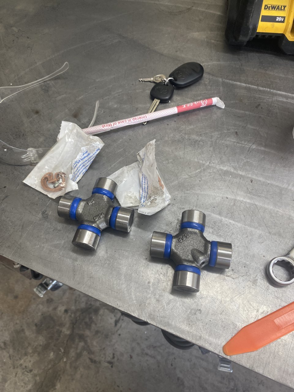

    This may be a dumb question, but what U-joints did you go with?

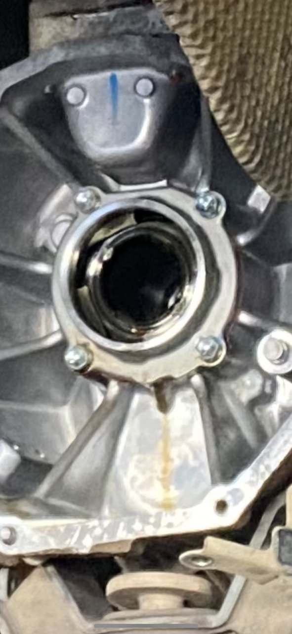

    Gonna need even more soon. Confirmed there is fluid coming from where the trans and t case meet. Doesn’t smell like gear oil so probably a transmission output shaft seal. Gonna have to drop the case again.

    This looks just like a cv diff seal. Just pull out the old and put in the new. Should be easy enough.

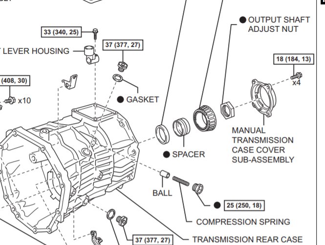

    lol I'm a dumbass and don't even know my transmission code. That's for the 5 speed. I can't find a part number for the 6 speed and it's also not in the FSM I zoomed in on one of my previous pics and it looks like there's a cover and indeed a leak. I wonder if toyota uses a paper gasket or FIPG there. Hopefully I'll have time to drop the case again tomorrow and see.

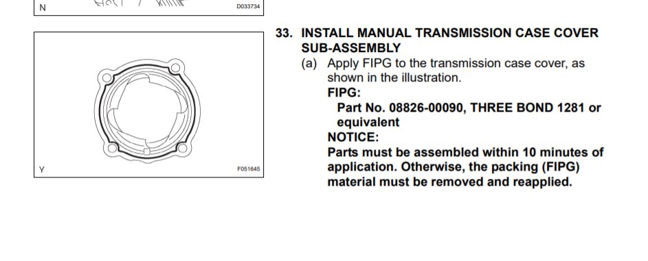

    Now I feel like I'm talking to myself. Anyways, I found what I was looking for. No mention of a seal so probably something I can just use RTV on.

    I did just have a lightbulb go off. What if it wasn't a leak? The truck was at an incline, nose up, when I removed the t case. A little oil could have just seeped out when I pulled the transfer case, much like how you lose some oil when you remove a CV. I'm gonna wait and see if it continues before dropping the t case again.
