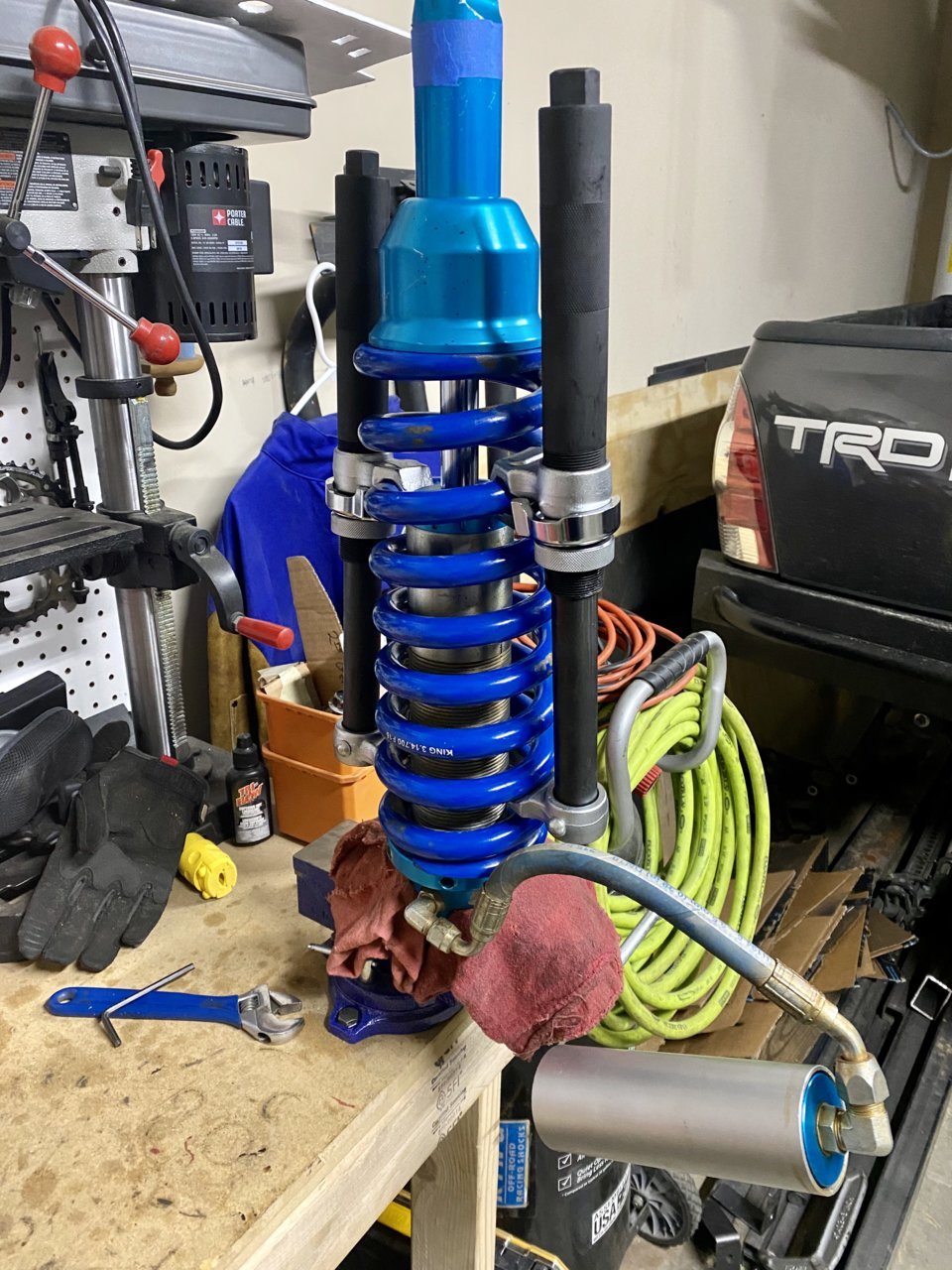

    I decided to try a new spring compressor. The one I have works, but it is a little sketchy. One of the jaws bends a bit. A friend has the same one and his let go, luckily with the top hat still on so the coil was contained. I've read some decent things about this style, so hopefully it does better.
    https://www.ebay.com/itm/144047166617
    This is my old one on 700 lb coils

    same design as the SPC compressor(s) I have. Done several swaps with 700 lb springs and it’s Not sketchy at all, Just use a ratchet (not an impact) and go easy. Keep them greased and you can compress the 700lb springs with very little effort.

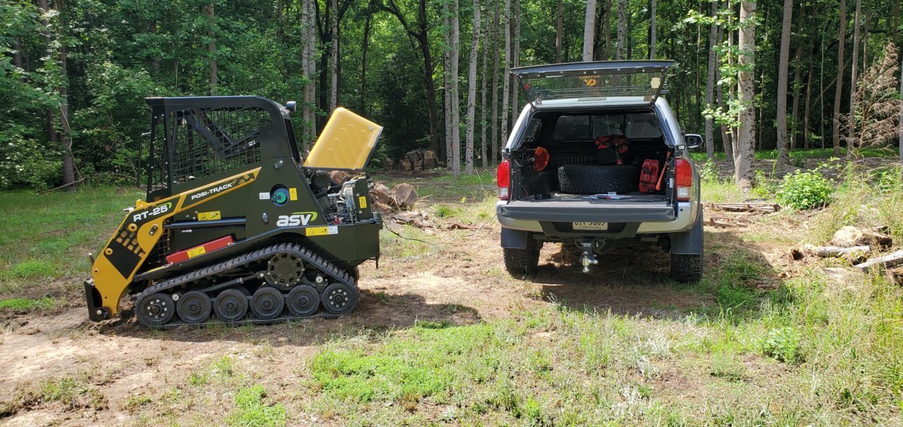

    Speaking of the bobcat-thing, we found out (well I haven't run it re: arm in sling) the fun way that the diesel sending unit is stuck/bad when it ran out of fuel Friday, but the fuel gauge was showing just under half as tank. I ran the taco out to run the trickle charger on the battery since it was turning slow and not starting (and it showed fuel in machine). It charged up full, but to no avail. 20210611_153014.jpg
    Then we put in a gallon, guage went up to half tank and started right up. Put in the remaining 4 gallons and it went back down to past half tank mark?!?!?
    Sucks to have to call-in a warranty issue to the local dealer...that we didn't buy from:cool:!

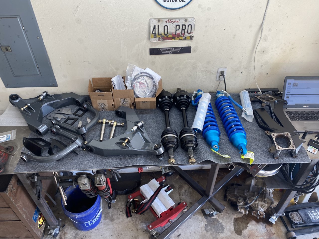

    Cleaned up and ready to start work. On one side…..

    These uca gussets were honestly way easier than I anticipated.
