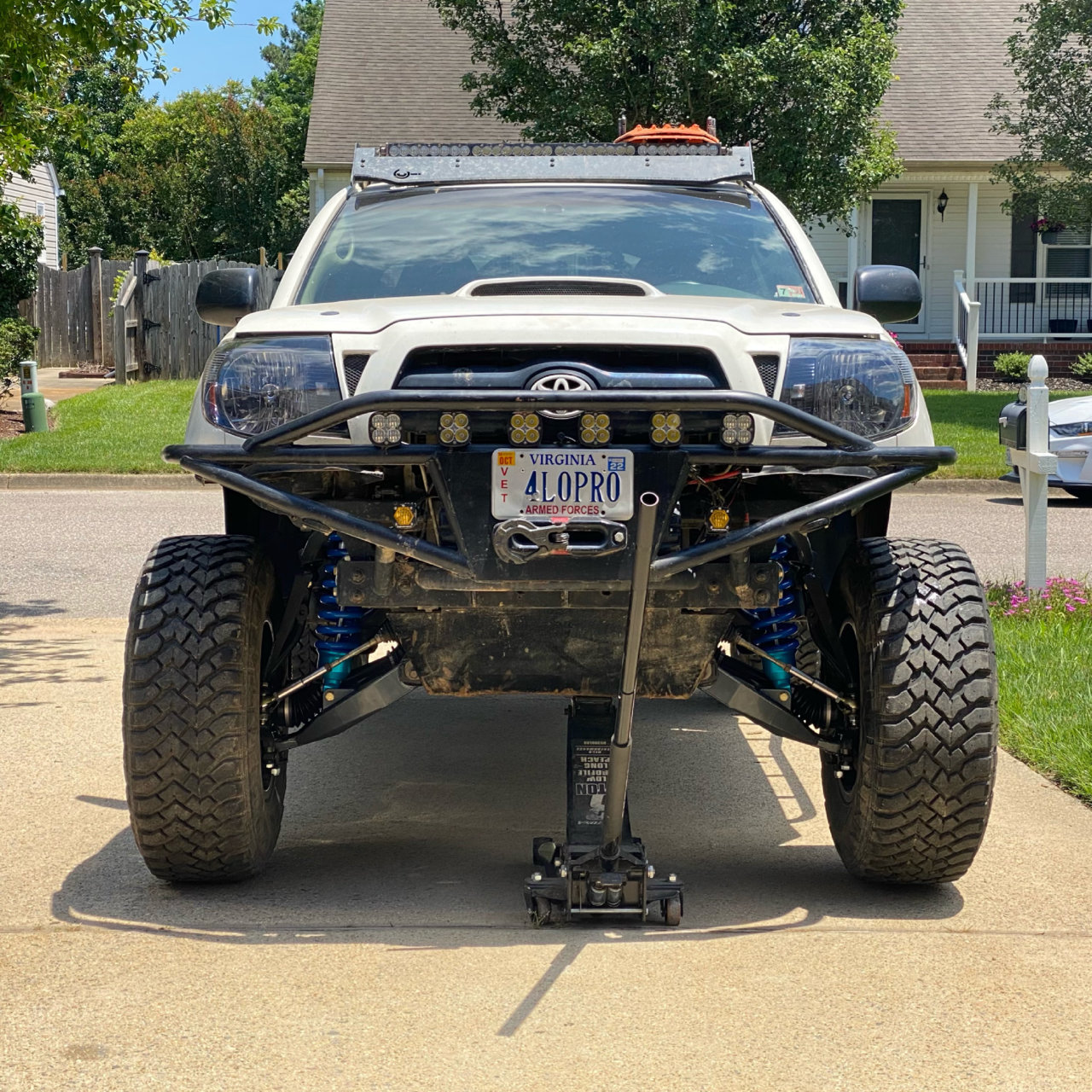

    The driveway droop pic needs to be the new profile pic for EVERYTHING.

    Def looks like a SAS truck in the profile pic from any sort of distance. Proper travel. Rig is friggin dialed.

    We're gonna need a bigger jack!!

    Luckily this one still works just fine. I can get the tires a few inches off the ground

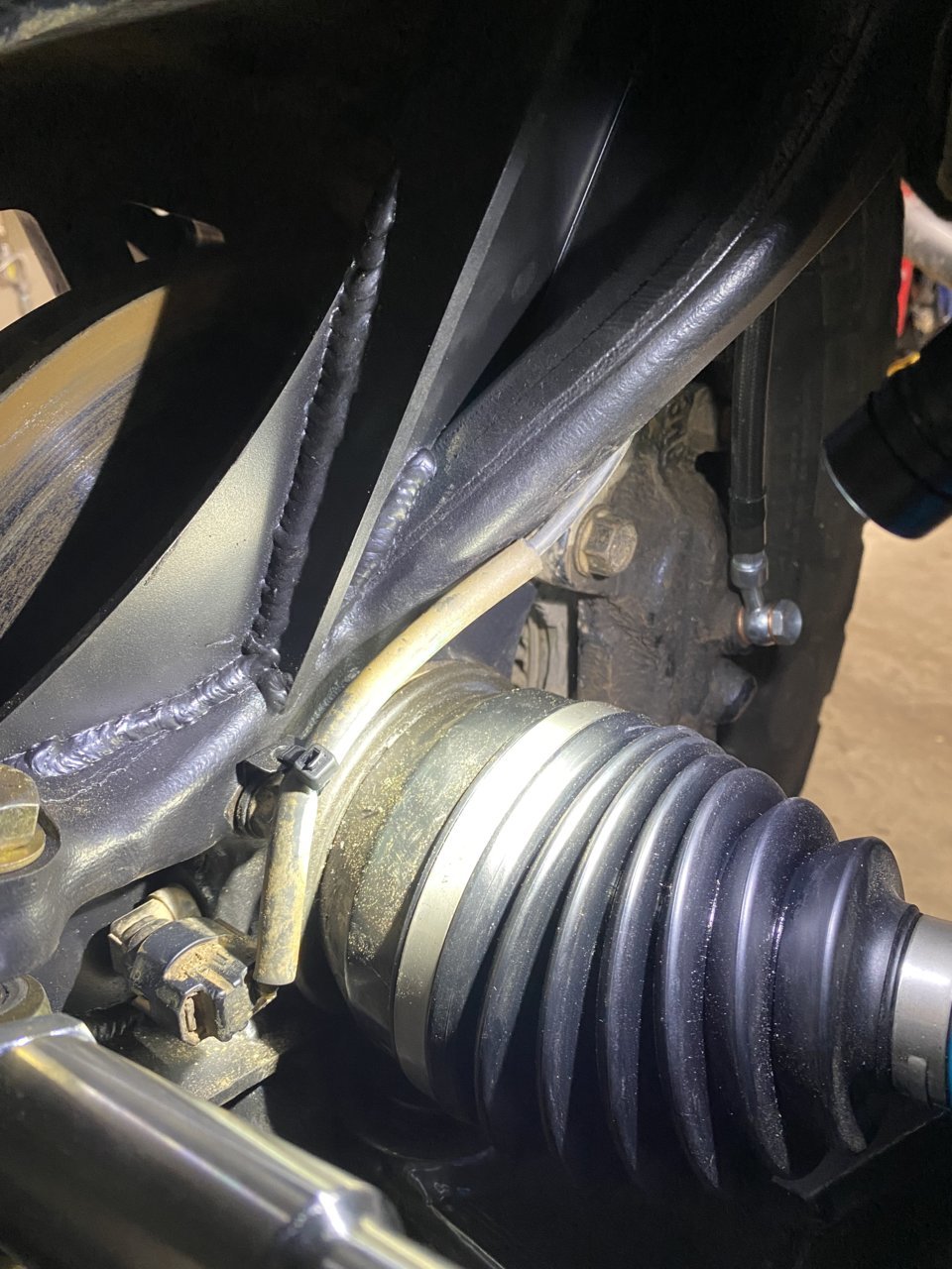

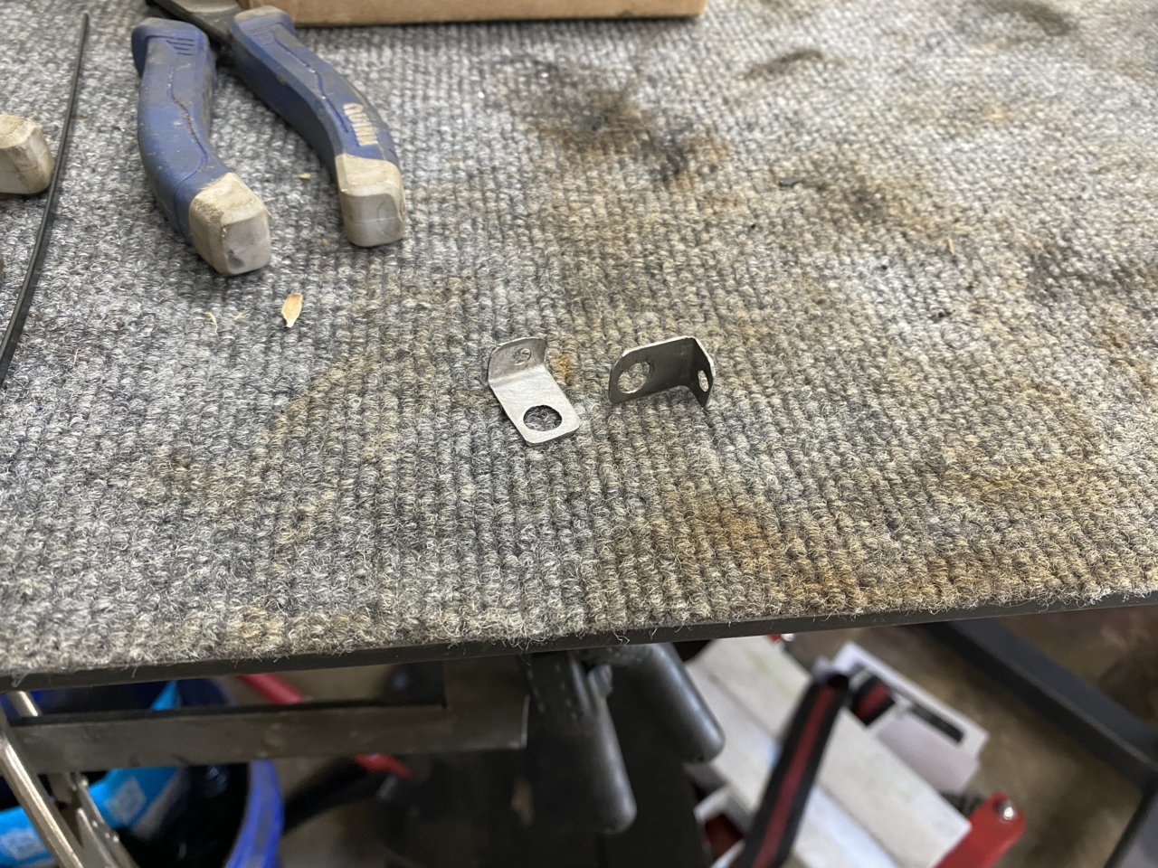

    So on your spindles, there’s a bracket that bolts above the CV to keep the abs wire off of the axle. On my old spindles, the bolt had broken off in the spindles so I welded the brackets on. Totally forgot about that so I wasn’t able to transfer them to the new spindles. My solution was to make a couple zip tie brackets and just zip tie the wire out of the way.
    All that’s left for Betty to be drivable is to bleed the brakes, which I’ll do later
