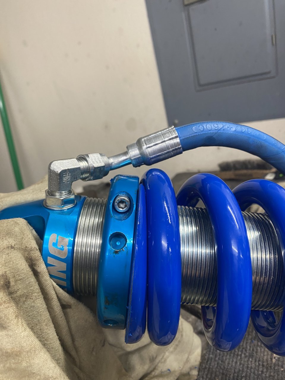

    Shoutout to @AccuTune Offroad and this tech article.
    https://accutuneoffroad.com/which-fitting-can-i-adjust/
    I swapped to the 600 lb coils today and wanted as little preload on them as I could get. This meant I had to adjust the JIC fitting on one of them to clock it outboard maybe 1/4”. Slowly loosened it while simultaneously turning the fitting and then quickly tightened it back up. No loss in pressure or oil.

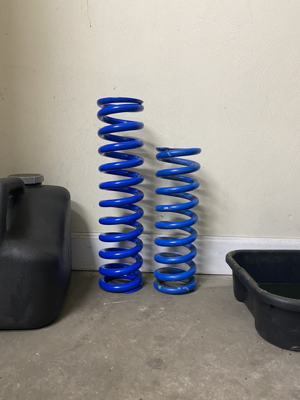

    As far as the new coils, my ride height didn’t change since I went from a 700 lb 16” to a 600 lb 18” long coil. I may drop spring rate even lower, down to 550 or 500. That’ll put me where I want ride height wise and articulate off-road even easier.

    Talking to myself in here. Went ahead and ordered some 18” x 500 lb coils from accutune. That should drop the front end down to where I was pre LT and articulate even easier.
