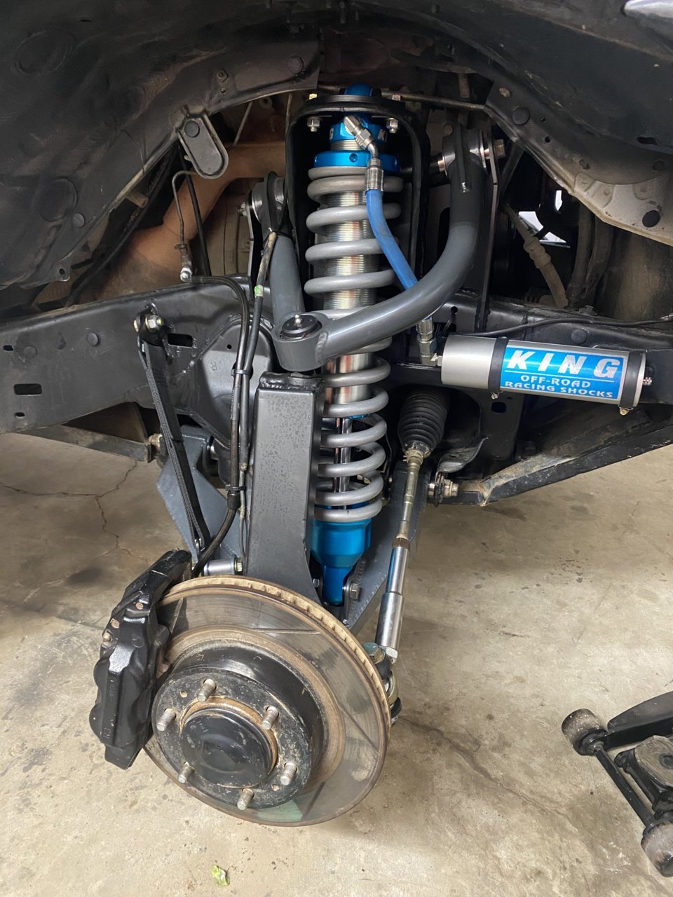

    Good news @EatSleepTacos. Accutune felt the fronts didn't need a rebuild.

  3. Jul 2, 2021 at 9:16 AM
    EatSleepTacos
    EatSleepTacos [OP] Well-Known Member
    Mar 24, 2015
    #151688
    59,828
    Randy
    West Valley, AZ
    2017 4Runner
    Really? That’s awesome and surprising considering I’m the second owner. There’s probably 40k-60k on there.
    My Name is Rahl likes this.
  4. Jul 2, 2021 at 9:24 AM
    EatSleepTacos
    Mar 24, 2015
    #151688
    59,828
    Randy
    West Valley, AZ
    2017 4Runner
    Third times a charm. Hopefully these 500 lb coils are what I like. So far, they seem perfect. Dropped the one side down 3/4” which should put me where I want to be.
    y=mx+b and Slashaar like this.

  11. Jul 2, 2021 at 10:08 AM
    EatSleepTacos
    Mar 24, 2015
    #151688
    59,828
    Randy
    West Valley, AZ
    2017 4Runner
    If you ever swap 18” coils onto 8” coilovers, one thing to be mindful of is coil block height. Coil block is when the coil is fully compressed and the rings are touching each other. For my specific coils, that’s 8.43” long per @AccuTune Offroad website.
    What that means is when your shock is fully compressed, your two coil seats must be further apart than the block height of your coil. It’s easy enough to check with a measuring tape. For me, this is as much preload as I can add to the shock, leaving me a whopping 0.13” cushion at full compression.
    To check on the workbench, you add the block height plus your shaft length. In this case, 8.43 + 7.5 = 15.93” minimum distance between coil seats. I’m at 16.06” as it sits right now.
  12. Jul 2, 2021 at 10:56 AM
    EatSleepTacos
    Mar 24, 2015
    #151688
    59,828
    Randy
    West Valley, AZ
    2017 4Runner
    Whew, these 500 lb coils are soft. I love it though. 550 probably would’ve been a better fit but I don’t want to swap on a 4th pair of coils.
    RobP62, 3pooches and LOLLY like this.

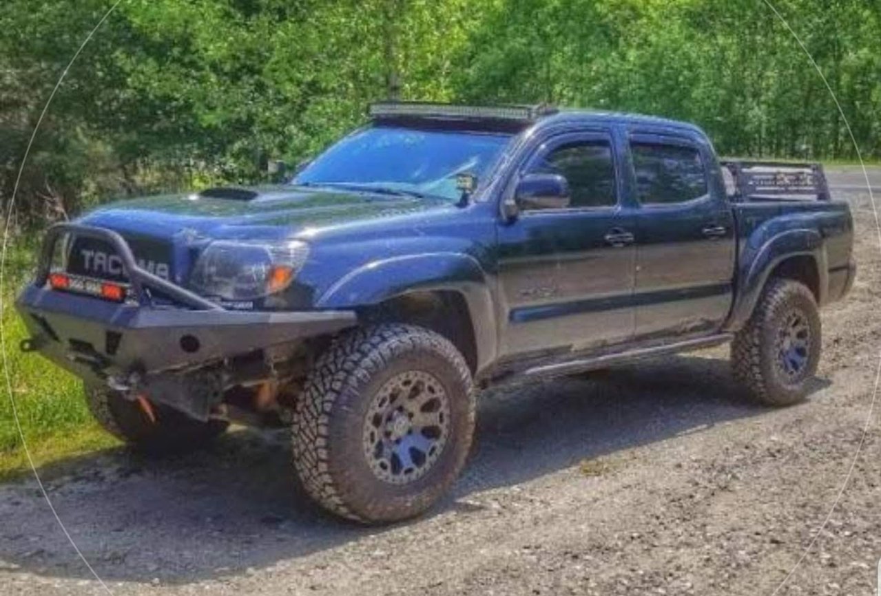

  13. Jul 2, 2021 at 11:18 AM
    Slow Internet
    Slow Internet 56k Modem FTW!
    Apr 27, 2017
    #217518
    6,708
    Slow...
    1992 Dial Up Modem...
    Wiper Blades
    What did you use to change them?? Pretty sure I am changing mine tomorrow
    RobP62 likes this.
  14. Jul 2, 2021 at 12:18 PM
    RobP62
    RobP62 NVR20LD
    Jun 4, 2017
    #220718
    41,519
    Rob
    Street, Md.
    TTC Member #0125
    Liar liar pants on fire
    3pooches likes this.
  15. Jul 2, 2021 at 12:28 PM
    Slow Internet
    Apr 27, 2017
    #217518
    6,708
    Slow...
    Wiper Blades
    Damn, that's the 2 year ago version...lol
    RobP62[QUOTED] likes this.
  16. Jul 2, 2021 at 12:31 PM
    RobP62
    RobP62 NVR20LD
    Jun 4, 2017
    #220718
    41,519
    Rob
    Street, Md.
    TTC Member #0125
    That's a lame ass front bumper if I ever saw one. I'll reserve this for the Weak Wednesday Wannabe posts.
    geekhouse23 likes this.
  17. Jul 2, 2021 at 1:31 PM
    Slow Internet
    Apr 27, 2017
    #217518
    6,708
    Slow...
    Wiper Blades
    I tend to agree with you on that... stock was way better. Think this one will go to goodwill
