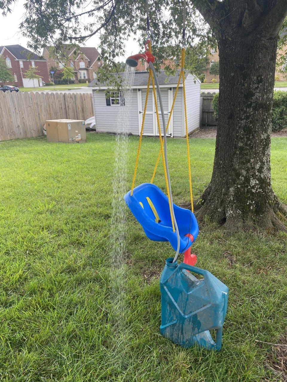

    And a seat for comfort!
    I hear kiddie pools are the way to go for camp showers.

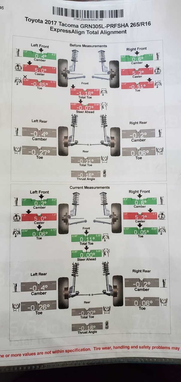

    Yeah SPCs and went to an alignment shop time before last in March after some mod work, which left me driving with the wheel clocked 35° to the side (can't recall if it was right or left this time'round).
    So I told the guy I wanted as much caster as was needed to clear the rear of the wheel well.
    So when Firestone got it up this morning, after doing both spindle swaps and coilovers removed and preload adjusted, the caster for both were nearly identical from the alignment shop printout: 20210312_155117.jpg

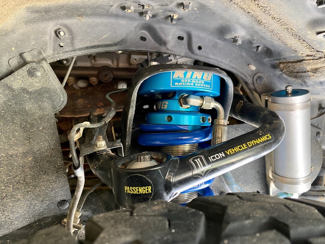

    valid point. We shall see how much different my truck sits on these springs by Sunday.
    How I’m rolling now.

    Are those 650?
    edit: never mind , 700
  19. Jul 16, 2021 at 3:07 PM
    BamaTaco56
    BamaTaco56 Well-Known Member
    Mar 25, 2017
    #214383
    10,283
    Trey
    14x700

    Too fast for my edit. I bet if you started at 1” preload passenger, 1.25” preload driver, it would put you ballpark back to where you are now, probably too high. But it’s much easier to take away preload with the coilover still on the truck vs add more.
