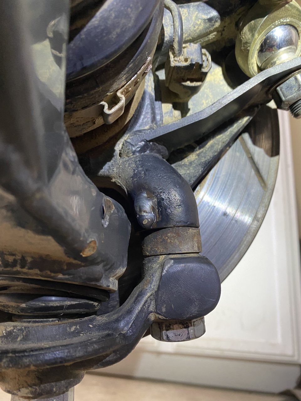

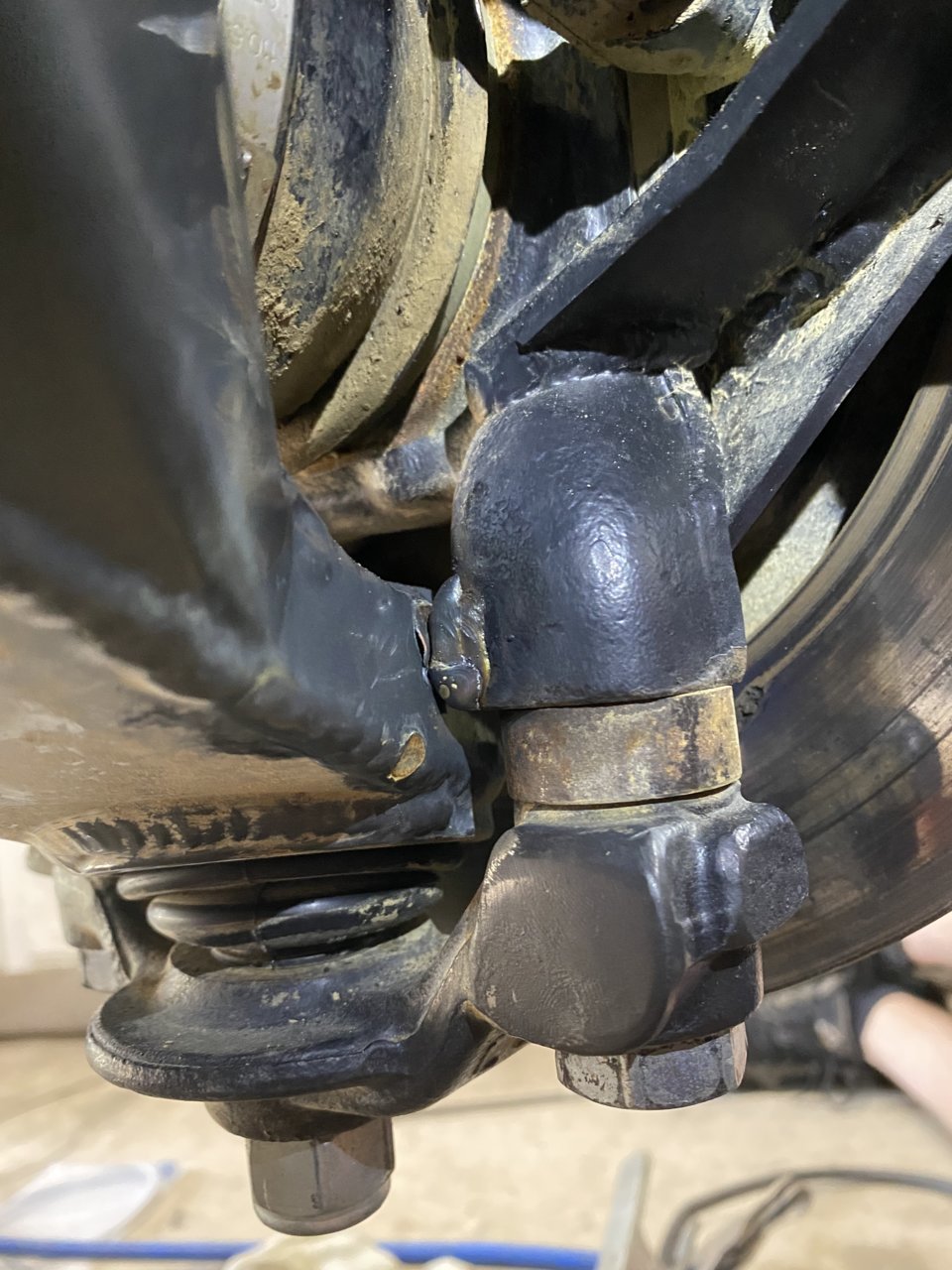

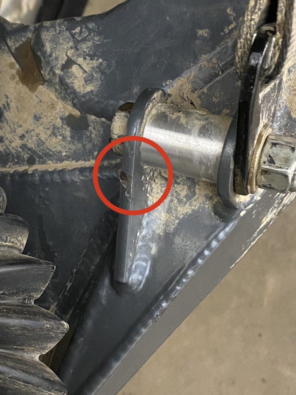

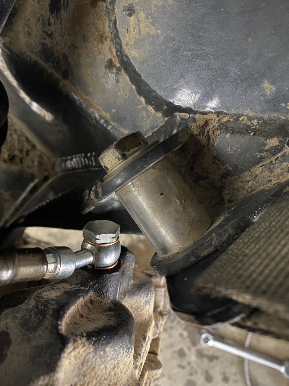

    So I fixed my brake line today and figured out the root of the problem. Banjo bolt was making contact with the secondary bypass mount at full droop/lock. Added some weld to the spindle to limit my steering and good to go. I shared that with JD Fab as a potential improvement for their kit.

    I managed to figure it out when I was taking out the AN to 10mm adapter at the caliper and that was bent too. At least that maintained a seal.

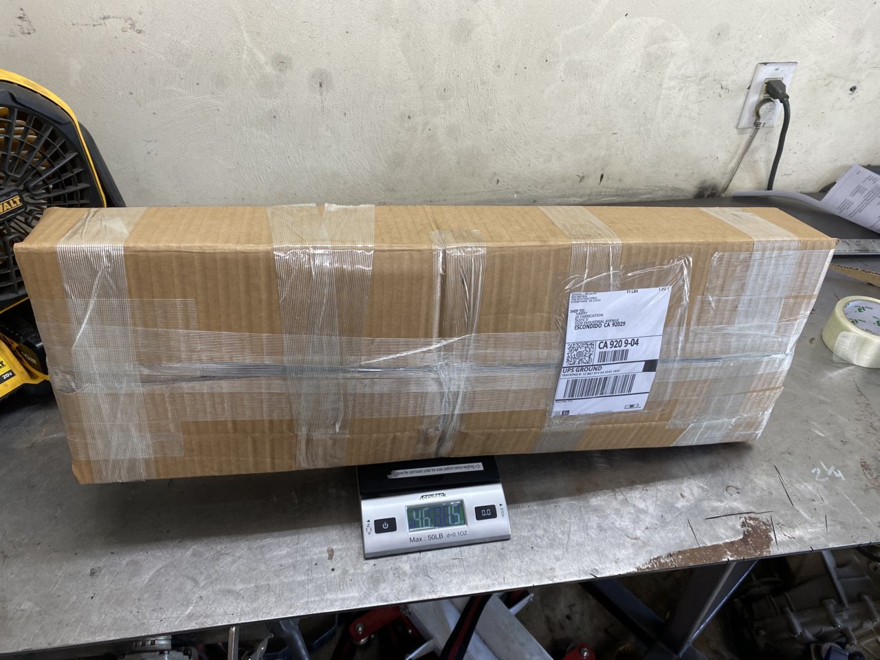

    Kinda random but I wanted to share a tip whenever you have to ship heavy truck parts. UPS has their own flat rate shipping that utilizes your own packaging and goes off of cubic inches with a 50 lb weight limit. It's nice because you're not limited to what you can shove into a USPS flate rate box, for example.
    If you repurpose boxes to make your own form-fitting box, you can save a ton of money. To send a pair of spindles to CA would have been about $80 but was $25 through UPS flat rate.
    Yesterday I made a box to fit two CV axles. Squeaked in at 47 lbs and barely within the size limits. It also cost me $25 to send to CA vs close to $100 if I did normal shipping.
