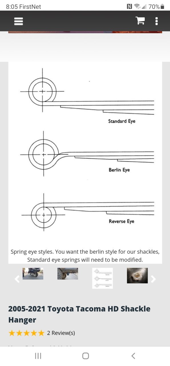

    Seems flawed when the majority of the aftermarket leafs for tacomas are berlin style. Dakars, Icon RXT, dobinsons, OEM.
    edit: I just noticed he said that's for their shackles, not hangers.

    I was just pointing out that OME are standard eye and that BAMF states upfront that the leaves need to be cut to run with their setup or that binding could happen like in that photo. @geekhouse23 is right they were designed to be run with deavers. Its not that there was not product testing like mentioned above. The issue with OME and needed modification to run them together is fully disclosed on their webpage and discussed in length in the BAMF hanger thread. The information to have avoided that issue in the photo was available.

    I’ve yet to see the leafs get wedged UNDER the hanger, have you? All the discussion I’ve seen regarding trimming Dakar’s has been in regards to the second leaf jamming the shackle, which is a Dakar issue, not a hanger or shackle issue.
    edit: and even in that screenshot posted, Jerry states trimming is necessary for their shackles, not hangers.

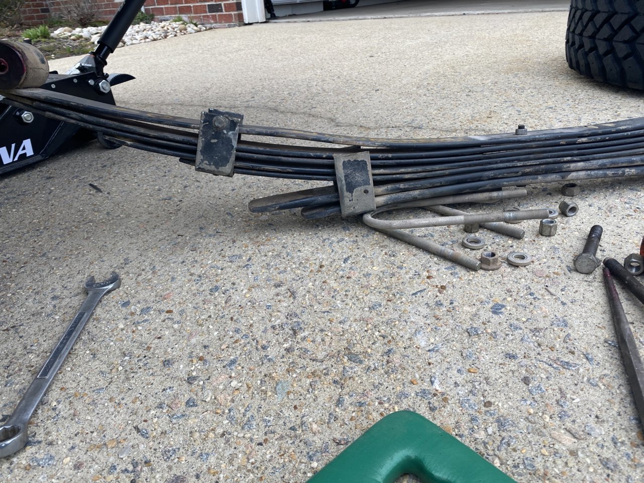

    And fuck these
    1730D161-CB08-4127-953E-1A9B0789ADF4.jpg D4AE4499-AE0B-42CB-85C3-A85FCE12C517.jpg

    True true, I'm glad they're getting another chance at a less abusive life.

    Wait....How old are they? That is a picture that can start it's own "Anti-Dakar" Thread.....

    Installed in 2013 and uninstalled and sold in late 2019/early 2020. They are 5 years old in that photo...
