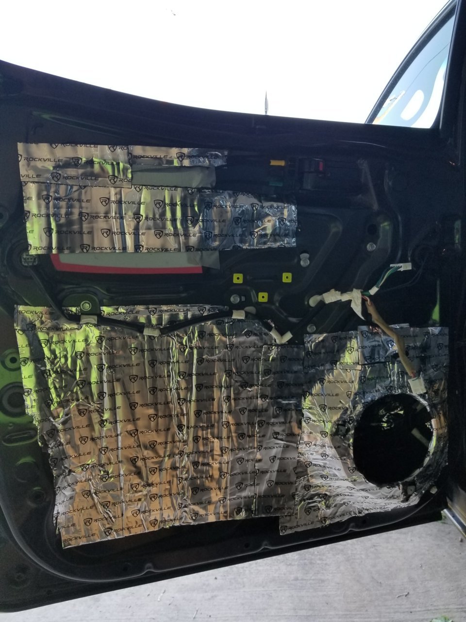

    Had a semi productive morning. I sound deadened both passenger doors, this is the only pic I took. I did the majority of it on the outboard most panel and for the inboard panel, I put most of the butyl on the back of it. I didn’t want any interference putting the door panel back on, that’s difficult enough as it is.

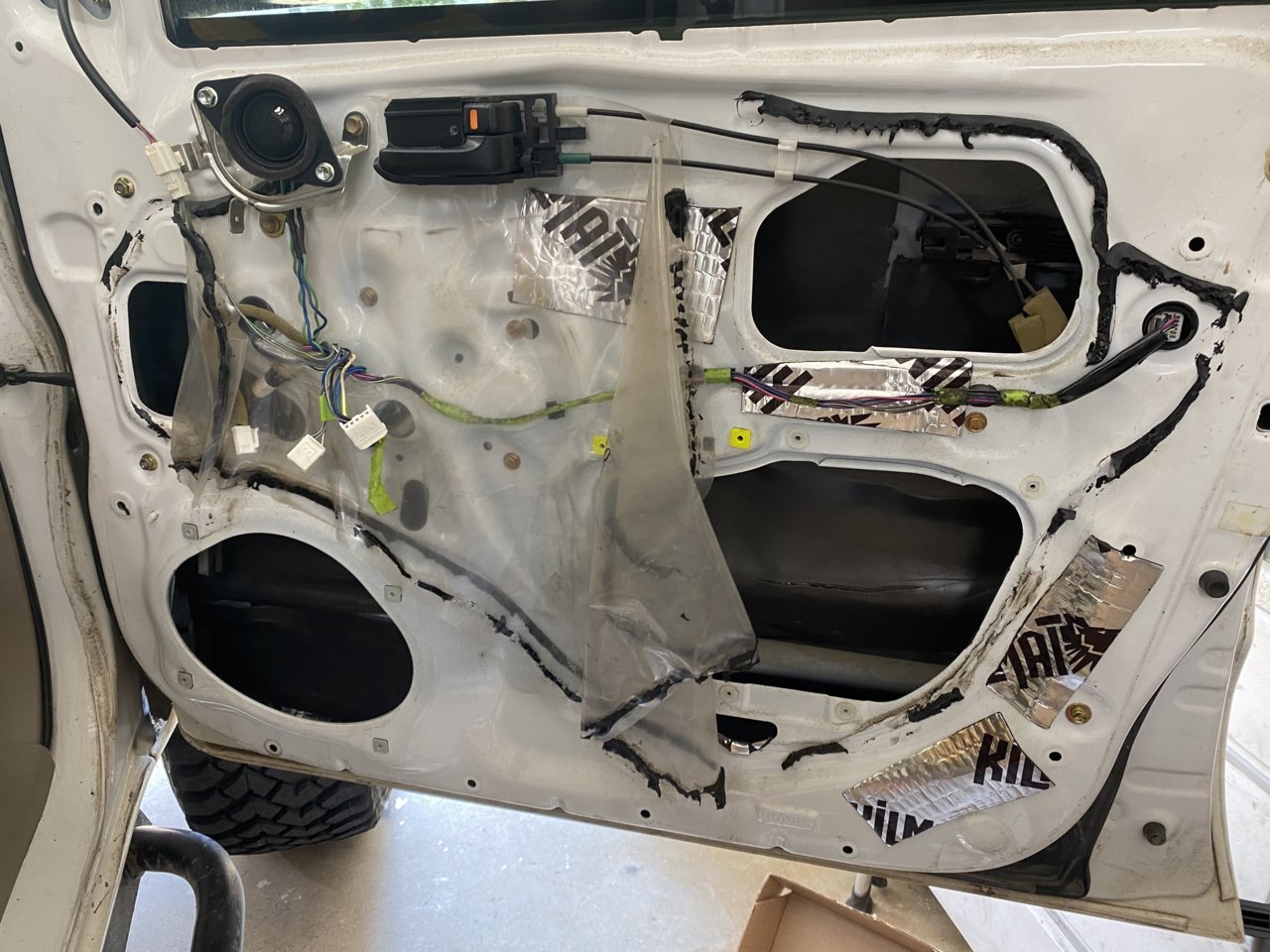

    I didn't hold back

    She was pretty proud of herself.

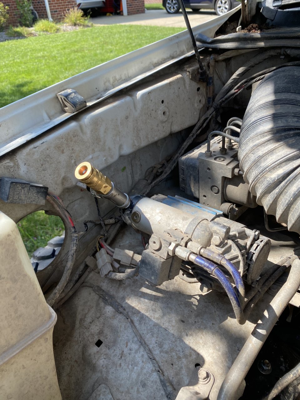

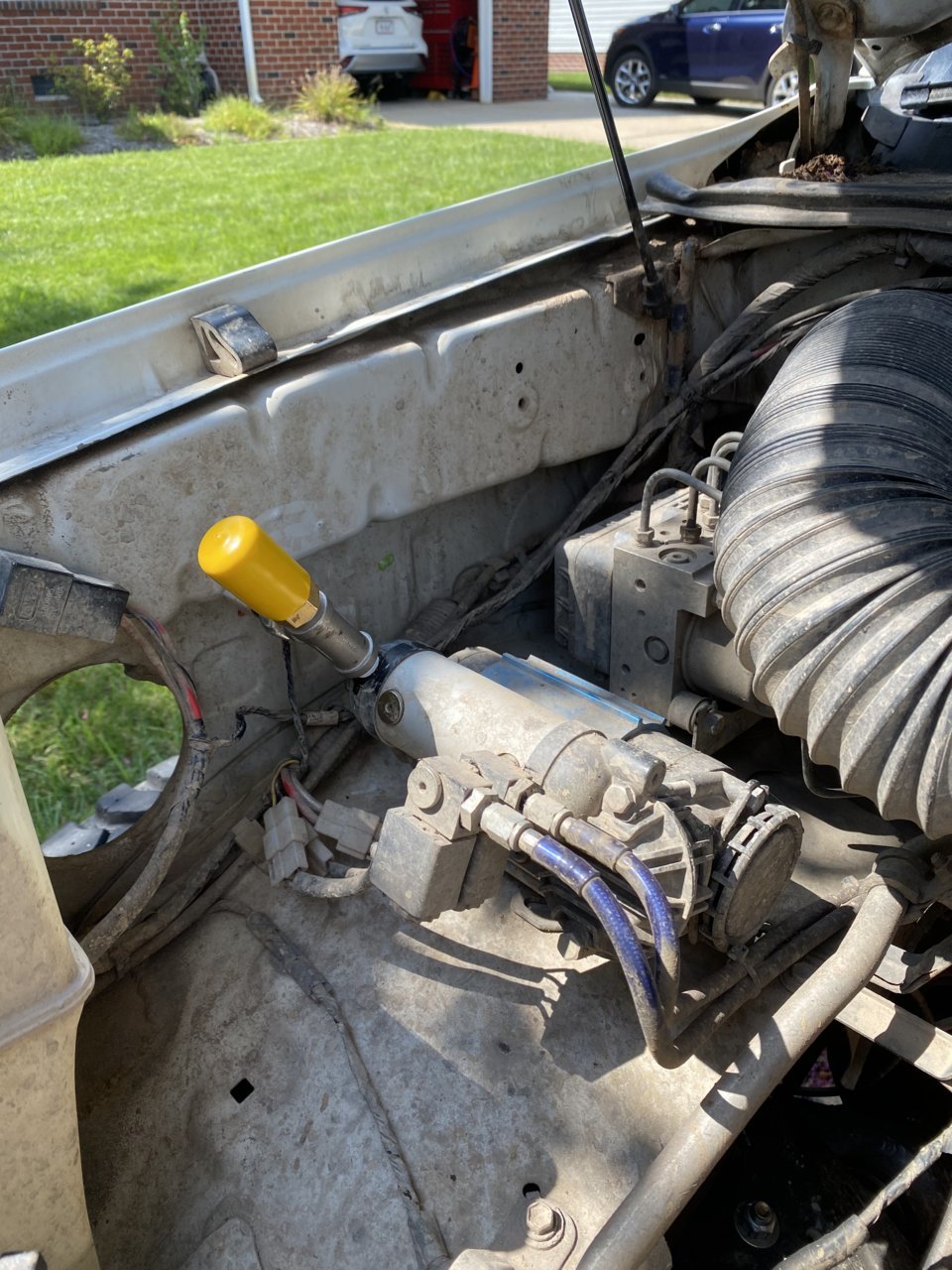

    I decided to continue this productivity and finally add a 1/4” npt tee on my compressor so I can actually use it as backup air now.

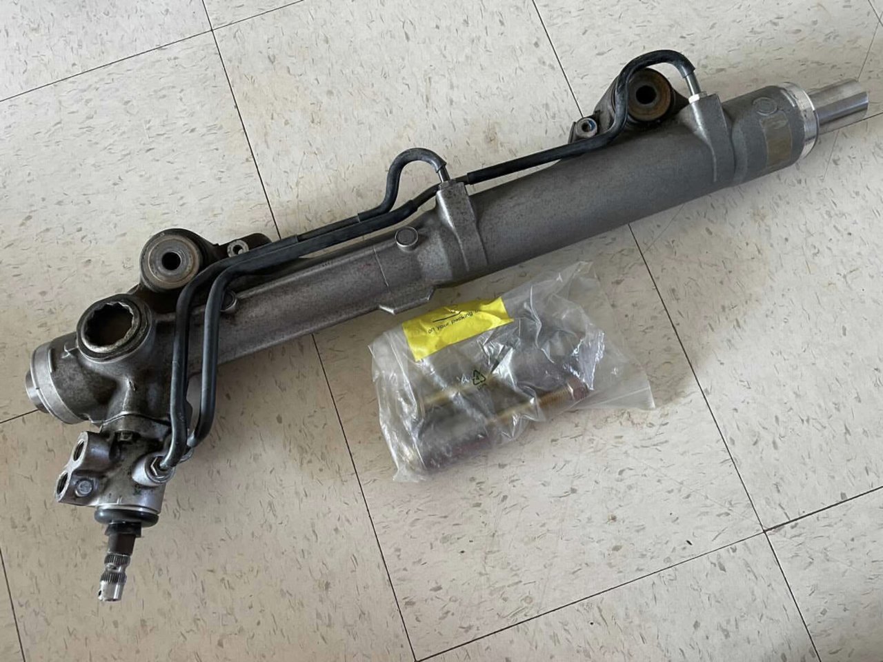

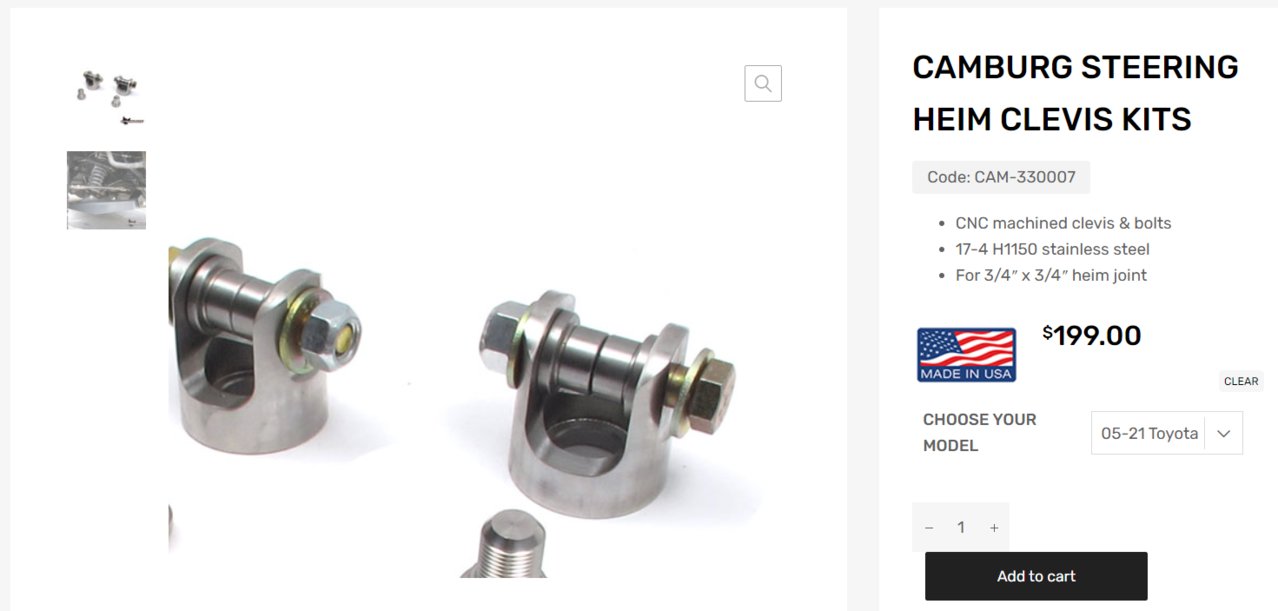

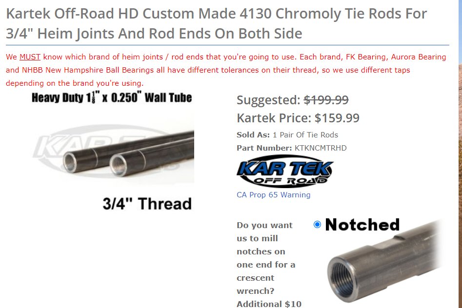

    Now that I'll have the tundra rack, my stock tie rods will be the weak point in the steering. To combat that, I'll add full heimed tie rods. Kartek offers them in any flavor so I can be out the door for less than $500.
    This is what's required for the inner portion, where they connect to the steering rack.

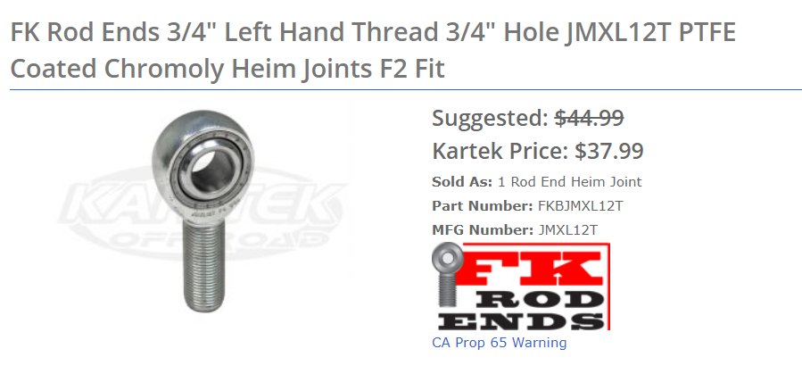

    The tie rods themselves. I will coat them in steel-it to prevent any rusting.
    And the inner heim. I already have outer heims, so that's taken care of.
