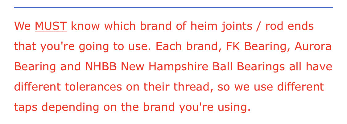

    Went ahead and bought the camburg inner clevis adapter. I decided I'll just run heimed tie rods right from the get go. That way I can sell off my OEM rack as one complete unit. Even though it's used, it's not leaking and works fine. OEM racks go for like $900 now, so I think I can swing $200 out of it. Maybe.

    So we have aurora or FK rod ends from JD? The thread doesn't show a clear answer..

    I've got fk Randy and others have aurora. Look up the PN on the rod end FK is marked FK on them also not just the part #

    Yeah what skip said. Just depends I guess. I have aurora and turns out those are twice as expensive as FK, so that’s cool. Kartek uses a specific tap depending on which brand so I’m going to ask if they can tap one side for aurora and one side for FK so I can save $90 on heims.
    edit: or tap both sides for FK and just swap out my aurora one for an FK. That way in the future they’re cheaper to replace.

    They may actually be turning the threads on a lathe and not using a tap they can get more consistency and accuracy of threads that way

    They specify tap. It’s interesting it makes that much of a difference.

    Ah cool. Yeah it does. Go take a continuing education night class in machining at your local CC if they're good they'll do a project that you make threads on and go over all the tolerances of threads and stuff. Aurora probably just holds a tighter tolerance QC than some of the others. Now FK last I looked has several different tiers of their joints so depends on what kind of crazy you want to do for expense
